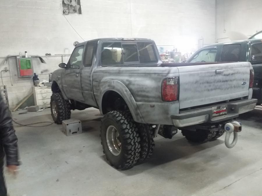

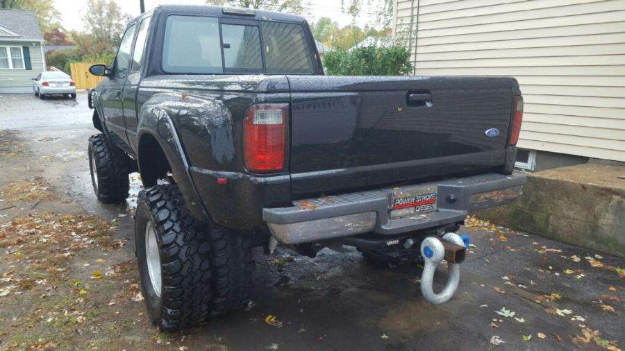

I finally got this project painted and took it down the road 6 long years but here it is. "Not in my driveway".

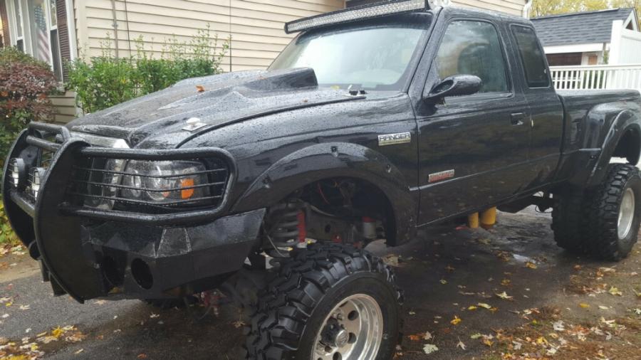

And heres the front.

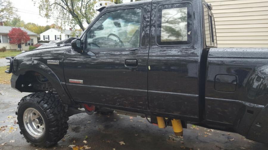

from a distance. it's got an awesome stance to it.

What front axle is that?

front axle
It's a dana 35 ttb with d44 ttb knuckles that I removed the caliper brackets and bolted on 3/4 ton chevy spindles and brakes and the rest.

Wow...looks like something out of a spaceship...do you have any shots from under the hood or is it classified???

I took a video of it running right after I got the motor back in it. It on youtube just search powerstroke ranger finally running. It shows the motor a little. But I do have to take some more pics of it complete.
