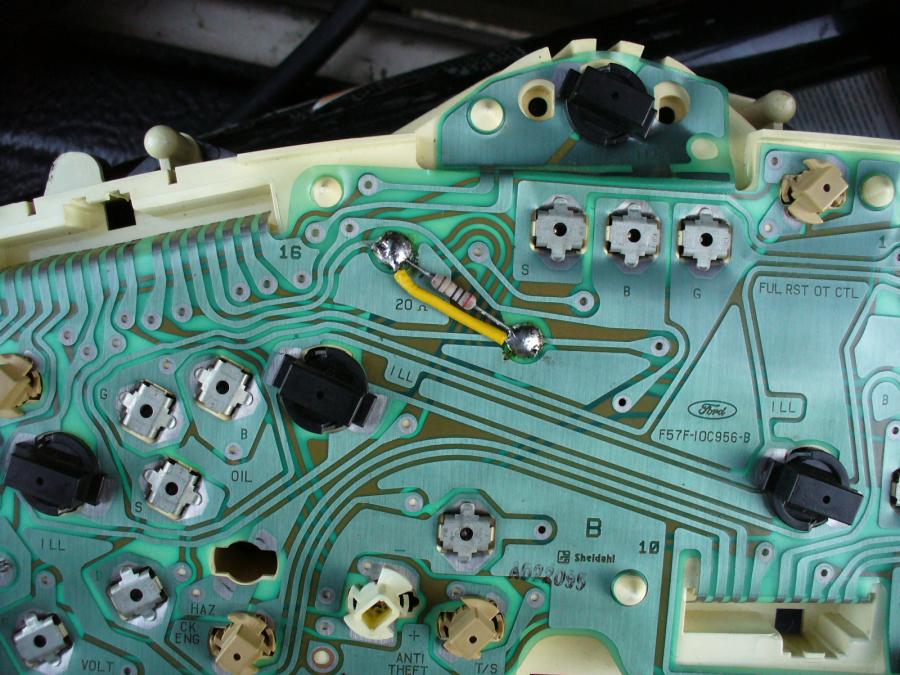

I did the sender mod on my 1995 with a 3.0 awhile back. The sender was $13 at rockauto (and that was a geniune motorcraft unit). A few tips and pics (Should I submit this with details as a tech article?):
-First, when you fit the sender, if you have an automatic, you'll need a 45 degree street elbow to clear the fill tube. The only place that sells them brick and mortar is Rural King (at least around here). You will also need to nudge the fill tube a bit to get the socket to fit when removing the old switch.
-There is a 20 ohm resistor on the back of the instrument cluster that will need to be shorted. I did this by soldering a wire to the resistor's crimped pads; however, IIRC, there also are some bare pads (test points?) nearby that can also be solder bridged.
The only issue I've found is that my needle randomly bounces a lot... although that could be my motor having an issue (which has 130K and I have evidence that it was formally abused- lack of oil changes).

Very nice pictures, yes I would like to see this added to Tech Article Section :)
The PS60 sender, like the switch, uses the engine block as it's ground, so you need to make sure to leave a few threads of bare metal on the elbow, adapter and sender to get a stable ground.
If using tape or liquid sealer leave lower threads bare.

Another tip: to turn in the street elbow with the engine still in the truck, the only thing that worked was a 1/2" drive king gator grip socket.
I've found that the teflon tape isn't an issue. The thread edges cut it when tight (as the tape doesn't seal, it just reduces friction to allow for a suffiently tight fit of the tapered threads or so I'm told). The sensors have the teflon from the factory anyway, so the only tape needed is for the street elbow.
I'll work on a tech article submission. There's a few pics I'll want to shoot first... luckily I still have the old switch and the box to the new one.
