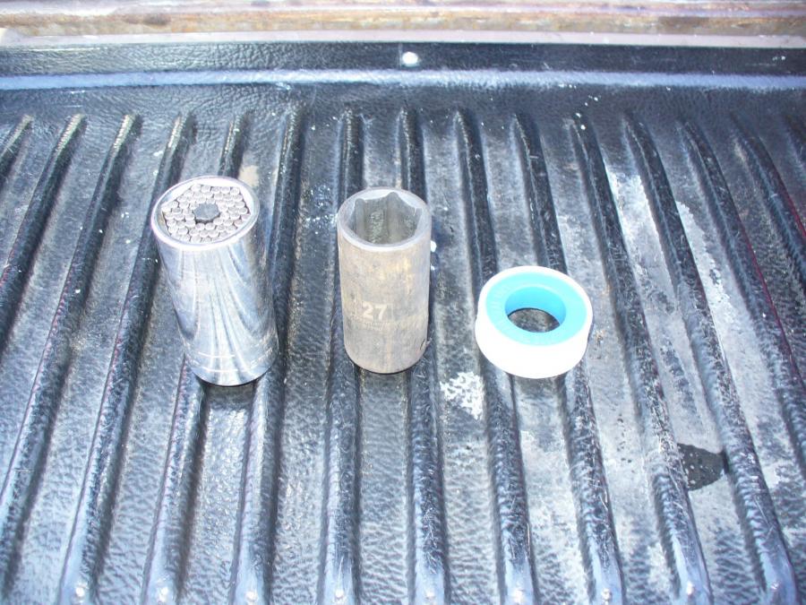

Tools Needed:
- Whatever tools are needed to remove your instrument cluster (1995+ uses 7mm and 8mm sockets/nut drivers)
- Soldering iron and supplies (solder, etc.)
- Wire stripper/cutter and scrap wire (about 20 gauge will do, stranded preferred).
- Wire crimper
- 1 1/6" /27mm deep socket Socket (Or large vice grips, as I found out this time)
- 9/16" open ended wrench
- 3/4 or 19mm socket or wrench

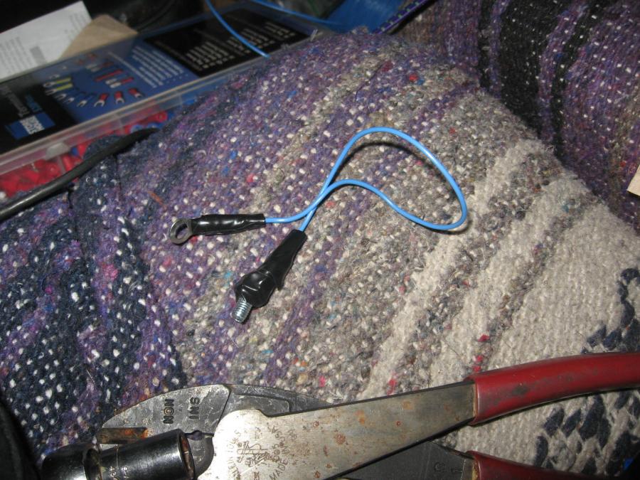

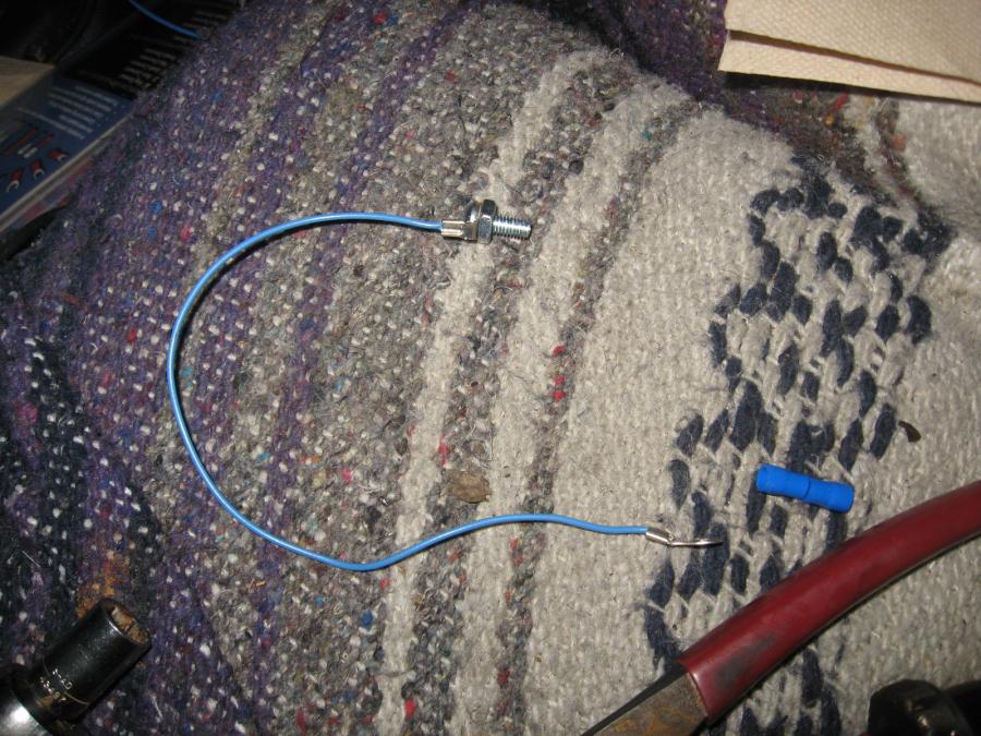

Step 4: One issue that will come up later is that the oil pressure switch wire won't be long enough. To fix this, make an extension by crimping two #10 ring terminals to about 4" of wire. Add a 10-32 screw, lockwashers (optional) and nut to it:
Note- I made mine extra long as I didn't know for sure how much I needed at the time
Be sure to insulate it with some electrical tape or heat shrink
Note- Heat shrink is a lot better. I'd have done it that way myself but my heat gun and heat shrink bag went missing at the time of this mod
Step 5: Attach the end of the extension wire w/o a screw to the end of the new oil pressure sensor with a 10-32 nut and (optional) lockwashers.

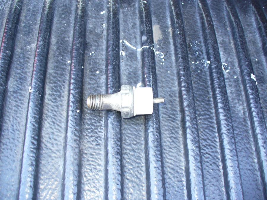

Step 8: Remove the old pressure switch (not the long 45 degree fitting) using either a 1 1/16" deep socket or a pair of large vice grips.
Step 9: The current orientation will not work as the larger new sensor will hit the steering box. Using a 3/4" or 19mm socket/wrench, rotate the 45 degree fitting about 270 degrees clockwise, so the female threads point down, parallel to the steering box's input shaft (see next step for photo of orientation)
