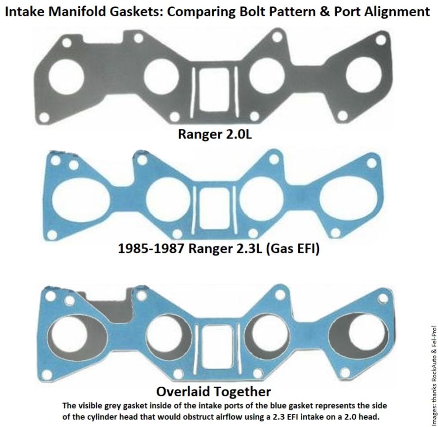

  • Comparing gasket photos, the intake manifold bolt pattern may be the same between 2.0 and 2.3, assuming the 2.0 one is pictured upside down.
  • Comparing gasket photos, the intake ports appear to line up more or less (aside from the size difference).

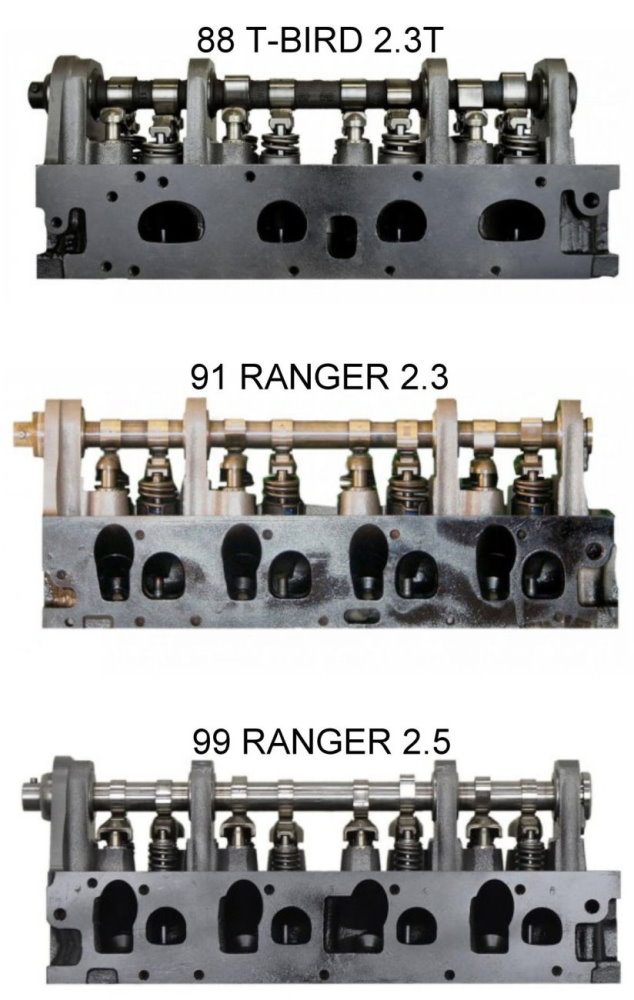

On one head I was able to do a bit of the porting that everyone said was important to proper flow and I saw that the intake on the carbed version was a very inefficient method of fuel delivery...the fuel injection would spray the fuel into that opening and then taken in by the opening valves so as long as it is atomized by the injector I'd imagine where it is spraying is less critical...other than it pooling after hitting something like the side of the opening...timing would be more critical so that the spray doesn't have time to actually pool.
But the angle of those injectors should give it a clear shot at the intake valve or you might be able to skim away a bit of the material to make it more direct...it's been so long since I even looked at a head that I don't remember at all...but I recently acquired some images of the heads from another member...I will post a link below to his thread...might help you see something worth noting...
http://www.therangerstation.com/forums/attachment.php?attachmentid=23056&d=1515437198
That is a shot of the intake side of three different heads...you can see approximately how they line up with the intake opening but not much else...
That is pretty helpful. If we compare that with this image (link) of three different "2.3" heads, the middle of which is a round-port carb head which should have identical ports to a 2.0 head, we can see with certainty that the EFI manifold will bolt to the carb head. You said this above, but I still needed a visual to help...uh...visualize it.

Looking at gaskets (RockAuto is great for this, but I'm seeing catalog errors mixing in Tempo OHV 2.3 stuff...grr), 85 86 and 87 are the only three years that use the intake that will directly bolt up.
My concern re: injector aim is that the round ports are a good bit smaller than the ports on EFI heads. If the injector is too far offset from the centre of the port on the head, or in the case of the front and rearmost ports maybe totally misaligned with the 2.0 port...I don't see any way that they could be ported out to work without extensive work (and certainly not without removing the head from the vehicle).
Check out the attachment I cooked up. It perfectly illustrates my concerns about the port misalignment.
So it's pretty clear the manifold will bolt up (with the possible exception of the top leftmost bolt?) and the ports will align so that the 2.0 ports are not restricted any more than they normally are. But that doesn't look like very good airflow at all, to me. And lots of opportunity to fuel to pool up in bad ways, possibly.

I had to save and manipulate the gasket images a fair bit. They're all pictured "upside down" and "flipped" different ways from each other, so after correcting them to all face the same direction as the pattern on the head, I blew them up bigger (why it's so pixelated), then used GIMP to delete out transparent sections inside the intake ports and bolt holes on the one gasket and lay it on top of the other one. If RockAuto offered a tool to do that automatically, that'd be awesome...but it's such a specialized need that I think doing it by hand is the best we have :)
I agree, matching the head to the intake is a guaranteed way to get a matched result that flows properly without these questions that I have. I dunno, maybe grabbing a whole head wouldn't be such a bad thing. But it really does seem like that's not worth the effort compared to doing the whole engine.
My tank was new in 2015, so I'm definitely not ready to scrap that yet. Hence matching the fuel sender to the tank. Otherwise I'd definitely go for a plastic tank. I believe all the years that use this tank use a 2-pump system, but my plan is to just put a normal high pressure pump in the tank. Just need something to hang it off, and a return line fitting, so junkyard sending unit should do the job.
My (limited) understanding of how air flows in an engine is that the airflow should be OK through the 2.3 intake into the 2.0 head. It should flow enough to run reasonably, maybe a little lower on power than a perfect running 2.0 would be to begin with though. The issue is largely about where the injector is, and where it's pointing. Fortunately, the top side of the ports all line up fairly well, but it's still something to verify before I go buying parts for a ridiculous project like this.

The more I try to figure out this port shape thing, the less I think I know anymore. It seems as though the truck 2.3 used the large D-shaped ports, rather than the large oval ports? Or am I getting something wrong there?
The large D-ports are closer to the same size as the round ports, on account of the bottom being cut off of all of them. A D-port intake would probably mate up better with the round-port head, if only slightly.
OTOH - if the intakes used on the D-port heads still had full size oval-shape runner ports...then that is good news for mating an oval port intake to a round port head, because it would have the same "shelf" at the bottom of the port. Just more of it, but still not a smooth passage.
