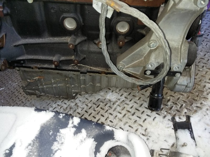

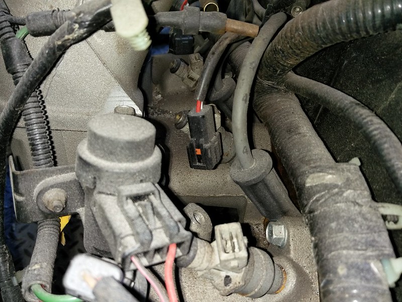

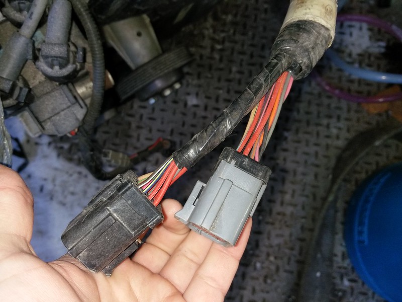

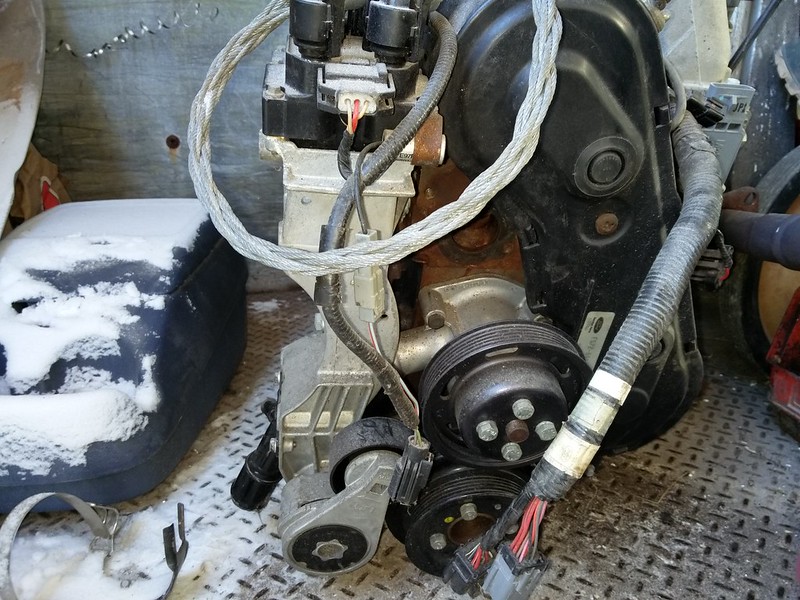

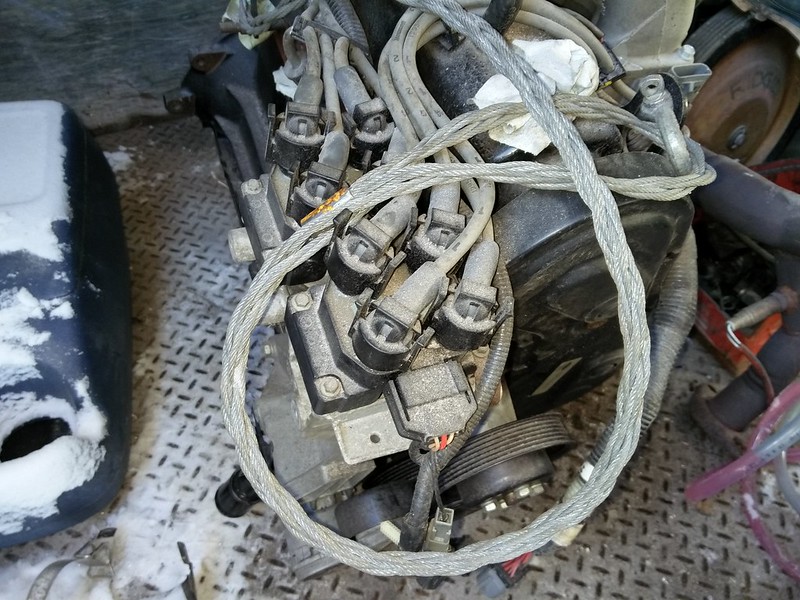

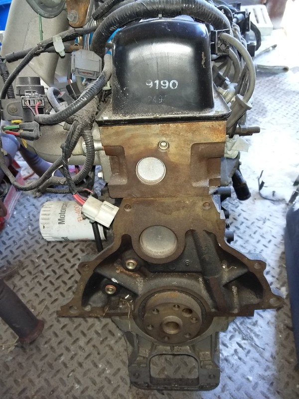

Please take a look at the following photos, and let me know what you think I will need to add to this engine and harness to get a usable result. My exhaust manifold in the truck currently has an O2 spot already, so I'm hoping to use the existing manifold. My 2.0 has a brand new clutch and flywheel on it, so those will be transferred onto this engine, and I will reuse my starter (although I want to upgrade to a PMGR one off a newer year eventually).
Does this harness look like it can plug into the body harness of a 93-94 as-is? Specifically thinking about the grey and black rectangular connectors.

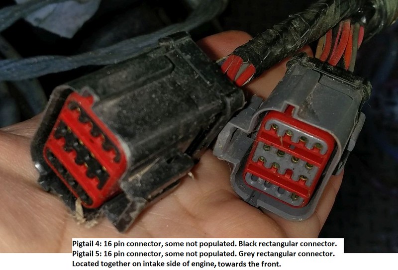

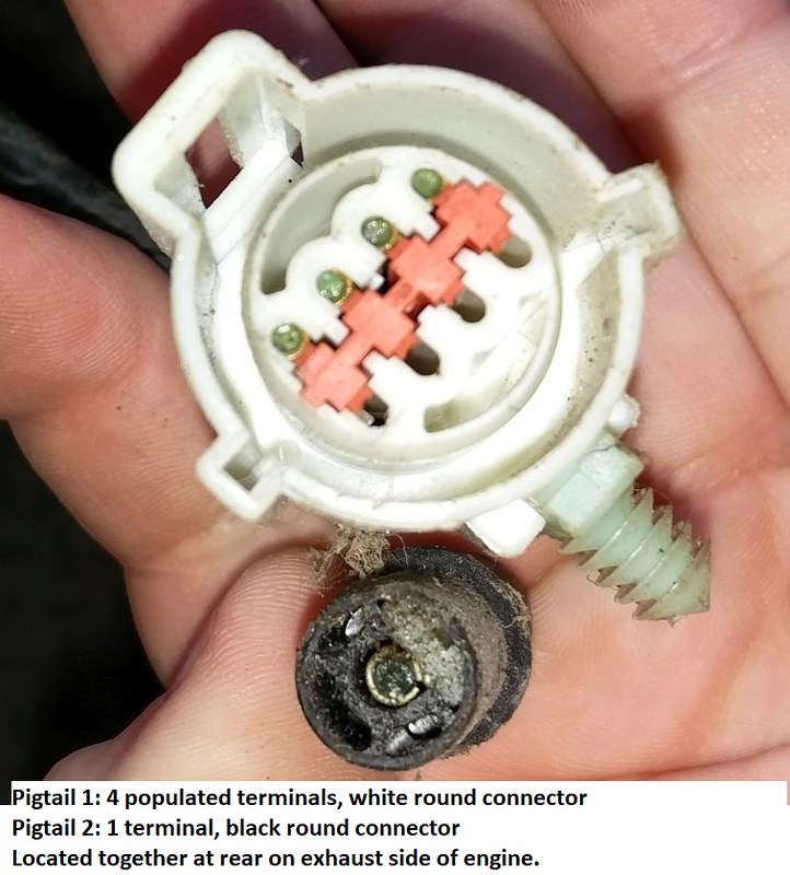

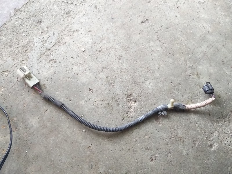

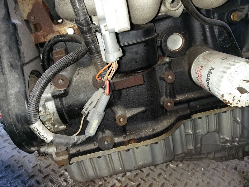

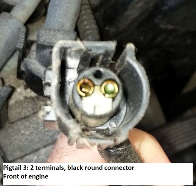

I have numbered the harness connections in a couple images. I suspect that #1 is the oxygen sensor (HEGO has 4 wires), #2 may be a ground, #3 is the ECT which mounts in a heater hose, and 4/5 are obviously the connections into the body harness which then find their way over to the ECM. Any corrections?

If all else fails...and nobody who knows what those connectors are connected to...you can try the Connector Catalogue...it does require searching on the part number so maybe more work than usual...

Findings:
The O2 wiring branches off from the body harness and runs under the engine to the O2. I got this wiring today.
Therefore, pigtail 1, as I numbered it, is definitely not for the O2. The 93 truck in the junkyard had this connector as well, positioned in the same spot. I really should have followed it back, but I was distracted by the gasoline shower I had just given myself and forgot. Oops.
I will want to verify there were no year-by-year changes to the pinouts of pigtails 4 and 5. If they did not change ever in the lifetime of those connectors, the engine would be plug-n-play with the harness I grabbed. If it did change, it's super easy to repin them, so all I need is a pinout.
I noticed the lower rad hose fitting is quite different, there's an extension on the engine in the OP which doesn't seem to exist on an installed engine. Shouldn't be a big deal to work around.
I'm going to throw the guy an offer on the engine and see what happens. I am concerned about how long it has sat without running (cylinder wall rust?), but I do think it's the best option I'll find for a complete engine. Plus the benefit of not having to pull it out of an existing truck is a huge bonus. And little big things like the fact the junkyard punctures the oil pans, so I'd have to find one of those intact.

There may or may not be cylinder wall rust and it is something you will want to check. Easiest way I know is to scope down through the plug holes...but before you do anything I'd squirt some oil down and slowly hand crank the engine...or flip it over and remove the oil pan to get a better look. Unless you have another plan...
My 2.3 short block came from an 87 Ranger that had been sitting for a few years and there was no rust inside the cylinders...just a crust formed at the top of each cylinder. The engine was sealed (plugs and heads left in) and I swapped the head on myself so I was able to inspect it.
Depending on the year you pulled it from...the starter circuit and power distribution box may be opposite of the earlier config. The Battery was on the passenger side of my 88 but the 96 had the solenoid on the driver side. I was debating whether to move the battery or the starter circuit and what I ended up doing was leaving the battery on the passenger side and running the power feed from the ignition to the solenoid over to the passenger fender and adapting a wire harness for the starter circuit.
It required cutting the starter ground wire off the block on the driver side and connecting it to the block on the passenger side but that was just a simple reroute...you might want to check that out and plan on moving things around if needed.
I might have some pics of my engine bay posted already...but if you need to see that let me know...I know they are not very clear but might help.
Scope down a plug hole, and turn it by hand with some oil in it is the intent. I've made the guy an offer and if he accepts or counters close to it, I will bring the scope to look inside when I go to get it (he will know this). If there's anything significant, price goes down. Thing is, even if it knocks a bit of life off the rings, if it's still a very low running hours engine, it should outlast the truck regardless.

Also figured out what "pigtail 1" goes to: a very short little sub-harness that has 4 wires, but two of the pins just loop back to each other, and the other two go to a switch below the shifter. I'm thinking reverse lights probably. Since the wiring for my body lighting is staying exactly the way it is now, I shouldn't need to mess with any of that stuff.
This means that as of now, I have 100% (perhaps like 150%) of the wiring needed for the EFI swap, regardless of what specific 2.3 goes into it. Just need to take the harnesses apart, remove extra wires, clean it all up, and figure out how the routing is going to go. I'll be starting on that once the EVTM is in my hands. Not sure where the EEC-IV is going to live, I think 85 has the hole for it in the firewall, just not sure exactly. It'll all come together in time. Need to remember to grab some ground straps, and my truck could also use new starter wiring, but the latter isn't a swap issue.

The middle image is the same connector on the junkyard truck as is "pigtail 1" in my original photos of the engine I offered to buy. 8 position, 4 populated contacts, connects to the tiny harness section shown in the third picture which goes to a switch on the side of the trans.
The wiper connector is indeed a round connector. It's on the body harness I have, and will be eliminated from the picture as well. The harness I'm modifying will be strictly engine function and therefore self-contained except for grounds and 12V inputs (battery positive, and ignition switch trigger wires from inside, which should already exist under my hood, though I'll have to mess with the wiring to get the intended result).
