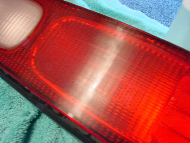

First off, you want to start by cleaning the lighting surface and inspecting it for damage. In the spray bottle, put 1oz of car wash and the rest water (low pressure), then tighten the bottle and shake up to mix. I used this mixture along with a microfiber towel to clean the surface. The best way to check for damage is to hold the surface into a bright light allowing the sourced lighting to reflect off what you are working with, in this case a tail light. This amplifies imperfections, and in this case, swirls were the main problem. However, there were a couple scratches in which I eventually removed.
Notice the haze over the suface...They are actually swirls

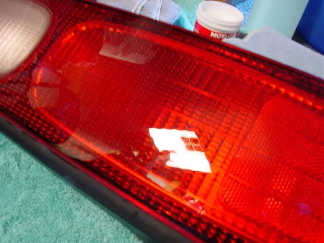

After you inspect, you could do 1 of 2 things. If your surface is pretty much flawless, I’d go straight to the polishing step, but since I had a couple scratches, the next step was to wetsand the lights down to level the surface. I took a sheet of 1500 grit wet-sanding paper and soaked it in a bucket with 1 gal water:1 oz car wash for 20 minutes. Next, I cut to fit the paper and mounted it on the sanding block. I then sprayed the taillight generously with the soap:water mixture to lubricate and began wet sanding. I went side to side which I found easiest using medium presure. DO NOT DO IT IN CIRCLES or PUSH HARD. I sanded for about 20 seconds each section (see pic) to level out the surface. I then sprayed down the light and wiped clean with my microfiber to inspect for a level surface. After inspecting, I finished up the remaining areas and went to the polishing stage.

Left is untouched, Right is after this full process
High Gloss and Defect Free!
