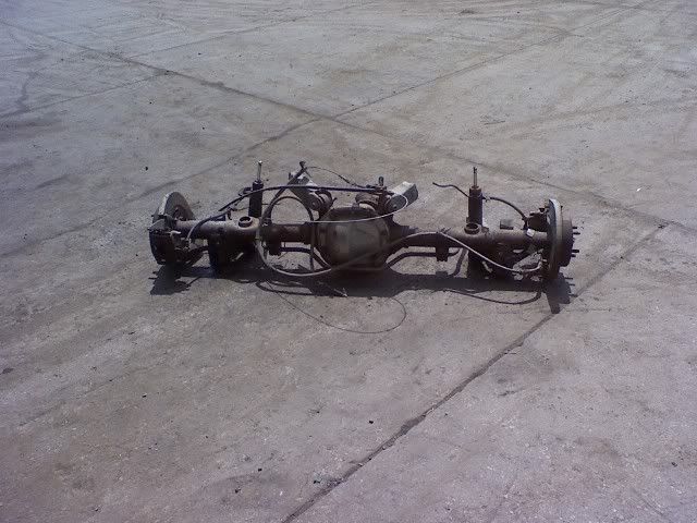

heres my "cheap junk yard" disk conversion
first i found a rear axle out of a 95 crown vic.

next tear it down to get the caliper brackets off the axle flanges.

this is where it gets tricky
the bolt pattern of the brackets is a tad different then the small bearing ranger axle so some grinding and welding was needed. seems the newer 28 spline small bearing crown vic axles have the matching bolt pattern, i got this 1995 axle for 100 bucks.

finished product. i welded the four corners. i dont care if its permanent.

i have been driving on this for about 6 months, zero problems and it no longer grabs and or feels like the rear axle is coming out when i first use the brakes after it rains or sits overnight.
