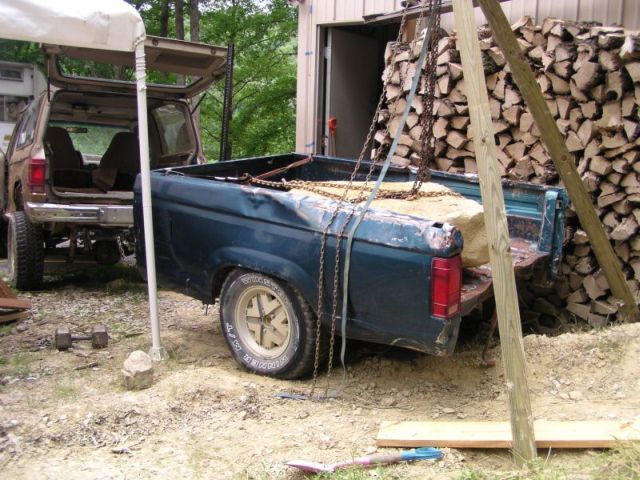

Finally got around to moving a rock I dug out of my excavation--we're improving our camp with bigger rocks as I get around to them. After I burst 2 hoses on my Bobcat trying to lift it, I decided to do it the old fashioned pyramids building way. Except I don't think they had a chainfall.

This rock is about 16" x 42" x 26" if you judge the median in each dimension. It works out to 1,600#. It was a hell of a load pulling it up my hill. When I hit the steepest part the front of the truck came WAY up and I was afraid to let off for fear of stopping forward progress. It was up for 50 feet or so until I went over the top and could let off a bit.:bad:
I still have Coffin Rock to move. It's medians out to 10x19x57 so it's about 1,000# exactly. My loader can pick it up so I don't get to assemble to gin pole. I have a dozen or so 200-500#ers which I can just put in the back of the B2 a couple at a time.

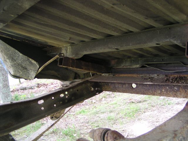

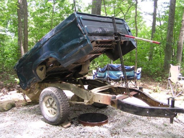

that a nice tilt box you built there. What are you using for a hinge.
Pins from the tractor supply. Black water pipe that fit them snuggly. I welded a 4" angle onto the rear of the frame. Then made a frame for the bed. It's endured tons of abuse. As is evident from the less than pristeen condition of the body. It will dump 5,000# of wet clay with the 60" Highlift. Very nice not to have to shovel it out. The only thing I would change is to put real trailer springs on the axle. The Ranger springs are way too soft for a trailer. It starts way high up and then is down on the bumpstops by the time you get about 2,000# in it. That's a big load for a Ranger, but nothing for a Ranger trailer.

he picked it up with a single string of chain. All that has to break there is 1/2 a chain link. Those hinges are stronger than that. I'm impressed with what sort of condition the bottom of the bed is in!

You could put at least 2 more rocks of that size in there. The leaf springs are not overloaded at all! haha jokingly.
The dump bed caught me by surprise. Not worried about the Hi-lift from slipping?

I built this trailer to excavate the foundation for my barn--and I've haued a million pounds of wet clay (I calculated that) and it's never failed to serve. That's 231 loads. When the clay is really wet I had to use all of my weight to get the Highlift up the first 15 strokes until the the load shifted back far enough to let up. But clay doubles its weight when wet so a full load of regular soil is no problem.

I really cant believe those pins and welds stood up to that rock. But then again, the pics prolly don't do them justice.
Those are 1" pins. The welds are pretty ugly but that pipe just disappears when you put very much heat on it, which makes it a little tough to weld to 1/4" steel down in the groove there. It's far from weak though.
As far as the Hi-Lift. It is connected to the trailer on both ends with pins. It's part of the trailer.
