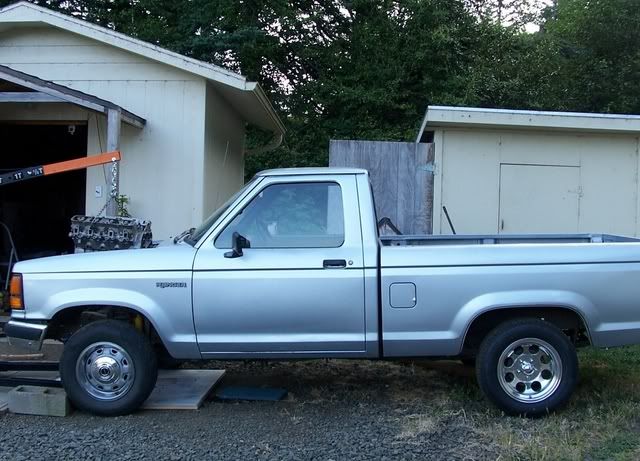

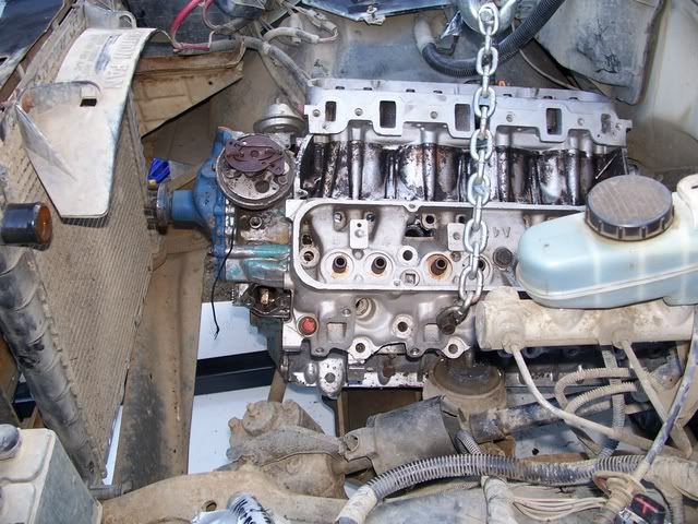

I got started on Project Silver Bullet today.
Here's a few pics as promised...
Goodbye 2.3 4 cylinder...

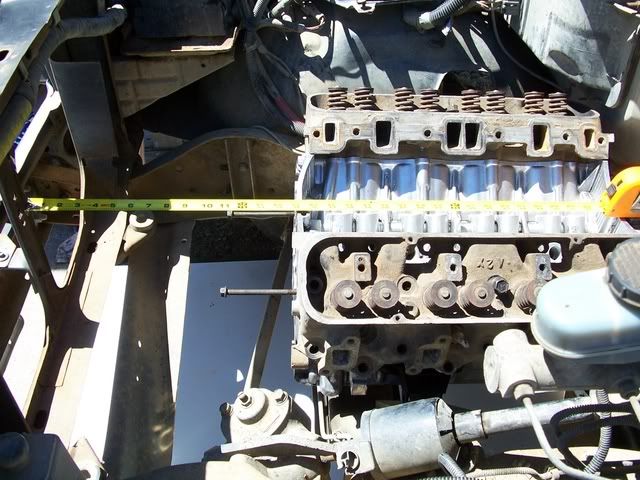

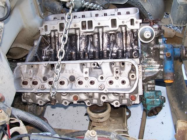

How's this for light???
Block with a pair of bare heads... lift it with one hand!!! No BS, these things are LIGHT!!!

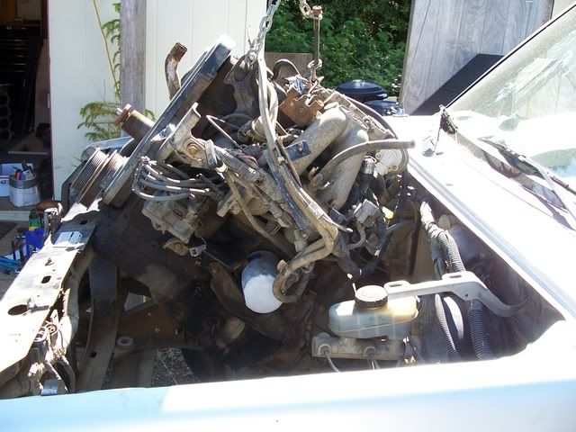

In goes the mock-up motor...

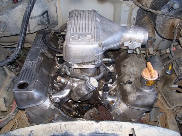

No oil filter worries...

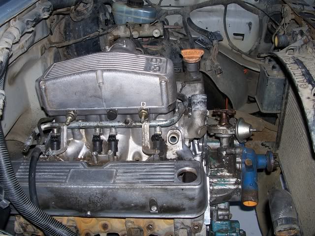

I'm happy with the preliminary test fitting, just waiting for my oil pan and bellhousing so I can get down to the nitty gritty.

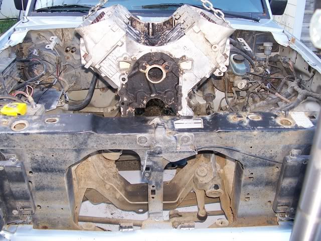

I stuck the Ranger rad back in to show how much room I have, about 3 1/8" from the fan hub to the core.
The oil pan mounting surface is about 5" above the main crossmember. I believe the deepest part of the pan is about 5 1/2 to 6" from about mid block on back.
The front part of the pan is probably less than 2" so I could set the motor lower once the old mounts are out of the way if I want to.
Looks like the 215 will be a natural for this swap, I think it will go smoothly with great results. The aluminum block and heads are SO easy to maneuver.

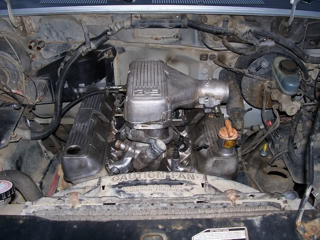

Well guys, had to work this last weekend too but I did manage to fab some seat brackets and get my bucket test mounted. Haven't had time to clean up any motor parts but I figure dirty pics are better than none... wait, that didn't sound right... Anyway, here's a few pics.
These are Rover pieces including the aluminum valve covers...

Love the ol' time hotrod look of the lower plenum "stacks"

Here's a shot with the hood closed showing potential for clearance...

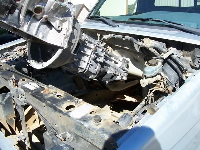

So I made some progress today guys, here are some pics of my mock up project...
Block, bell and T-5 united...
Package going in...

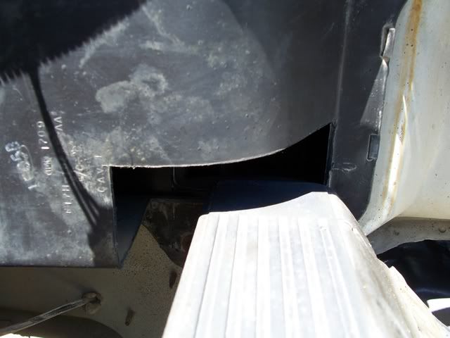

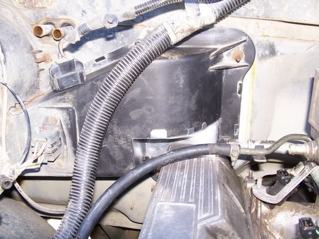

Heater box mod...
Temporary aluminum cover in place...
Firewall clearance, no hammering of the seams necessary...

T-5 right at home...

Well, the oil pan they sent me was the wrong one so that will wait for another time.
I feel I made some decent progress today. The trans crossmember, not pictured, is a piece of
1 1/2" square steel tube, .095 wall thickness, set into the frame rails. I still need to fab an adapter for the 22* Camaro mount before I finalize the install.
