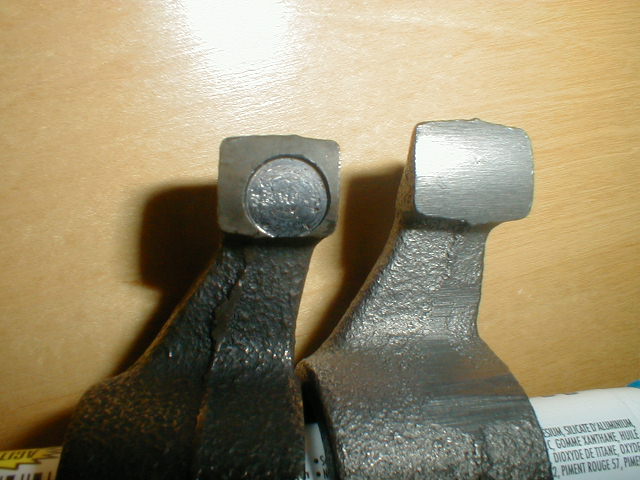

When I got my 4.0 in 2001 it was tapping. It had been owned by a Fuller Brush salesman--lots of driving, no maintenance. Sometime in 2002 I could no longer stand it, and the oil pressure was getting low, so I decided to fix it. Mind you, your oil pressure gauge isn't a gauge. It's an idiot light device. It shows normal if there is any oil pressure. Mine had a max of about 25 when I put a real gauge on it.
The first thing I noticed when I started pulling things apart was that every single lifter was stuck tight in it's bore. I could not tap them with a hammer and get them to move. My rocker tips had holes beaten in them by the valve stems. The pushrod end and socket in the rocker was not bad.
attachment.php
I miked the whole engine and everything was okay except that the rear main was in or out depending on how you squinted at the lines on the instrument. That normal since the flywheel is on that end. The rings and bores were in great shape. Just a lack of oil changes. I put it all back together. I had to take extreme measures to disassemble the lifters. The little plungers were baked in the bores with carmelized oil. I soaked and beat them for hours. When they came apart finallk, I cleaned them well with Hoppes and a .44 brush and put them back together. New oil pump, rockers and pushrods.
That was over 6 years ago--45,000 miles. It hasn't made a single tap since--not even on a cold morning. Runs like a bear.
I would not just change those parts. First see how your oil pressure is with a real gauge. Then, see that your lifters are free. You should be able to give them a soft heavy bump and they should move freely. Then you can think about just replacing the top easy parts.
Keep this in mind--with respect to that picture I posted: The tip slides back and forth across the top of the valve stem. You aren't looking at abrasive wear--that would be an oval hole. You are looking at a loose clearance with a pounding at the end of it's travel. That is from the stuck lifters. That is from nasty oil.
