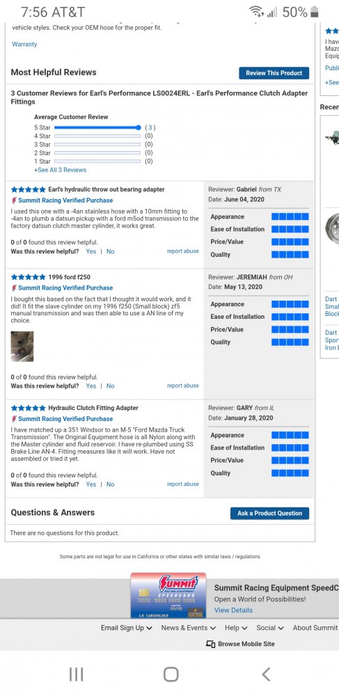

So I was looking for this for a friend. But im sure we could put this somewhere for people to find who want to use a stainless line instead of the plastic ford line.
46294

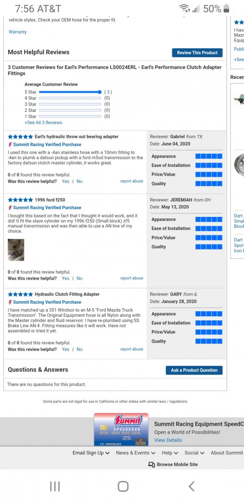

What do you do for the master side of the line?
Its in this thread 1st post its a Russell fitting but that is for a 3an line.
(Rus-640281)
And you can use this one to adapt the 4an adaptor fitting for the slave cylinder to the 3an line.
