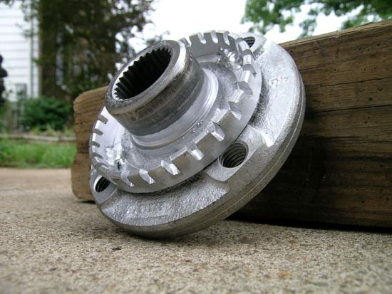

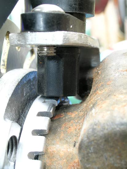

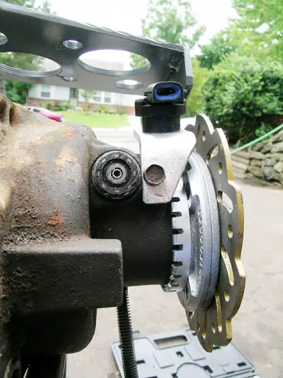

Tone Ring is a BMX bike gear tacked to the pinion yoke with a bracket for the vss.
