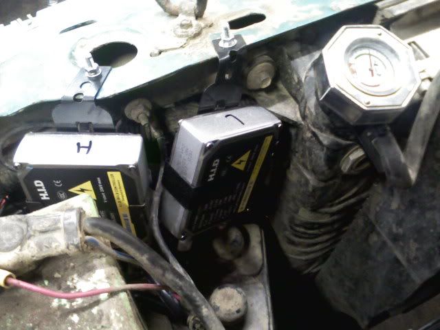

This is where and how I mounted the ballasts for the drivers side. Note that I labeled the boxes "H" and "L" for easy ID if I run into problems later on.
And this is where I mounted the passengers side ballasts. Labeled as well.
