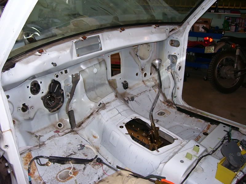

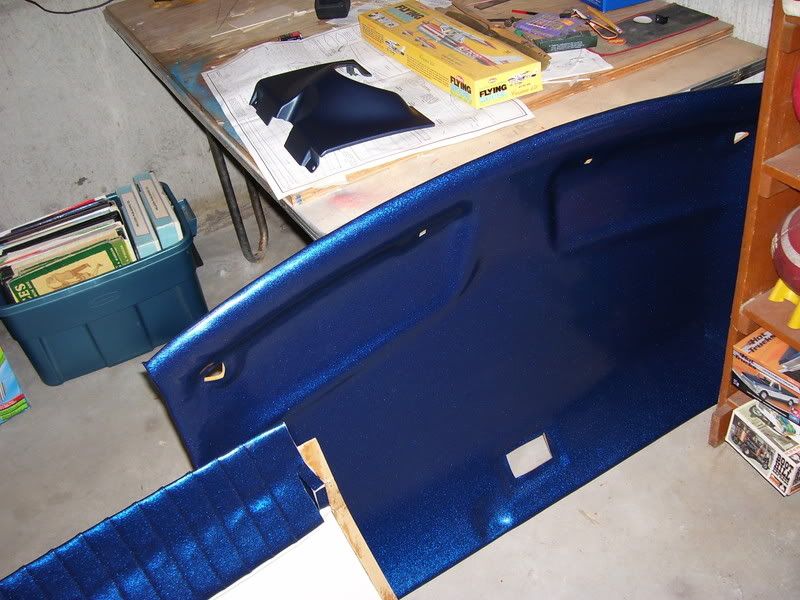

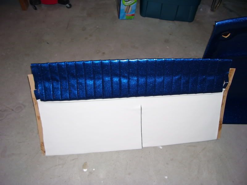

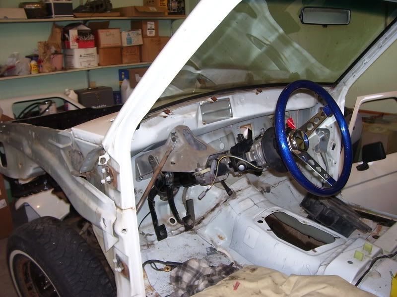

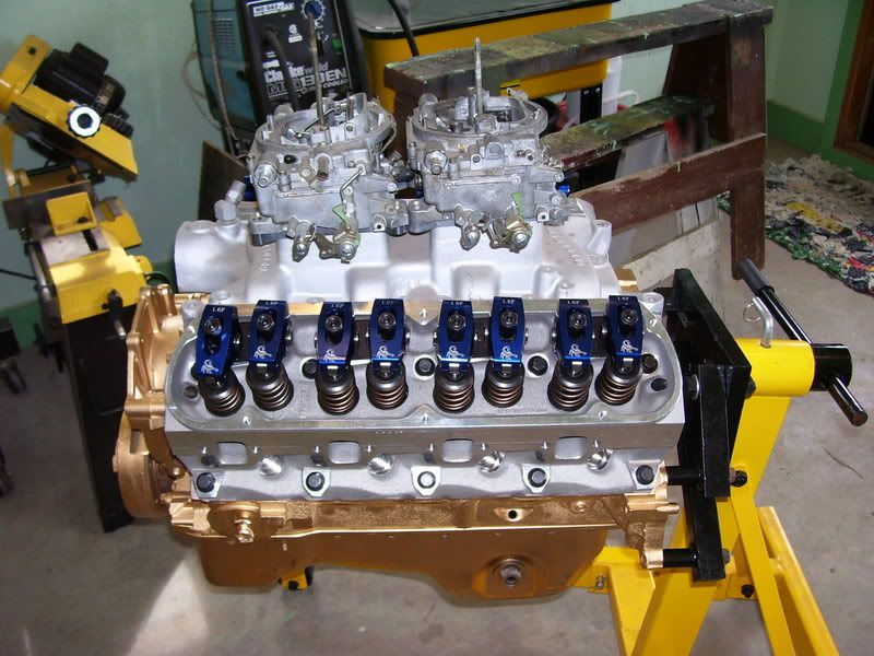

1992 Reg cab long bed. It is still just being mocked up. Everything still needs to be taken apart for blasting and powdercoating before I can begin on bodywork. It will primarily be a show truck, but might see a couple drag passes. I hope to have it completed ~2012.

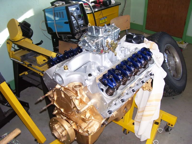

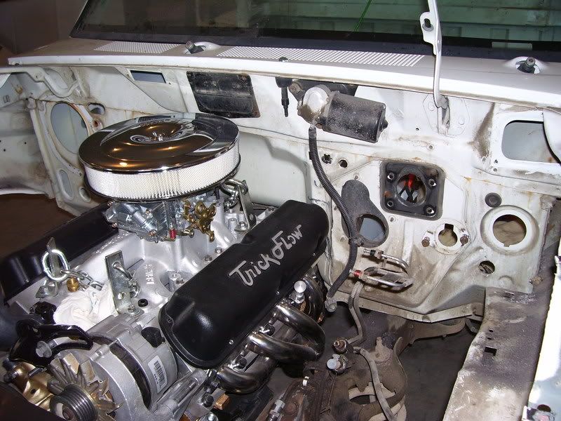

Engine is a 1989 roller cam 5.0L. Trick Flow Track Heat heads, Trick Flow .542/.563 cam, 10.5:1 compression, gear drive timing set, RPm air gap intake, 670cfm Holley Street Avenger. Full MSD ignition with billet distributor, 6AL box, superconductor wires, and Blaster 3 coil. Swap components are all from Advance Adapters. Transmission is a C4 with 3000 stall JW converter and manual valvebody. Rear end still needs to be built, but will be a 8.8 w 3.55 gears, Detroit Locker, 31 spline Moser axles and c-clip eliminators. Steering converted to manual, still debating manual brakes.
Here's a few random pictures from so far.
This first picture is from the last day I drove it before totally dismantling. It will be much nicer the next time it moves.
With dual quad setup I decided against running.

I am trying to save as much weight as I can, so ditching any power accessories helps. Removing the PS gives one less thing to potentially leak, and I won't have the wretched whine under the hood when its running. The brackets I had interfered the pump and the steering box, so I just decided to scrap it. Its a light truck anyways. The power brakes I am not sure about. I may or may not have enough vacuum to run with my cam, so then I'd need to run a vacuum canister adding another ugly item under the hood. I might try it and see if it works as is. It would save a lot of effort to just leave the brakes alone.

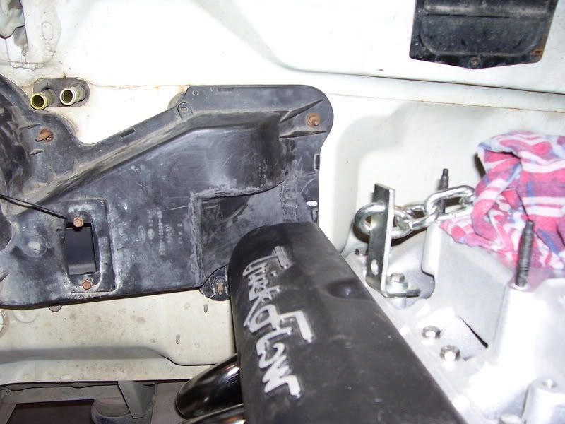

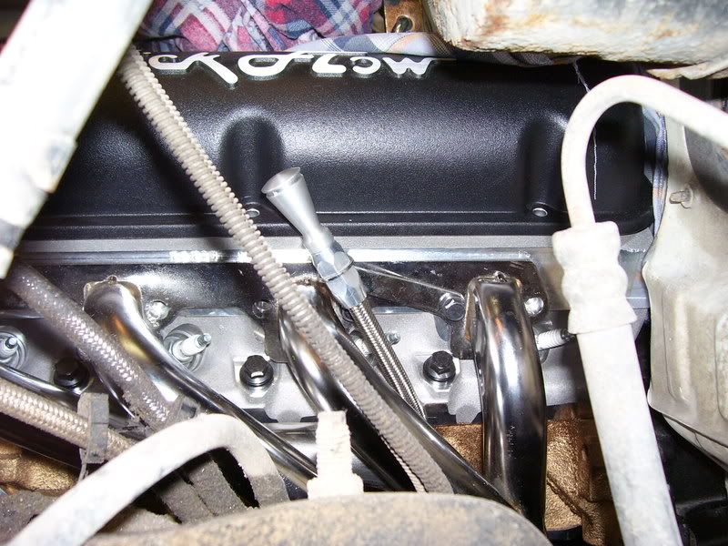

What headers are those??
Tell me those are advance adapter headers so i have a reason to complaine to them
Yes, they are Advanced Adapters chrome plated headers. What are you going to complain about???

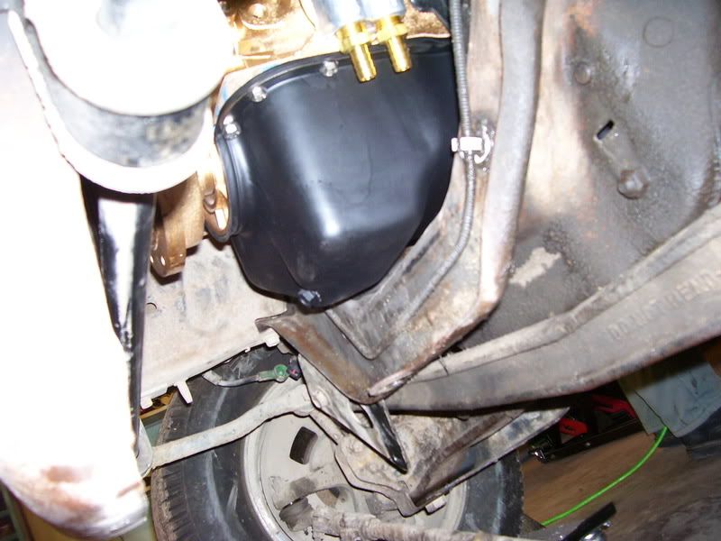

The fact that mine dont fit worth a damn, the collector sits partway under the transmission oil pan instead of running along the side of the transmission, and im just not happy with them at all...
Mine didn't exactly drop in either. I had to notch the framerail, and the bellhousing, and run a mini starter on the passenger side. Driver's side fit nice. Were you using a 157 or 164 tooth bellhousing? They took some effort, but that's to be expected on anything custom.
no i had no problems with fitting them to the engine, i expected to notch the frame a little, i cut a couple ears off the bellhousing that looked like they were for supporting the transmission for production and storage. but the header shouldn't protrude downward under the frame and under the transmission oil pan.
