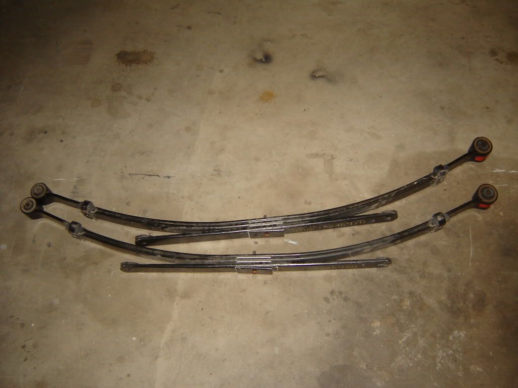

So i was kinda in a rush to get some kind of rear suspension travel before I head to the desert early nov. So i tried this set-up and it worked amazing considering it only cost my about $200 plus shocks.

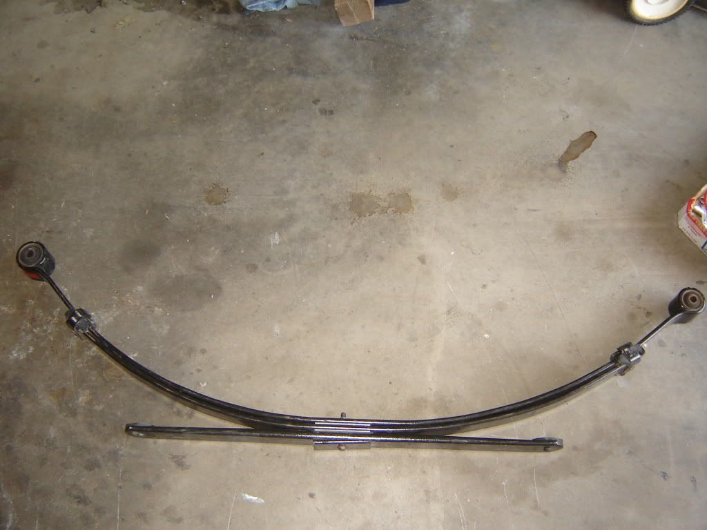

First- bought a 64" leaf spring from an 06 1500 silderado:
then i had them arched to 12" at my local spring shop:

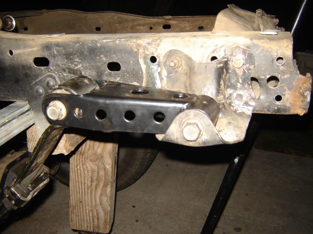

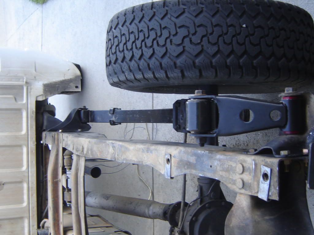

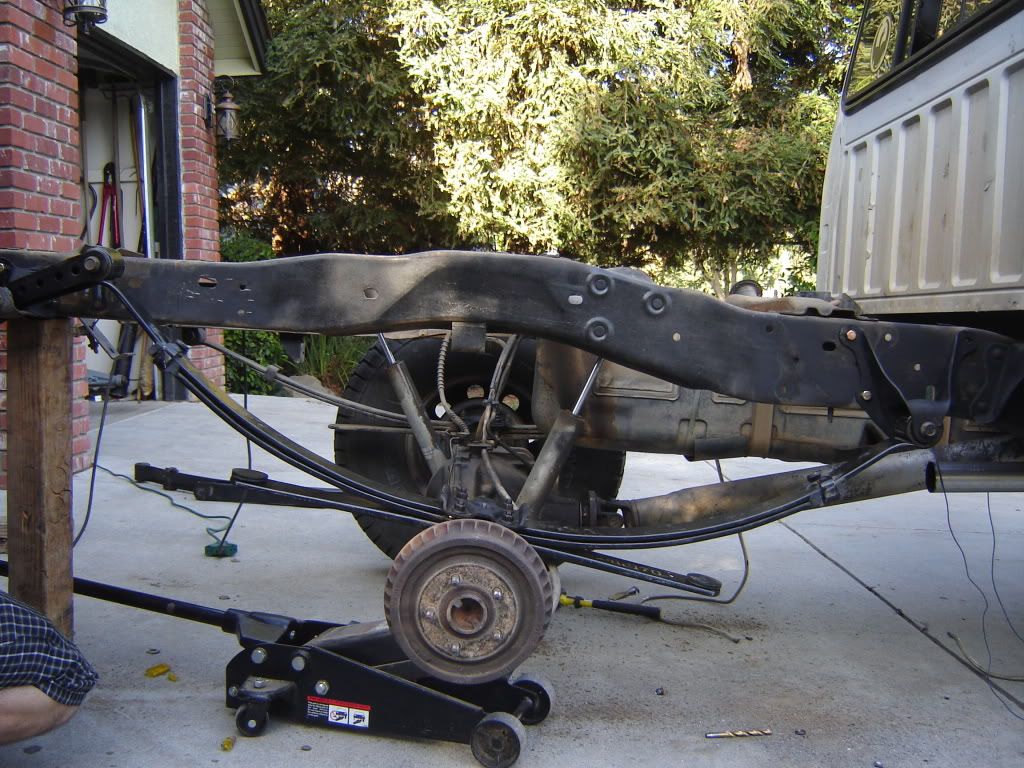

I moved the front mount forward a set of holes, about 6"

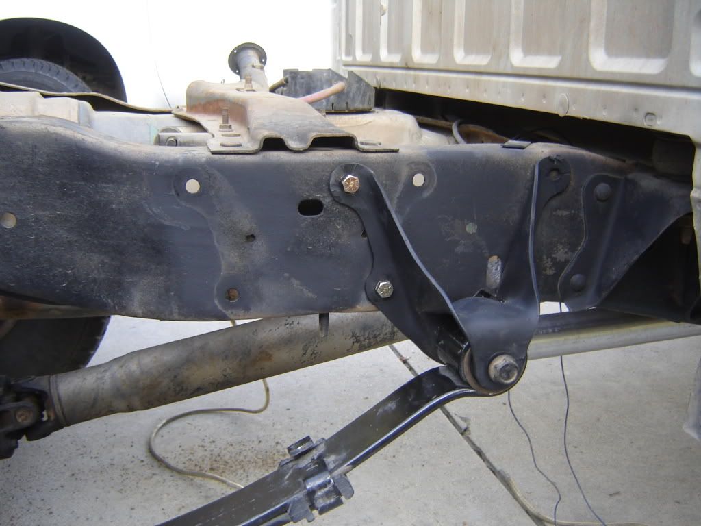

then i fliped the rear shackle mount and moved it back 3"..used a 7" shackle
on the driver side it was a pain because i had to drop the tank to get to the other side ot the bolts.

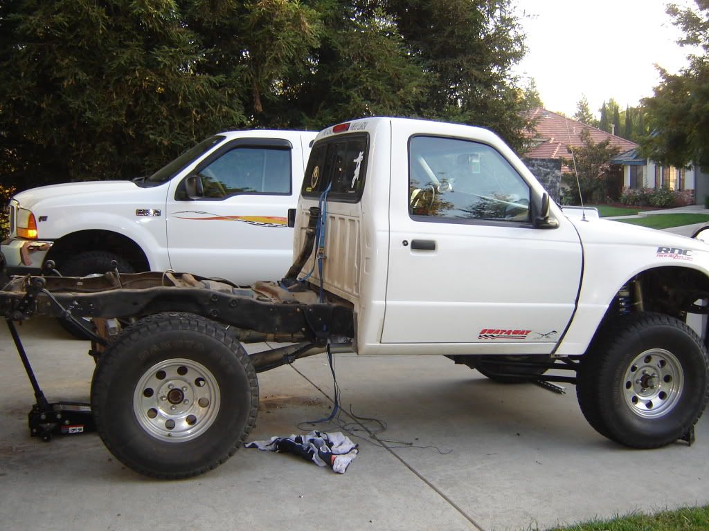

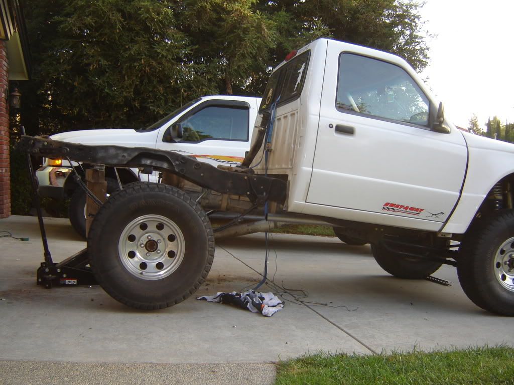

siting:
fool droop:
stance:
droop:
ill take more pics with the bed after i get back from the metal yard.
ended up with 18" of wheel travel...not bad for what it cost

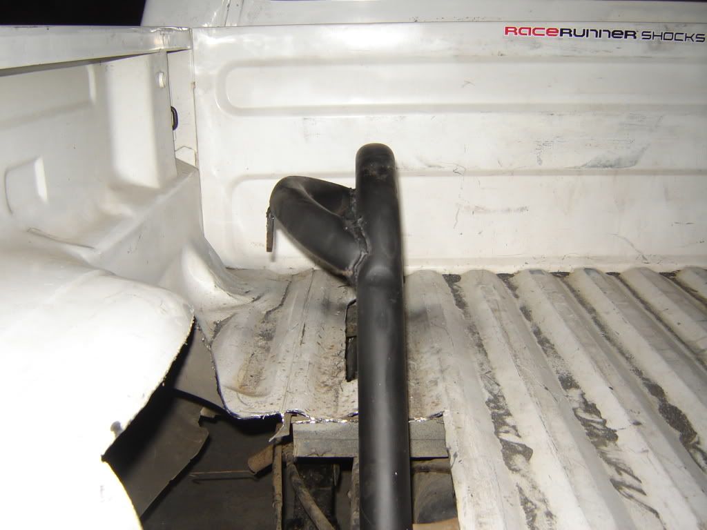

more business has occured
added some new cross members:

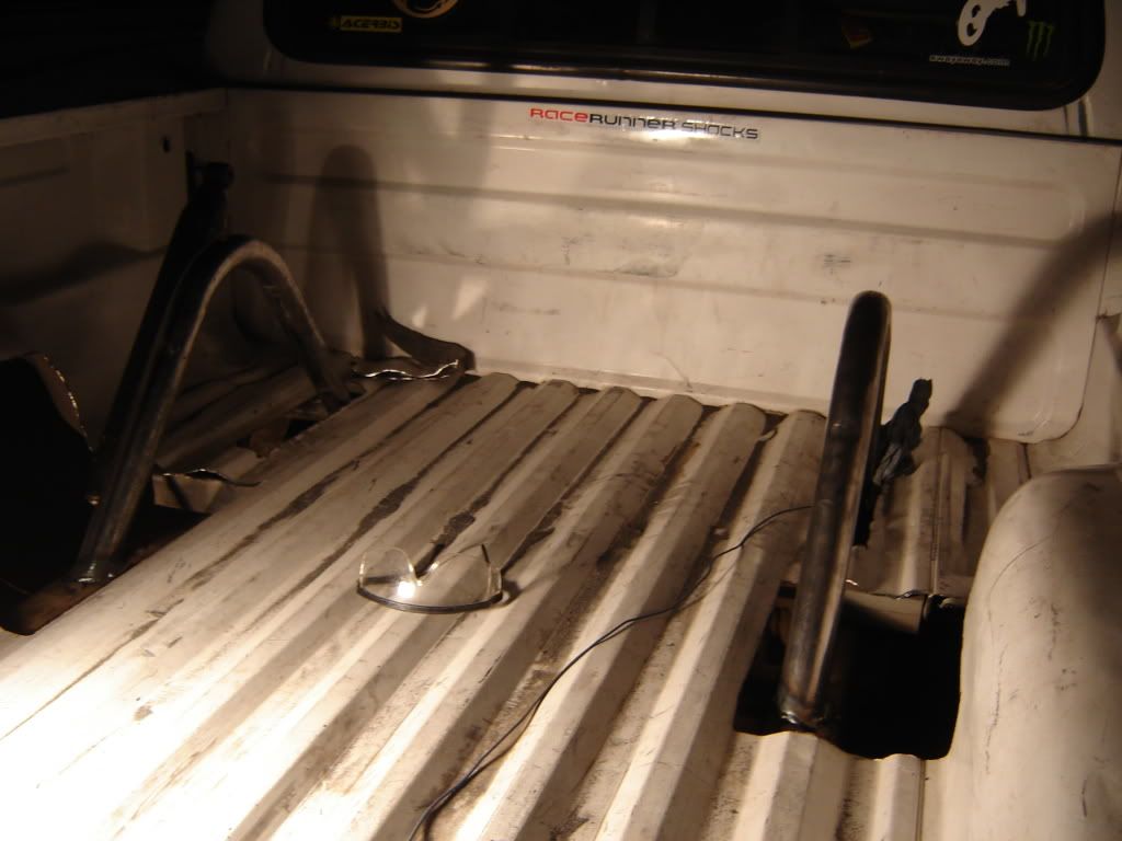

started bed cage:
I was shocked when i saw how much travel it ended up having
..ran out of jack:
Looks like all your droop is in your shackle. How much uptravel you got?
it bumps out 9" of up travel before it hits bump stop..i just tried it it out and it cycles really well..the shackle moves back as good as it falls forward...i had to adjust the shackle placement after the first test because the spring de-arched a bit...which i kinda anticipated..now that its settled it works great

that cage im workin on is probably gunna be temporary
