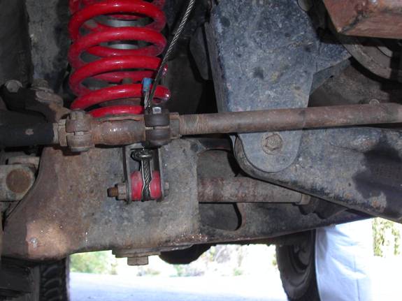

1.
My TTB keeps wearing out my tires too fast (or wears them funny)
This is probably by far the most common complaint on these things, and blame for it is usually (incorrectly) put on the camber curve that's a normal characteristic of the suspension.
The REAL cause is more likely the bumpsteer that's created by the angle that the steering linkage ends up at after installation of a suspension lift. This causes the toe alignment of the front wheels to change quite drastically as the suspension moves, and will easily wear out a tire 10x faster than any changes in camber would.
It's unfortunate nearly the entire suspension lift industry has done such a poor job when it comes to steering corrections on these things. The drop pitman arms normally provided with most kits consistently come up way too short, which fails to restore the steering to it's proper geometry (and is why this issue occurs so often).
Fortunately there are fixes available for this (one of which is a mere pitman arm swap that can take as little as 30 minutes to do if you have the right tools).
This page goes into greater depth about understanding how the steering works on a TTB, and gives some suggestions for correcting this all-too-common issue.

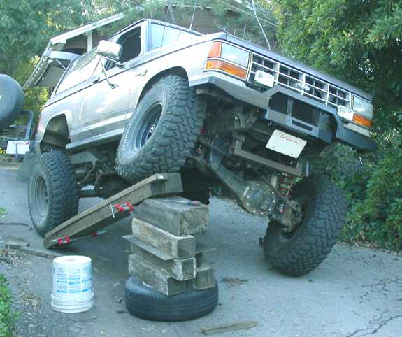

But a TTB axle will never flex or perform offroad like a straight axle can.
Well, this may be partially true.
TTB lift coils downright suck. They are too stiff to allow any decent flex. You put these same coils on a straight axle and it ain't going to flex at all either.
A simple swap to better coil springs can make all the difference in the world here.
TTB suspensions are easily capable of 18+" of articulation on a Ranger, Explorer or Bronco II with only a minimal amount of modification. While it is possible to exceed this number with a straight axle, how much flex do you actually need in order to have good performance?
Exceeding about 18-20" flex (without also widening the track width) begins to sacrifice the vehicle's handling stability unless you can also greatly lower the vehicle's center-of-gravity. This isn't always easy to do on a vehicle with full (or even trimmed) fenders and large tires.
Lots and lots of flex certainly can make an excellent ramp (poser) truck, but it doesn't always translate the same in terms of trail performance.

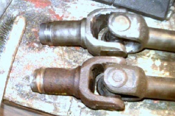

Well, simply put, the TTB center joint & slip-shaft is normally not subjected to the same operating angles typically seen at the steering knuckle joints. The slip-shaft also has a very large spline diameter (much larger than where the shafts go inside the diff). It's not likely to see a failure here unless the shaft is somehow binding up inside the axle beam.
If you have a lot of flex (like what's shown above), places to check for binding are within the beam "window" that the passengerside shaft passes through, and where the ends of the large radius arm bolts protrude into the passengerside axle beam (this one may be a bit harder to see, check carefully for it).
A bit of work with a grinder can allow a much greater amount of movement if needed.
Shown is a center yoke that has been clearanced for additional droop travel:
Is a SAS the only option?
This beam window was widened to allow more movement of the shaft during flex. You can see where it previously was rubbing:
The large axle spline on the RH shaft can also be trimmed about ½-1" shorter with no loss in strength if it should bottom out in the yoke when both wheels are at full droop.

Originally posted by Evan
Grinding down the yokes and replacing the stock half clips with full-circle retainers over the caps seems to dramatically improve the strength of the TTB joints. I have been wheelin with a locked front and 31s for awhile and never broken anything.
Almost all the breakage I've seen with others is when that half clip pops out due to the spinning cap and lets the cap come out. This results in a broken/lost cap and broken ears.
EDIT: Another way that works is to use the half clips but put a little tack weld at the end of each one. Just strong enough so they won't spin; you'll have to grind off the weld to get the clips out again.
