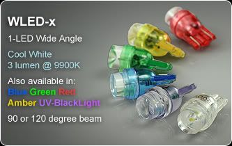

I just put blue LED's in my dash a couple of weeks ago. I have a gen1 ranger but i was thinking of doing a write up on it. I ordered my LED's from http://www.superbrightleds.com/led_prods.htm
I ordered 2 different types of LED's for my dash because i didn't know how bright thy would be, on the back of my gen1 gages i only have 3 main lights so i had to order some brighter LED's.
I ordered these first in a gen3 these will work fine, I actually used these for my blinkers which are now red.
Instrument Panel LEDs
