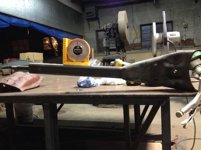

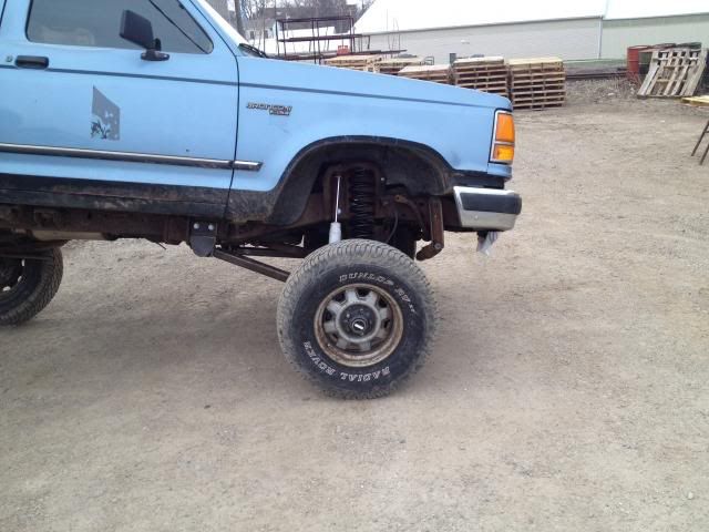

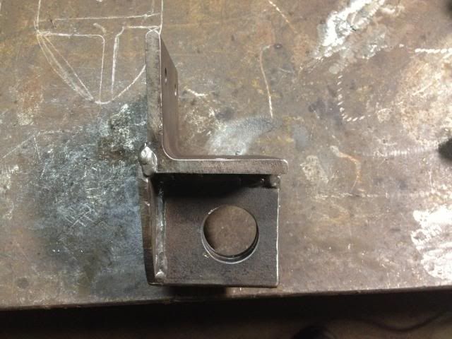

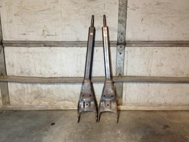

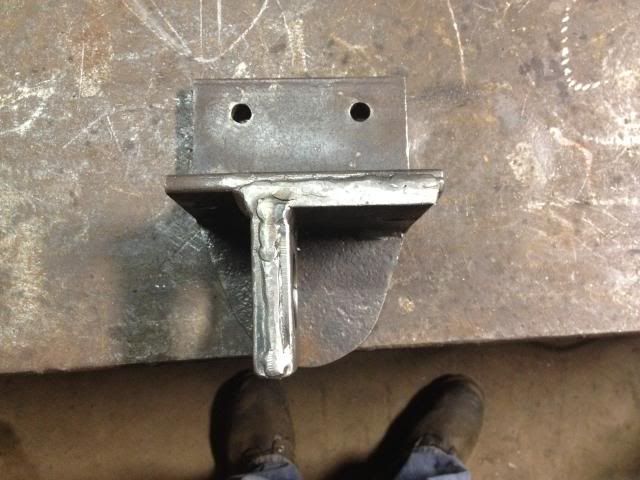

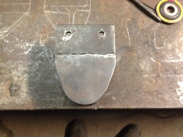

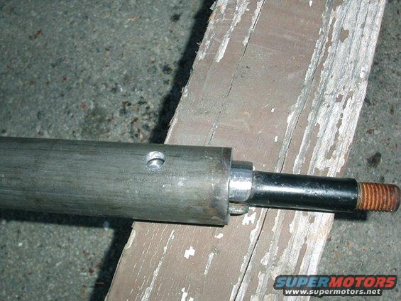

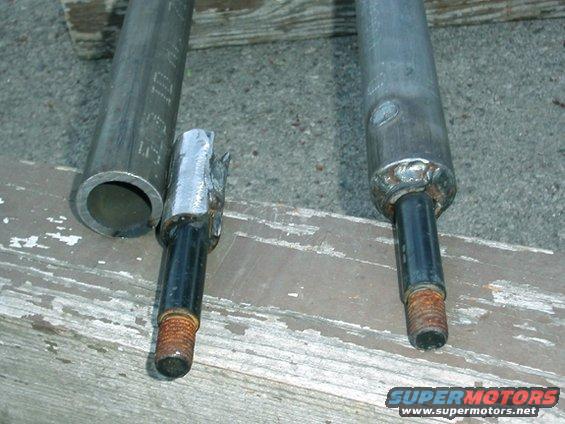

Stock arm cut and lengthened using 2” OD ¼”wall DOM with stock rad arm mounts sleeved and plug welded into end of DOM, Just like 4x4 Junkies. Reinforcement welded onto stock arm section as well as on mounting tabs.
Mounts made from welded 3/8" plate. Uses stock rubber bushing.

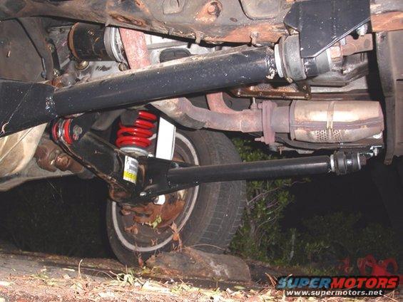

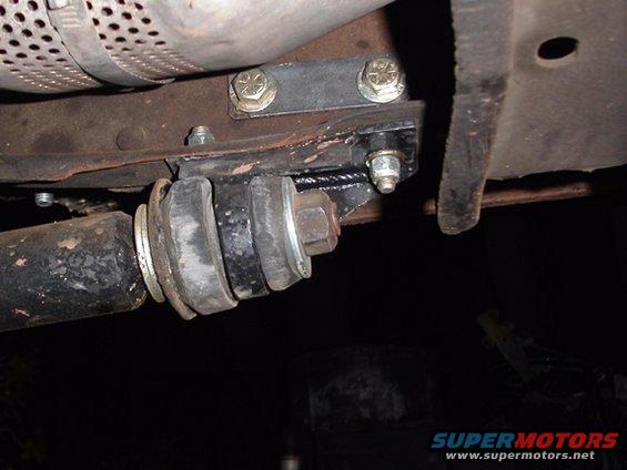

Just for the record, these are mine:
Arms are extended 12" over stock length, also using 2" DOM tube, .250" thick wall.
Frame brackets are made from 3/16" cold-rolled plate steel, and are mounted separately from the transmission crossmember.

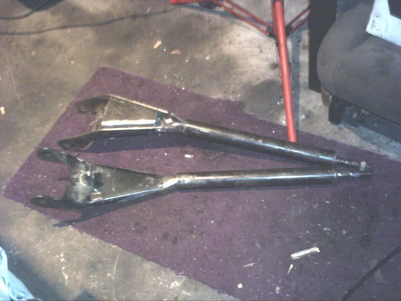

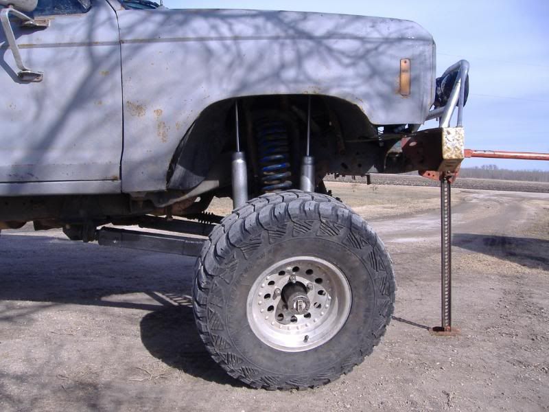

Mine
15" over and fully fabricated. Only thing re used from original arms was the pin for the bushings.

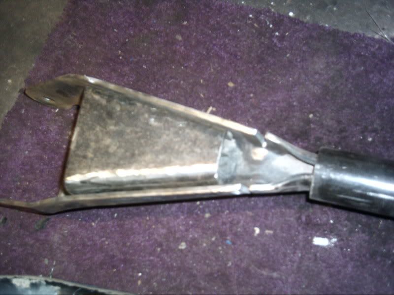

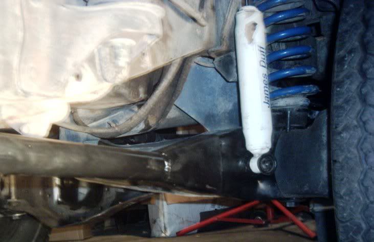

Mine were simple. begining with 2 sets off rad arms I slid 2 in .250 wall dom over the stem of the stock rad arm leaving the entire stem there. then cut the entire stem off the other rad arms and slid that into the tube. I then cut notches in the rad arm about an inch forward of the tube. bent them so the tires wouldnt rub cut a triangle section out of the old arms used that to brace the notch and bend then had them fully welded.
finished and installed rad arm you can see the final location of the section of rad arm that was welded to the complete arm to brace the bend (was pictured on the inside during the mockup) but the welder thought it was better on the outside i agree.
wheeled on them for a year then parted it out and started building another truck they now belong to Deamers87ford.
