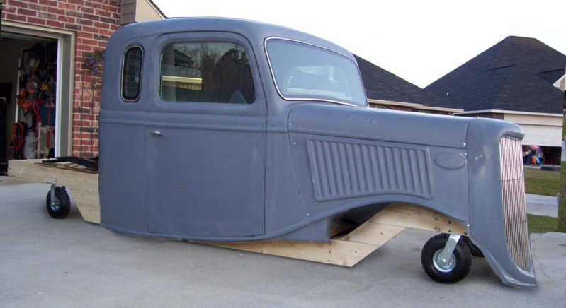

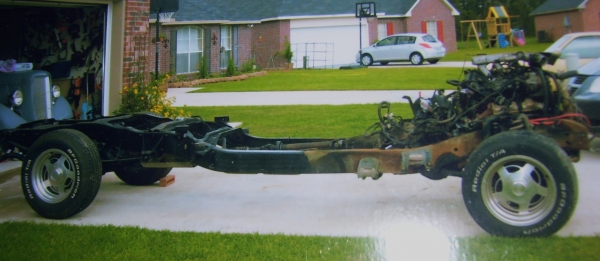

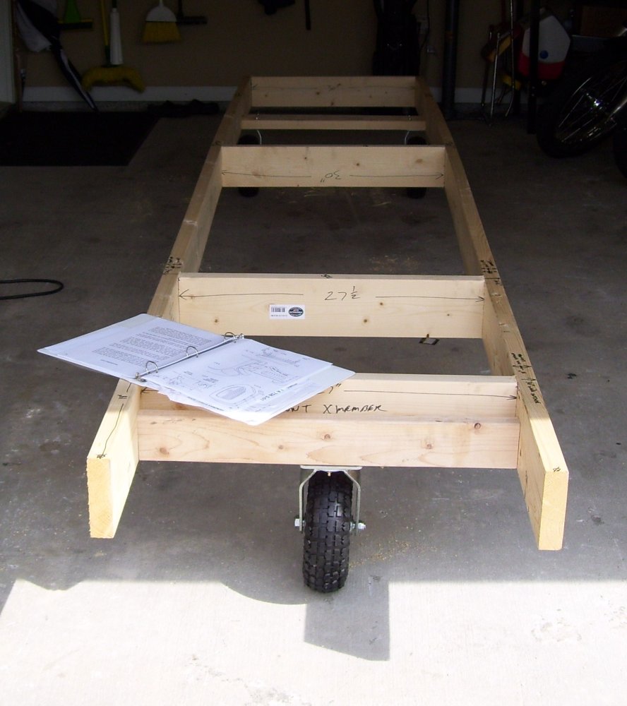

It's a miracle!!!! Just Goes To Show Ya If You've Got Brain Damage, God's Got Somebody To Take Up The Slack !!!!!
Edit: #2 pic... thanks for finding the chassis pic for me--looks like I got the rear half of the (oem) chassis looking decent with some wire-brushing & 5 cans of gloss black....gotta move the cab mounts before I spray-bomb the front half of the frame.

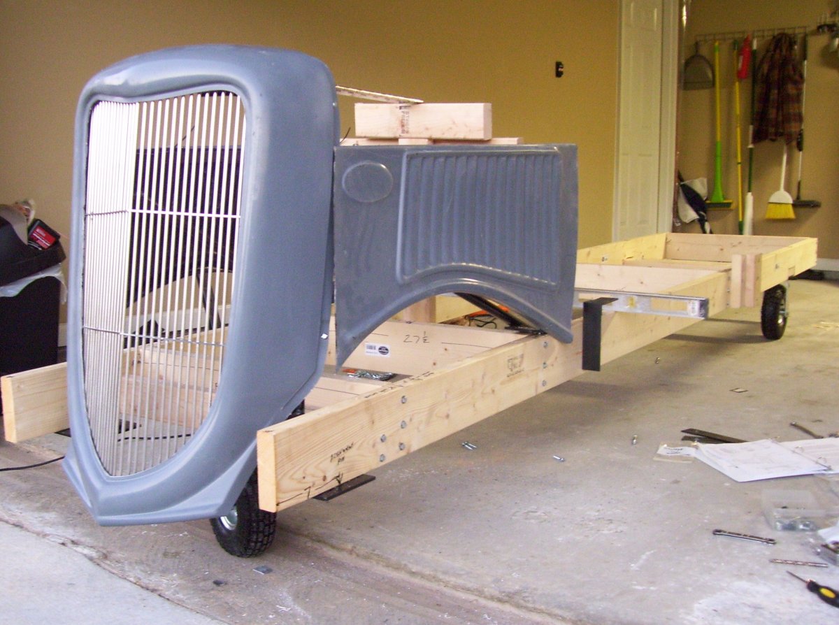

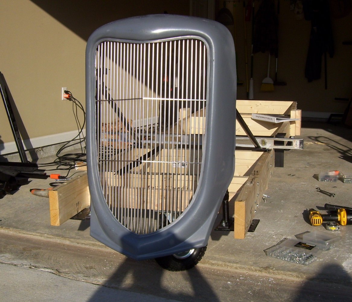

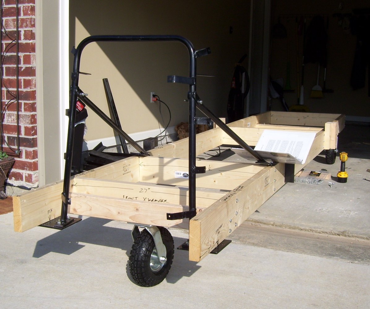

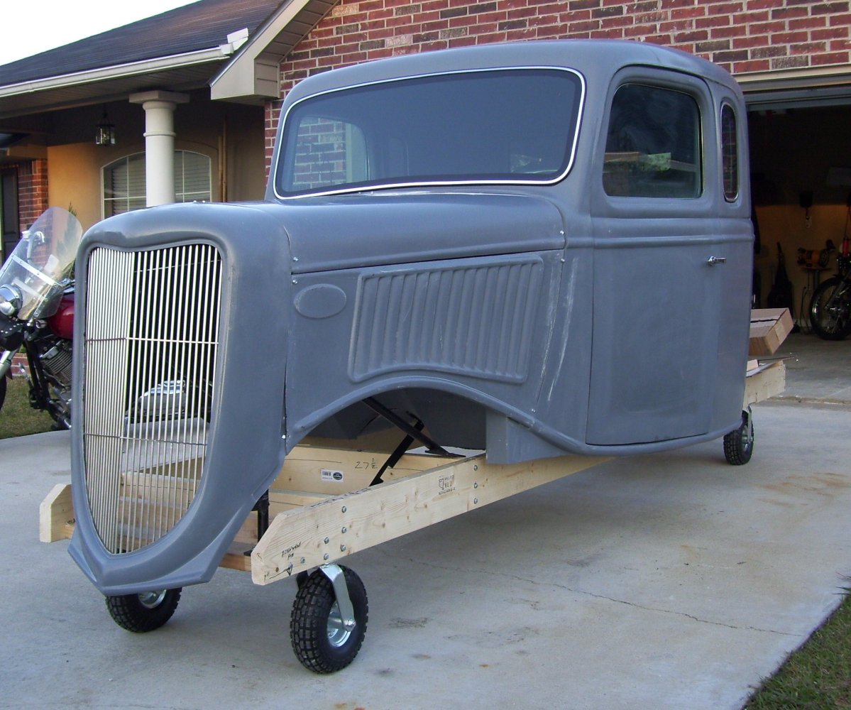

Here are the pics of setting the fiberglass parts on the Official 100% Scale-Frame (of course the wheels are smaller)...............

Out Of Sequence Photo

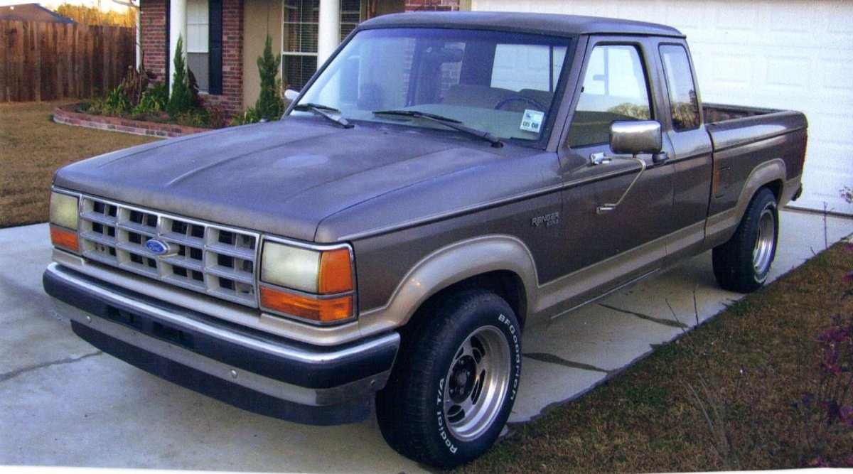

Ive been tryin to come up with a quote....looks like you guys found one for me-I'll start using it soon.
Edit: the engine is stock 2.9l EFI---180,003 miles & no smoke out of exhaust--I was argueing with myself over 25 mpg OR 2.5 gal.per mile, so I made myself leave the 2.9 in the truck till gas gets to $1 a gallon. :icon_rofl (see-braindamage)

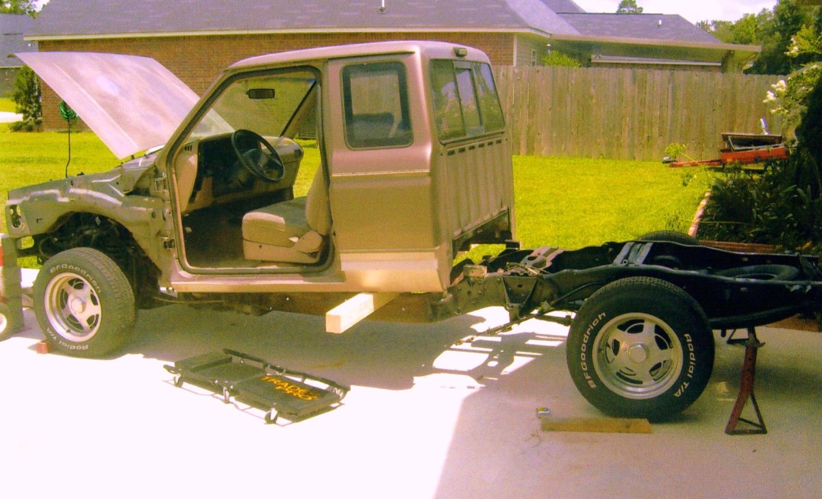

Edit: This is a view looking at the '89 Ranger being disassembled. You're looking through the '34 bed.........

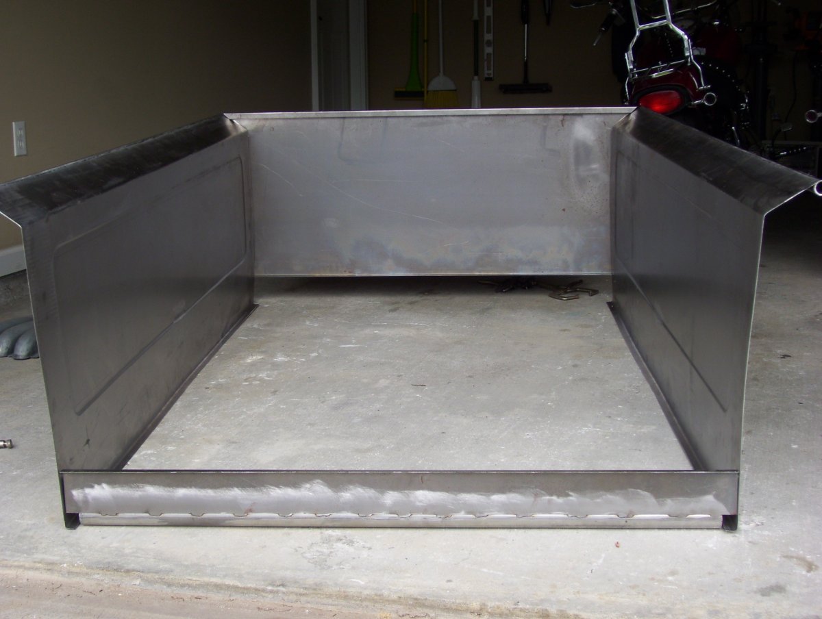

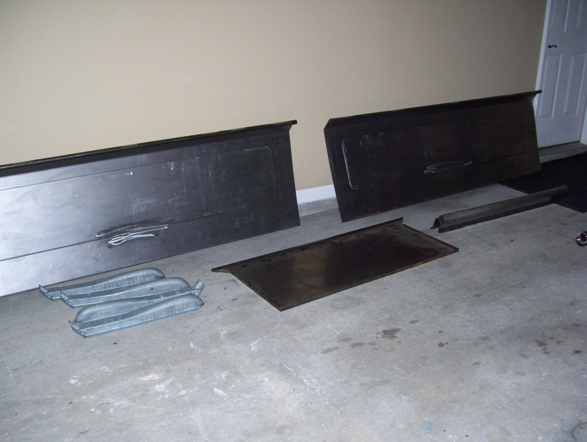

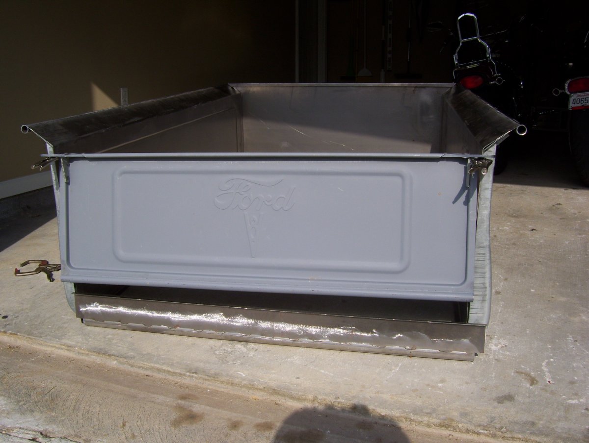

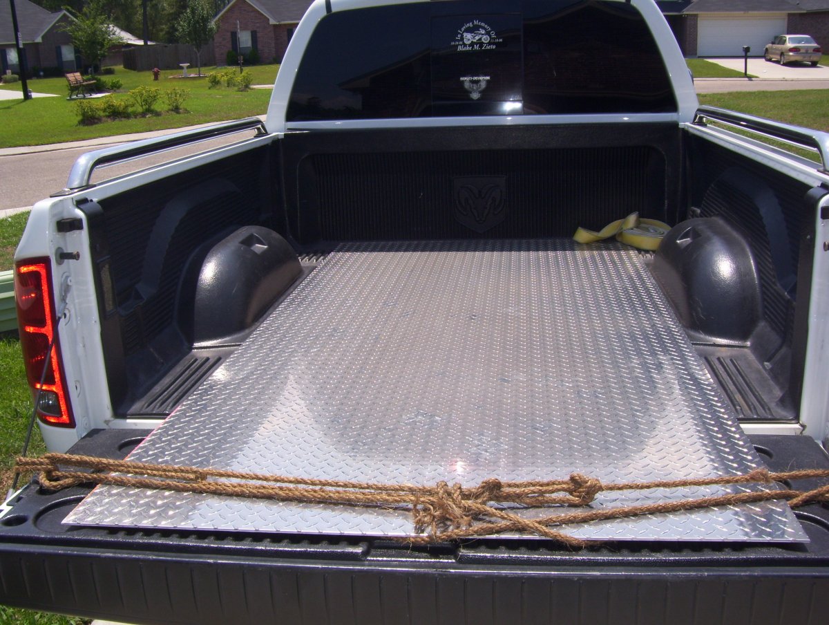

Bed in a Box (my amatuer welding didn't turn out too good later on--but the body man hid most of it)
Oh well, I was aiming for the well-used '36 Ranger daily driver look.
I got this bed kit for 1/2 the price of an assembled bed (less the flooring...I think I'm gonna go with aluminum diamond plate)
(Note: The assembled beds only need a little body work & paint...you make your own mounts to fit the Ranger chassis.:icon_rofl:)
Edit: July 2022...I'm still trying to find the unassembled bed pics****FOUND THEM Aug 2022
My son-in-laws truck delivering the plate.

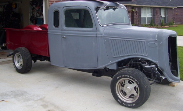

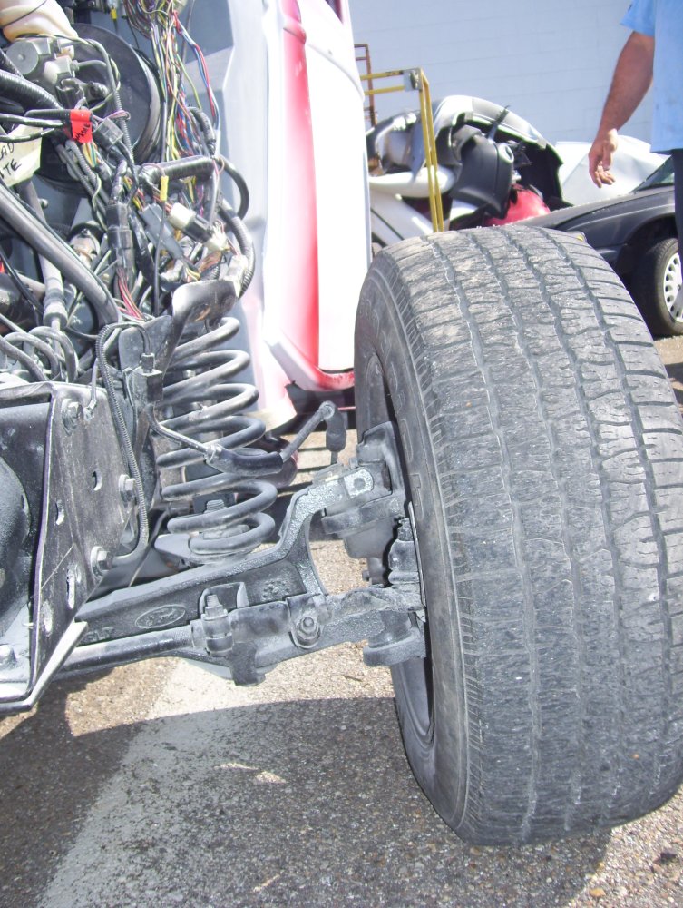

Mocking up front end--it had about 6" clearance between tires/lip of fenders...front suspension is still at OEM ride height (alt. & p/s pump were just relocated so they would clear the hood sides)
I had to saw the frame horns off to get fat fenders in the right spot...worked out just right...didn't loose radiator mounts to the recip. saw :yahoo: I still need to install the up-right radiator & re-plumb the xmszn cooling lines

the TTB looks right at home under there :icon_thumby:

Refering to pic # 13, It took about 4 hours to relocate the alternator & p/s pump over the valve covers and align the belts so the hood sides would fit since the '36 grill is 2 feet narrower than the '89 grill....that's why it's so easy to see p/s pump & alternator thru the hole in the grill...just enough room to put a pancake a/c compressor between pump & alt.
