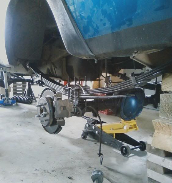

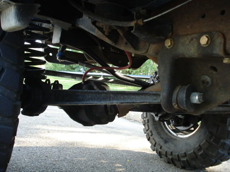

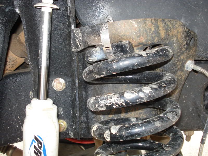

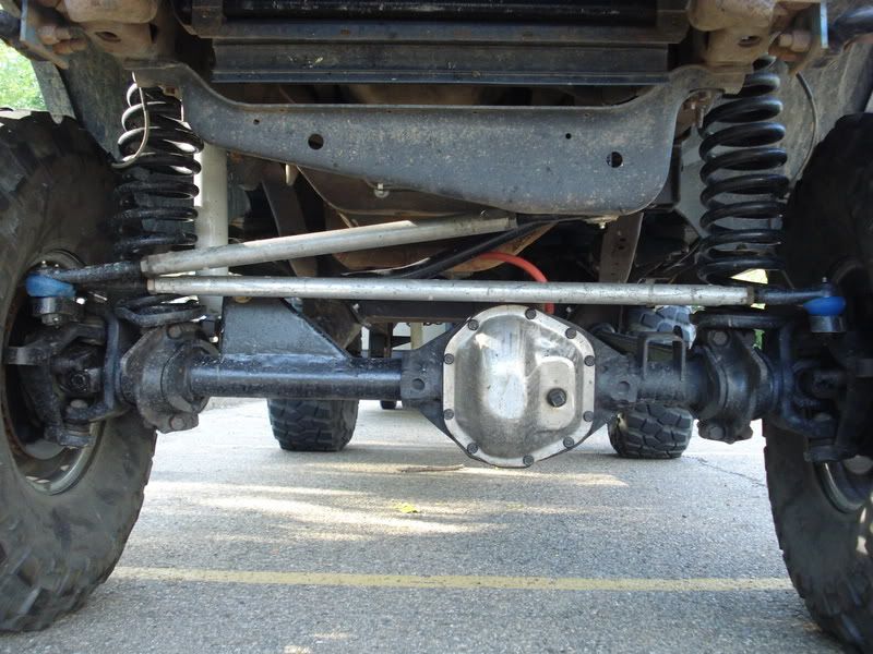

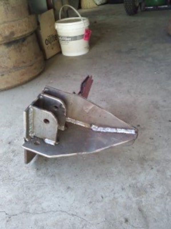

Well, this is in no way a perfect build, and there some things I would change and they will be mentioned. The prices I'm listing are in Canadian dollars, and they were from when the US and Can. Dollar were near equal. There are several ways to go about a build like this, but here's how I did it.
I'm going to divide this into 4 sections being: Factory parts/Aftermarket Parts/Wear Parts/Services.....now on with the show.
Factory Parts:
$200 - 73' EBD44 Housing and Radius Arms
$40 - 78-79' Bronco/F150 Radius Arm Brackets
$100 - 76' Supercab F150 Knuckles
$20 - EBD44 Shock mounts
$200 - 97' Explorer 8.8"
$000 - F150 Lift Blocks - 3.5"
SUBTOTAL - $560
AfterMarket Parts:

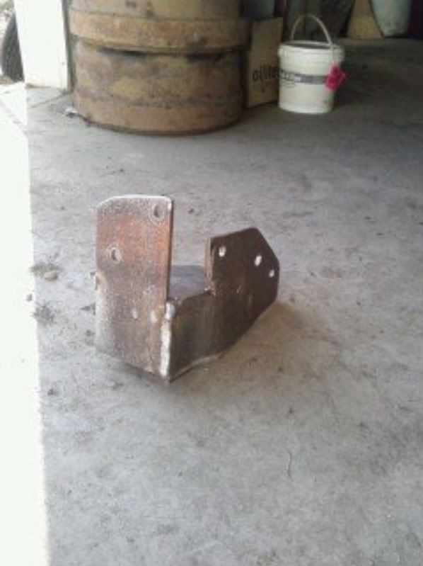

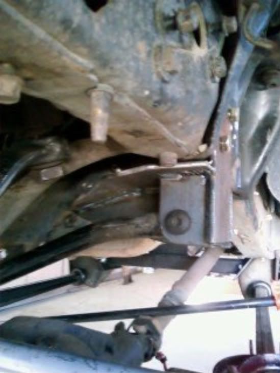

$000 - Track Bar Mounts upper/lower and Tranny crossmember (I built, already had the steel)
$350 - NWF High Steer Arms (got bent over on these)
$250 - 1 1/2"x 3/8"wall DOM Tie Rod/Drag Link
$30 - TJ trackbar and Heim w/sleeve for adjustability
$250 - 4.56 gears, front and rear. New but purchased through forums
$80 - Procomp Ranger extended brakelines
$200 - 7" Skyjacker EB coils
$275 - 5.5" Procomp 88-98 Chevy Leafs
$260 - Procomp ES3000 shocks
$75 - BellTech 6400 Shackles
$500 - Detroit locker for 31 spline 8.8"
$80 - 5/8" Ubolts and 9/16" Spring Bolts
$150 - 15x10 Chrome rims
$1200 - 5x 35x13.50R15 Krawlers
SUBTOTAL - $3700
Wear Parts
$200 - Moog Balljoints
$220 - Mevotech TRE's (One Ton Chevy)
$140 - Raybestos Brake Pad's
$120 - Calipers
$80 - All misc seals, front and rear not covered by rebuild kit
$140 - Rebuild kit's for both diff''s, new through forum's
$40 - Spicer Ujoints
SUBTOTAL - $940
Services
$140 - Machine knuckles, install chromoly studs
$600 - Install gears (ran out of time, could have done it myself)
$80 - Alignment
SUBTOTAL - $820
TOTAL - $6020 (EEK:icon_surprised::icon_surprised:....first time I actually added it all up.....must hide this post from girlfriend.....:dunno:)
I will update this as I remember stuff that I surely left out.....
So, if I was to do this again these are the things I would change:
1. Regear my own diff's
2. Center my rear axle on my own, not using forum 'guideline'. My rear axle is offset about 1 1/2" to the rear, possibly because my chevy leafs are a lift leaf and I'd use the body mount rivet on the upper front hole as a guideline instead of the rear lower hole in front lower hole guideline.
3. Mount radius arms forward 2" to give more tire clearance. Use the stock tranny crossmember hole everyone use's, but as a guide to move the mounts up squarely on the frame. This will also move your draglink closer to parallel with the Tie Rod giving you more useable steering angle.
4. Turn knuckles and use 0* C bushings. I have 7* offset bushings and alignment printout show's about 2* castor going down the road. Having wide tires exaggerates the issue.
5. Run a different shock, preferably adjustable. When loaded the ES3000's work great....the rest of the time they are fairly stiff and cause a somewhat rough ride.
I'll post more as I remember it....
-andrew
Note*** Some pic's are of parts that have been changed during the build, such as knuckles and rear blocks etc.....if you have specific parts you'd like a pic of lemme know and I'll snap one for ya.

i will say i like your build very much. i will also say i wouldnt have, and didnt, go with a eb44. however this thread i believe can be very helpfull to those doing the swap. gotta give ya props on the trac bar bracket. i made mine to far forward and will have to remake it. possibly doing something like yours:icon_thumby: i moved my radius arms forward using the crossmember holes as a guide. only 1 1/4 inch.
