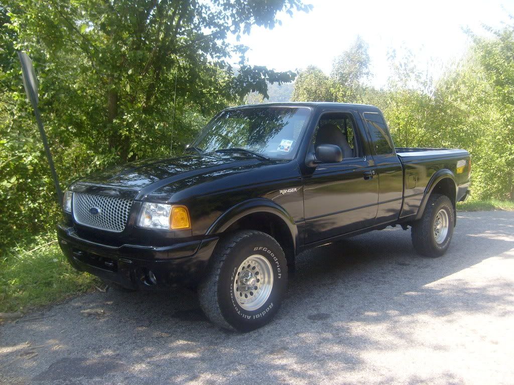

I converted my 99 to an 01 edge. I changed the fenders so I would have the holes for the flares and the hood to the edge style but the fenders and hood are not required.

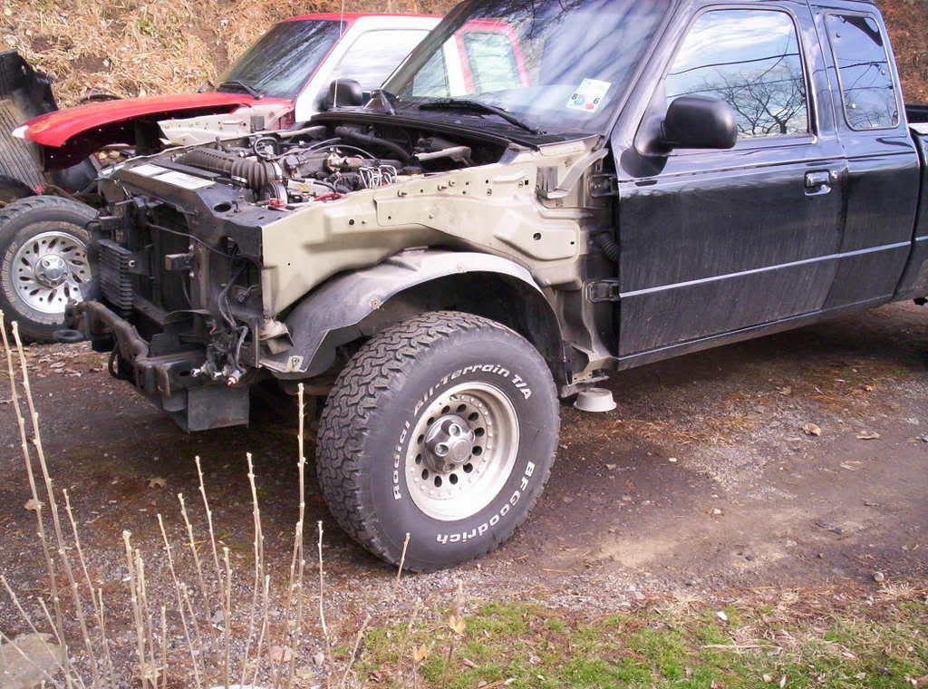

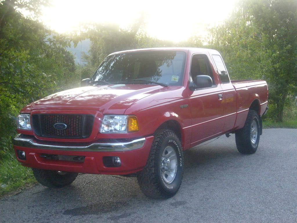

I also did an 04 conversion on my 2000 I am driving now with certifit parts(good prices)

dang dude thanks for showing me the pics...I think I might do it

I like the 04 much better but you will need a hood for that.

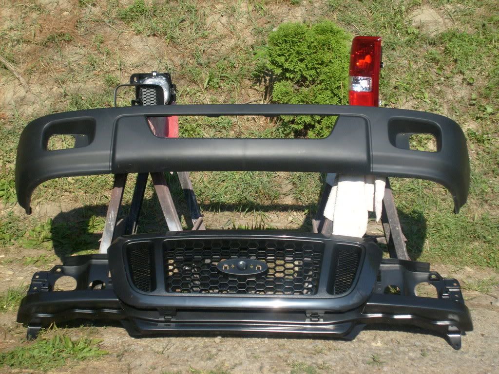

Here's the certifit parts for the 04 conversion
