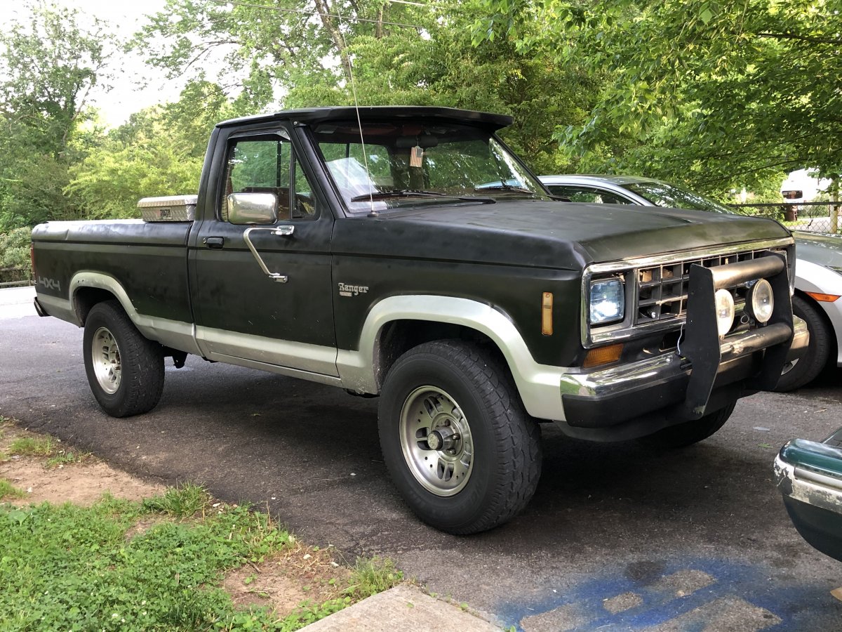

4.0 Swap - 1992 Explorer 4.0 Auto 4x4 to 1988 Ranger 2.9 4x4
