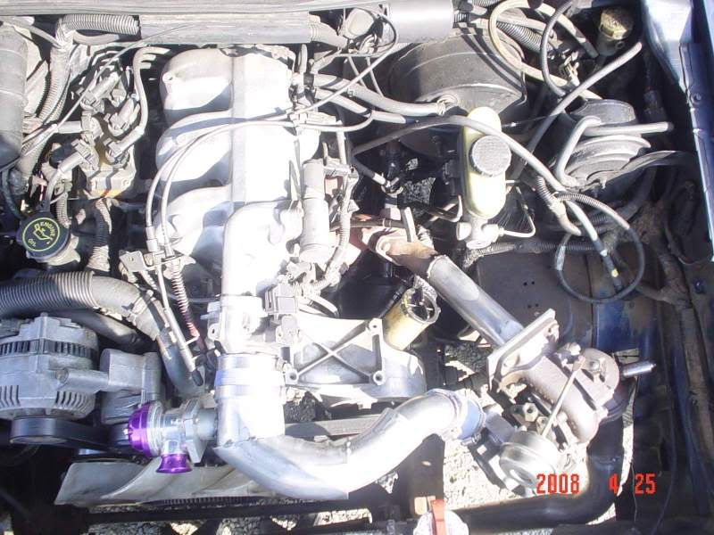

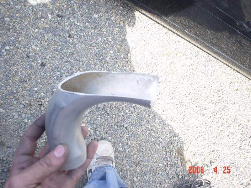

I had already tested flipped manifolds when the motor was out. So i dug in and first flipped the driver side manifold. It bolts up wit hno mods. there is a small lip that can cause resistance due to flipping the C shaped ports however it was so small i havent bothered with that yet. Sometime in the future I will port match the tiny lip that is sticking out in the path. Since this was my DD I built a temporary exhaust for the driver manifold that dumped up front with a muffler that was laying around.

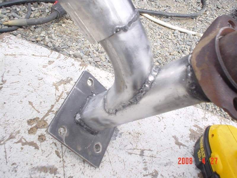

i used the cherry picked to hold the turbo in palce while I tacked it where I wanted it. I carve the flange out of flat stock that was laying around.
I took a hammer to the 2" pipe to slide it into the flange and weld

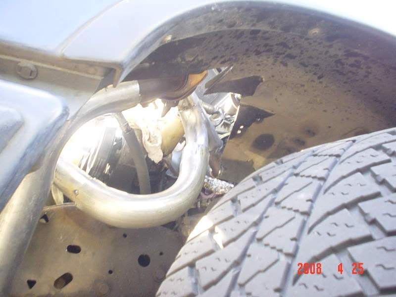

Then built a down pipe that originally had a magnaflow on it.
The splash shield had to be trimed for clearance and the overflow was deleted, along with the battery being moved 90* and flipepd the p side manifold

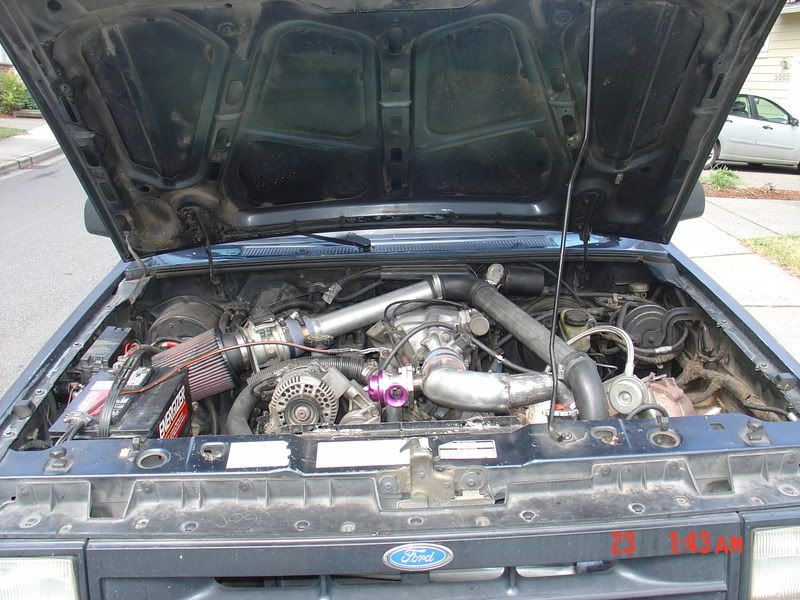

the hotside was ran in front of the radiator and then tied in right before the flange and then i built a cold side from the compressor outlet to the TB

What did you use for boost control? Doesn't look like the waste gate is hooked up. Also what/where have you mounted your boost guage? Or do you have one?
The boost gauge is mounted temporarily where the radio was. When i bought the sploder it had no radio and I have yet to put one in. The wastegate is hooked up you can see that in the last pic if you look carefully theres a vaccum line coming out of the bottom. There is also a manual boost controller bolted to the turbo right out of the pic.
