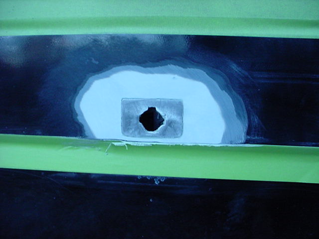

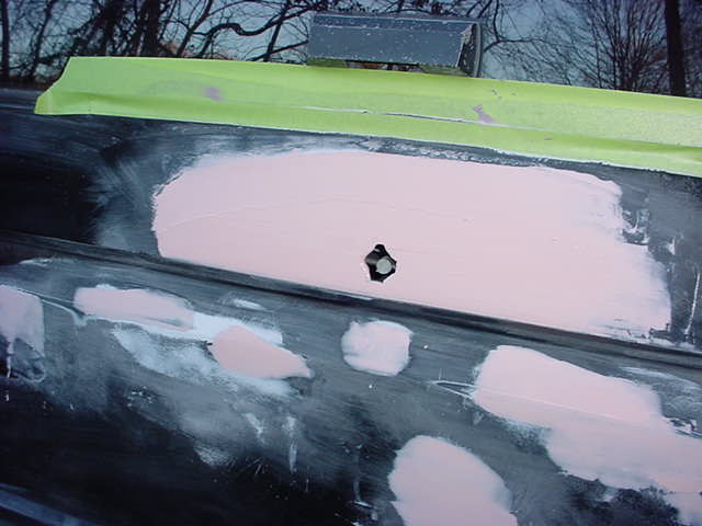

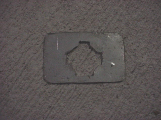

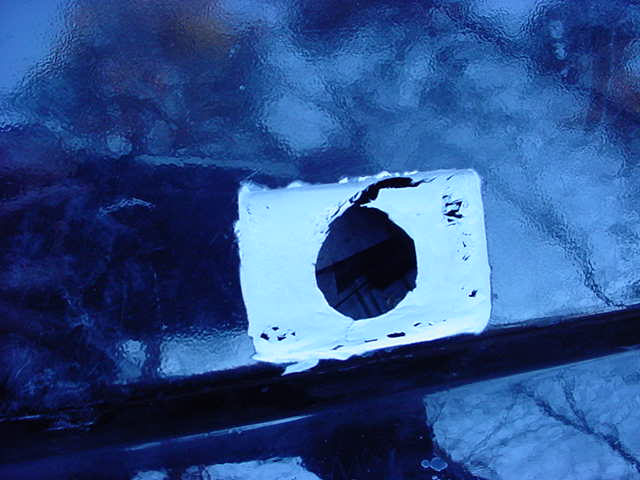

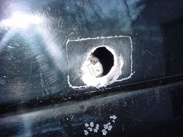

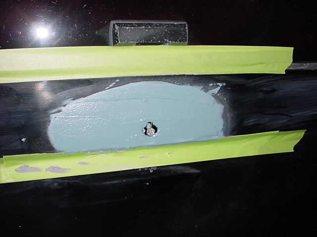

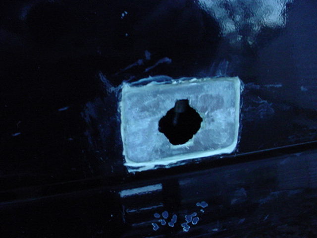

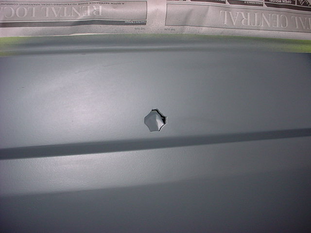

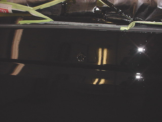

Well I redid my hatch and got my '84 only latch working correctly. This one needs the key to operate. But the hatch being fiberlglass means a stiff turn on the handle, even without a key and the entire assembly will turn. This chews up the fiberglass and then you have a sloppy piece of junk. This is what I found with my '84 I just purchased. So , I made a metal insert that was notched as needed to fit the handle/lock assembly. I recessed it into the fiberglass and covered it back up. Now I have metal embedded in the fiberglass which is what Ford should have done from the beginning.

Well follow my pictures and you can do it :)
