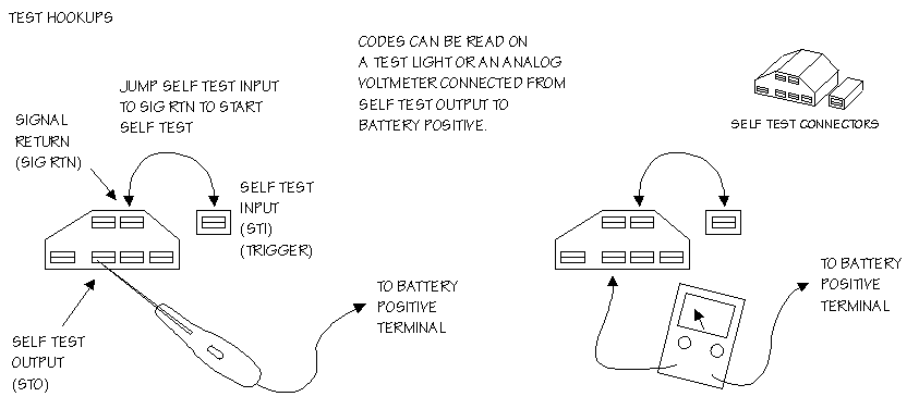

Would someone be willing to explain to me a little better than the tech library does as to where the plug is that I have to jack in to? I've looked for it, and I think I've found it but I'm not totally sure (it appears to be behind the fuse box under the hood, on the drivers side - but my plug doesn't look like the one in the tech lib picture).
The tech library says to use a test light, but people here are saying a paper clip. Where and how do I attach the paper clip please? Doesn't one end have to be jammed into the socket and the other end to a ground or a positive or something?
You don't need a code reader for any Ranger prior to 1995. There is no difference AT ALL in what it will do for you compared to a paperclip and watching the check engine light. One flashes a light on a plastic box in your hand, the other flashes a light on the dash. Same number of flashes, same everything. I didn't realize you couldn't find them in the auto parts stores anymore, but they were only about $20 a few years ago. All they were was a plastic housing with a couple of switches and an LED light. Worthless on any RBV past around '88 (prior to that, you needed a test light because there was no CEL).
I'm not sure where that tech library article came from. It was obviously copied from some other source, and needs to be rewritten because it causes a lot of confusion. The only EEC-IV equipment that can go further than a simple test light or paperclip that I'm aware of is the Ford STAR tester, but I've never actually seen one - it was a shop tool and certainly not cheap. I'll have to go pop the hood on my Exploder to remind myself where the test connector is. On the Ranger it's on the drivers side fender just to the rear of the fuse box, under a cover that says EEC Test or something resembling that. There are two pieces - the large connector with multiple pins, and a separate single wire connector. You hook the paperclip between the single wire and the SIG RTN terminal of the large connector, as shown in the image below. You can ignore the test light/volt meter portion of the image because your Check Engine Light replaces it.
