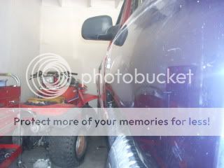

I will make this my first post since i am new here but visit very often, I decided to post here because i wanted to show off my rangers as well (3 rangers 1 explorer) I will show of my two reds today one is by far way under construction the other is my putter 2.3.
The first on the list is my 2.3 its ok i drive it everywhere and it has never left me stranded (Here is the mud pic i have several of them it loves the mud only got stuck twice of several trips)

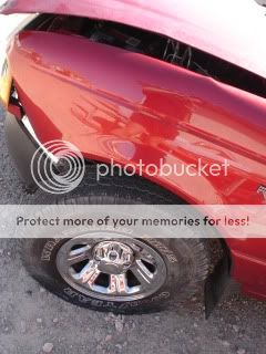

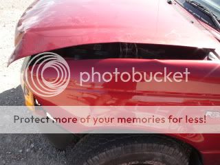

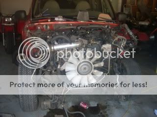

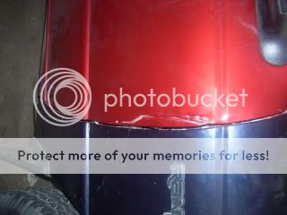

The second is my project its a 2002 and i got it totaled

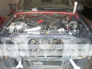

This is how i got it (I forgot to get pictures of during the tear down but i used my 2.3 as a pull for the frame stuff bent before front suspension so just the bumper mounting provisions
First Post
First Post

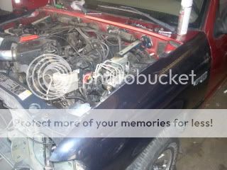

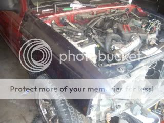

And how it looks now (Under a total front end rebuild)

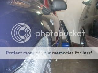

My grandfather gave me that truck in its current condition of the front end being offset by like 11" Frame is strait now and working on getting that front clip.

Just for informational purposes this rebuild has so far only cost $475 since i did all the repairs myself.
It is going to a frame shop to finish the frame pull for another $180 (Bartering at its best)

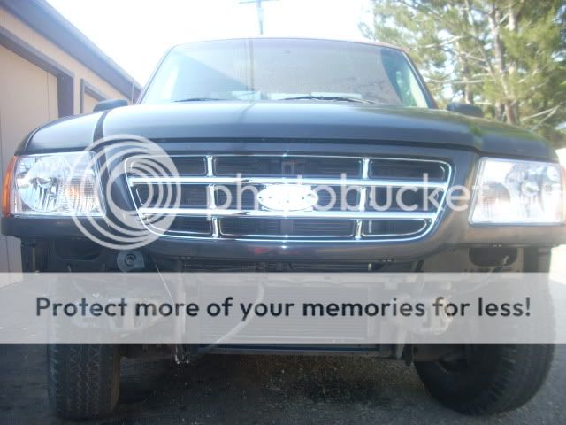

Heres the image updates. Front end almost complete already driving.
First Post
First Post
First Post
First Post

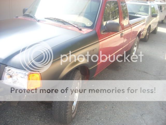

It is still heading to the frame shop to get the front part of the frame completed, I also am going to be in need of a complete bumper and i am thinking about putting the edge grill on even though i just bought the one in the picture it is brand new.

The rangers paint is being made by a family member that works in a paint manufacturing place. He says he can match the color but if he can't i will repaint the entire truck.
lookin like new, sans paint. I can appreciate the work you've done as I have replaced the entire front end on my ranger. I was lucky enough to not have to remove my steel inner fenders. But mine got a core support, radiator, fenders, and hood. Wish I had swapped to your style front end in the process but the funds weren't there.
