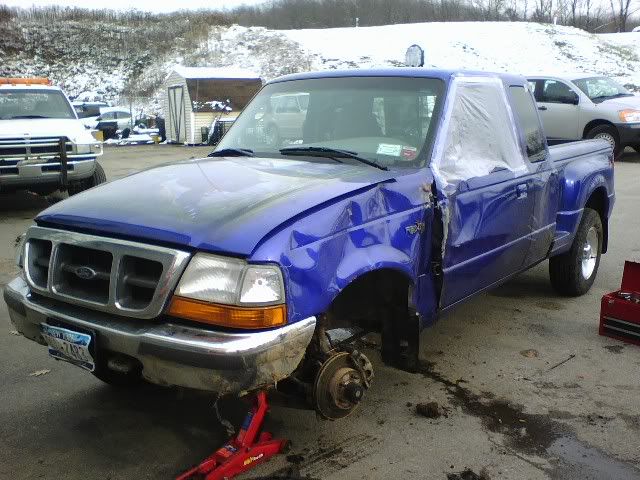

I've posted some random pics here and there, but I figured it was time to put them all togather along with a list of things I've replaced on my truck.

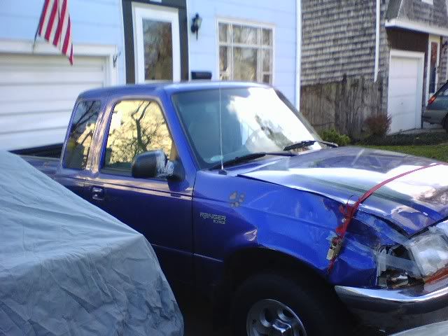

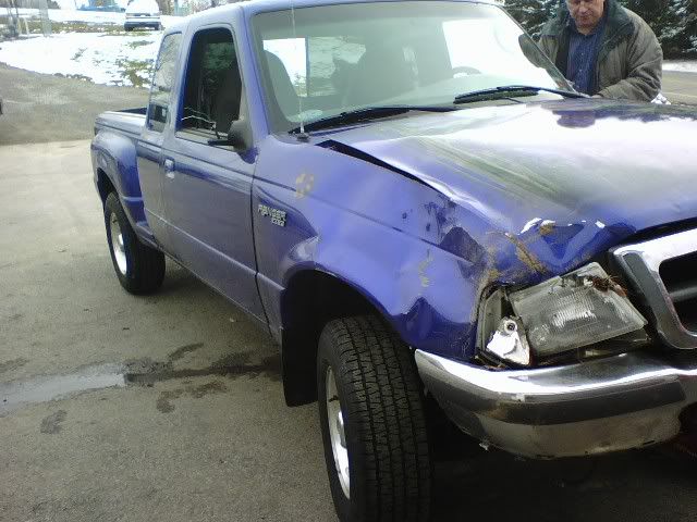

I bought this truck in late November 2007 to replace my escort that didn't run too well in the cold. No, I didn't buy the truck because of the paint job, I bought it because it was a great deal. Four days later on the way back from Pittsburgh for thanksgiving, the weather changed from light rain to heavy snow very suddenly, and I crashed before I even had a chance to slow down. basically I slid sideways off the road, hit a sign with the right front corner, then tipped onto the driver side and slid for 20 feet. I had it towed to the wrecking yard, and came back for it 2 days later. I put the spare on, taped up the window, push started it, and drive it home. That truck either tried to kill me, or saved my life. Not sure which. Basically I've been fixing it little by little ever since.

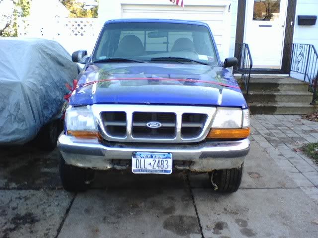

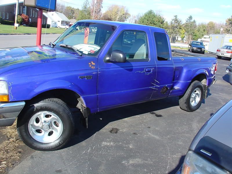

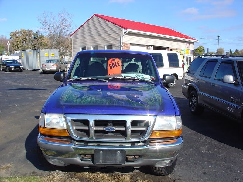

how it was when I bought it

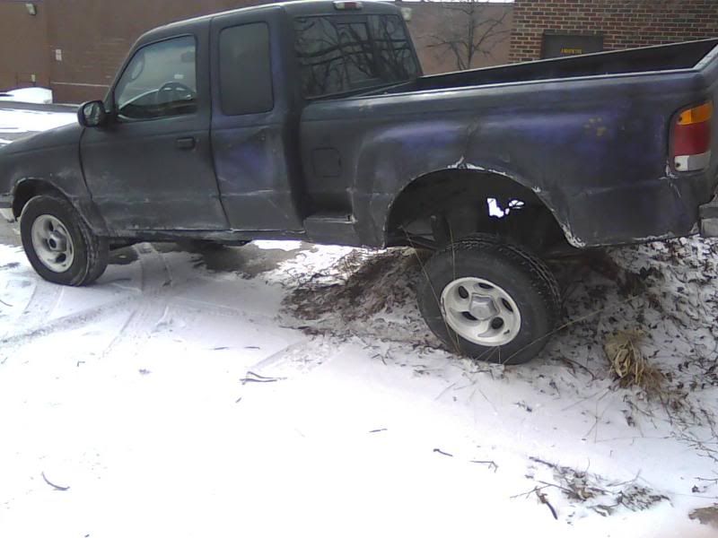

four days later

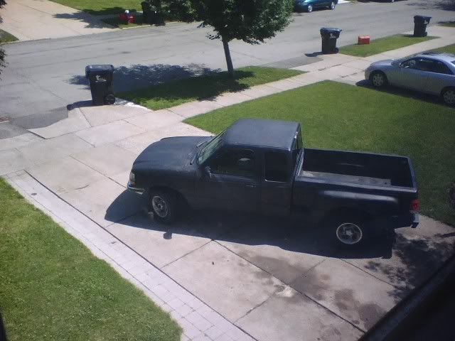

and after painting flat black

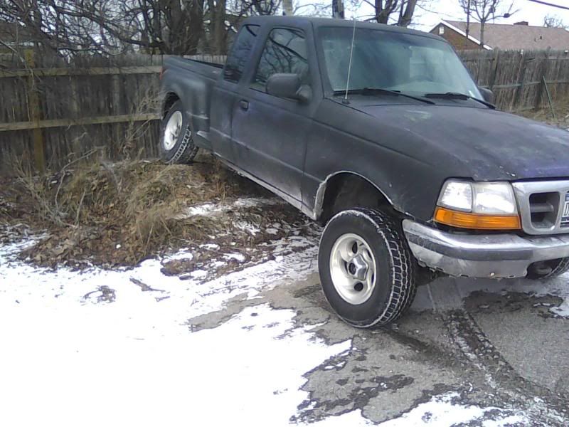

stuck, not sure when

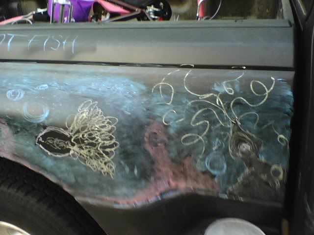

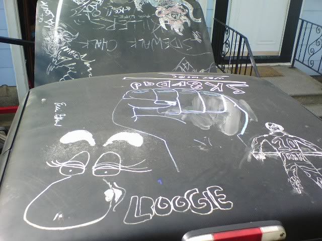

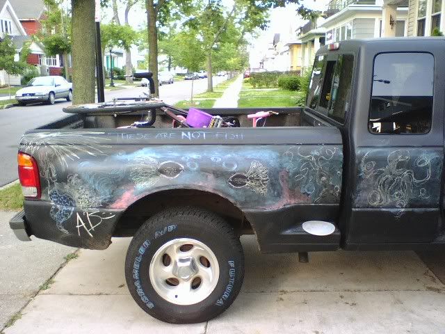

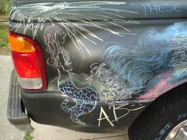

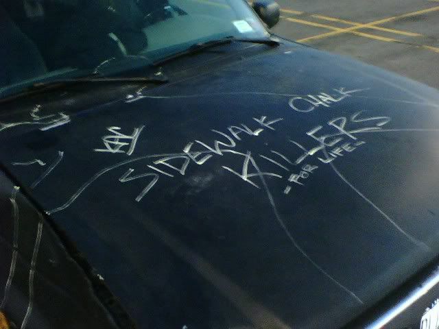

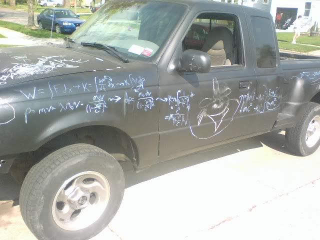

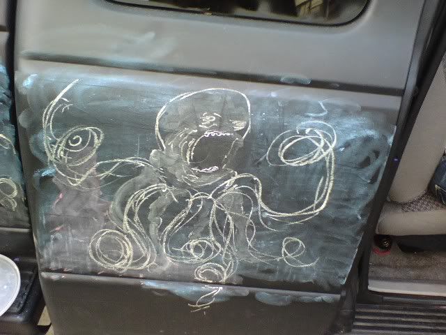

some of the "artwork" thats been on my truck since my friends discovered that you can draw on flat black with chaulk

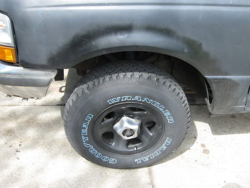

fenders

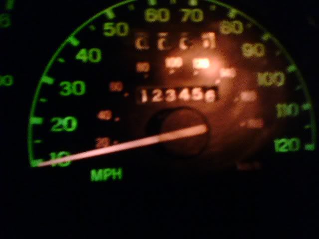

123456

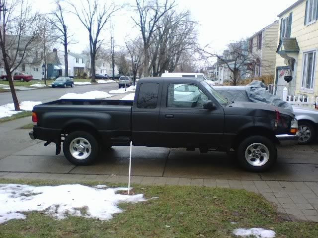

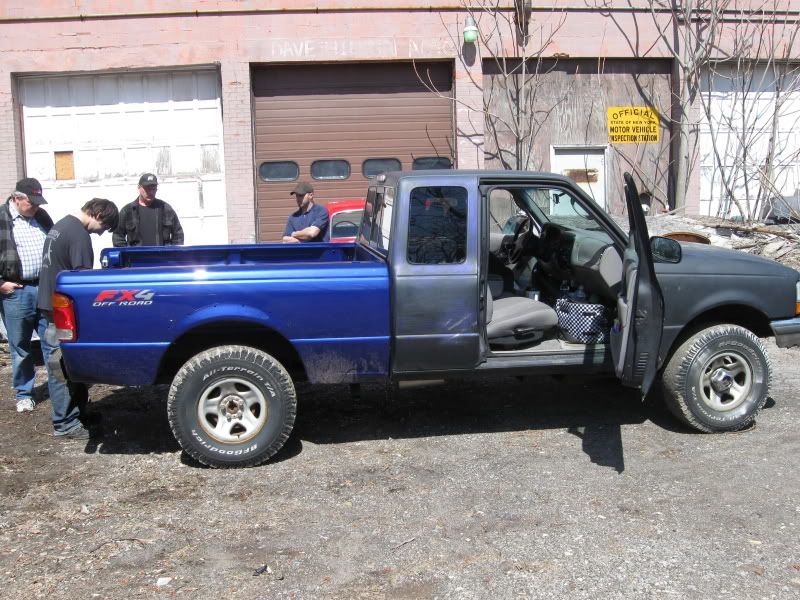

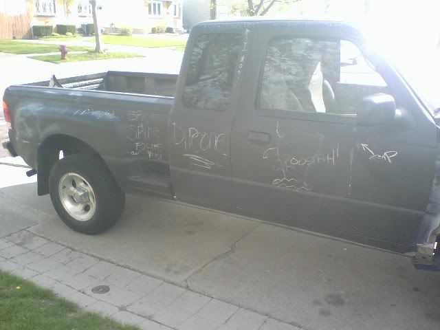

how the truck is right now

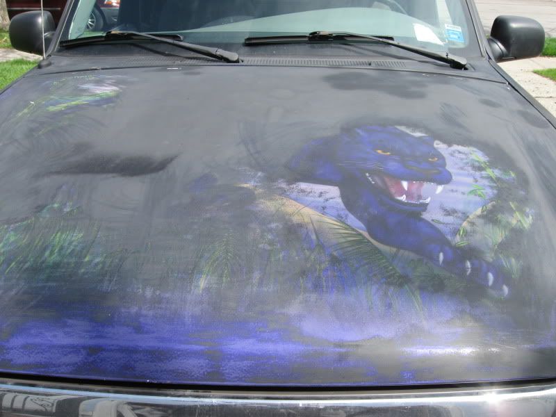

I still need a hood
If you were closer I'd trade ya hoods for shits and giggles...
I have a warped sense of humor so a panther on the hood would make my day :D
did you noticed the whole front passenger corner is fawked up?
Zman, you haven't seen my truck obviously :thefinger:
Actually I think the hood might be the only undamaged part on my truck :icon_rofl:

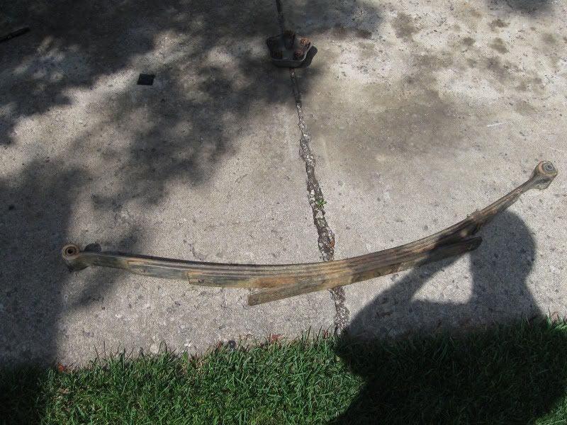

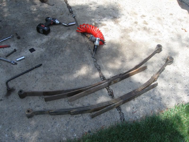

Swapped out my leaf springs yesterday. I had a broken middle leaf on one side, so I swapped for explorer leafs.
My 98 Ranger - the never-ending project
one of the new springs with the center pin flipped.
old on top(notice broken leaf), new on bottom
weird seeing the axle with no spring in the way

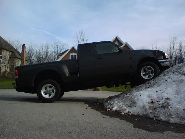

sits pretty good
With the explorer leaf springs in place of the rangers and the blocks, it sits about an inch higher.
It does ride a little stiffer, but in a good way. I would even say it handles better. The bit of axle wrap it had from the blocks is gone. I highly recomend doing this.
