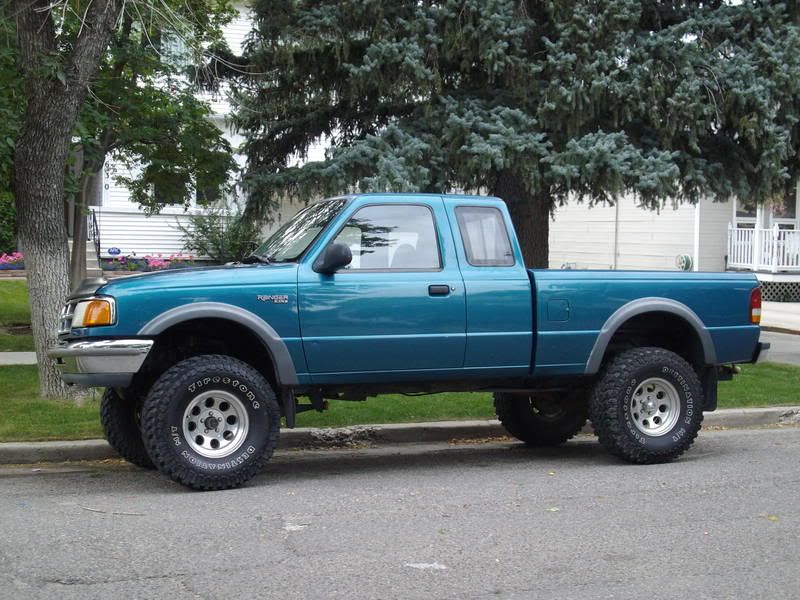

When I had my '97 (same body style as your '94) I ran 6" of lift with 33's. I don't like the tires to look too big for the fenders. I like a little room to flex without cutting the fenders.
Here is a couple pictures.

dam man thats a nice truck, im definatly going with a 6 inch lift and 33's, looks exactly how i want it to, how was performance and mileage with stock gears? i think they are 3.73 right? also im looking at a extended radius arm lift, is it really gonna help flex more or is a cheaper lift fine? i dont plan on beating my truck to death but want it more capable then stock, one more thing what lifts will make it sit level and not the nose down and how do i go about the camber issue? stock bushings or on one lift i seen i beleive a tuff country it said at the axel pivots there is some kind of camber bolt? would the stock bushings work with that? thanks for any and all help, sorry for the run on sentences lol.

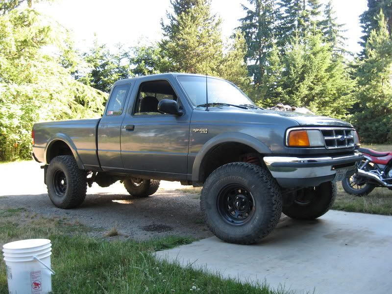

Hey, I agree with the 6" inch lift and 33X12.5's. Looks just right in my opinion. Here is my truck, 1994 4.0 5 speed with 6" skyjacker suspension lift and firestone destination M/T.

Man all three of the ranger are badass trucks nice work guys, mines a 93 extended cab 4x4 btw, i wish i had 1600 for that class 2 skyjacker kit but hell thats almost hwat my trucks worth :(. How is your guys fuel mileage after lift and bigger tires?
