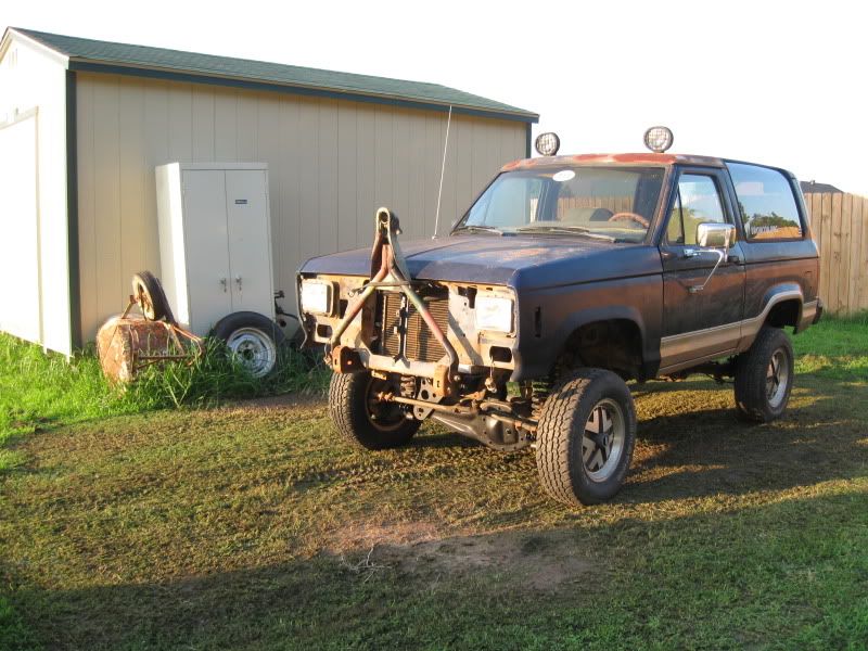

High school

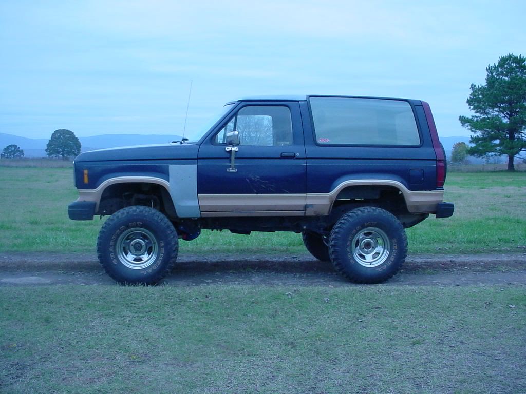

Short but sweet “play toy” stage
