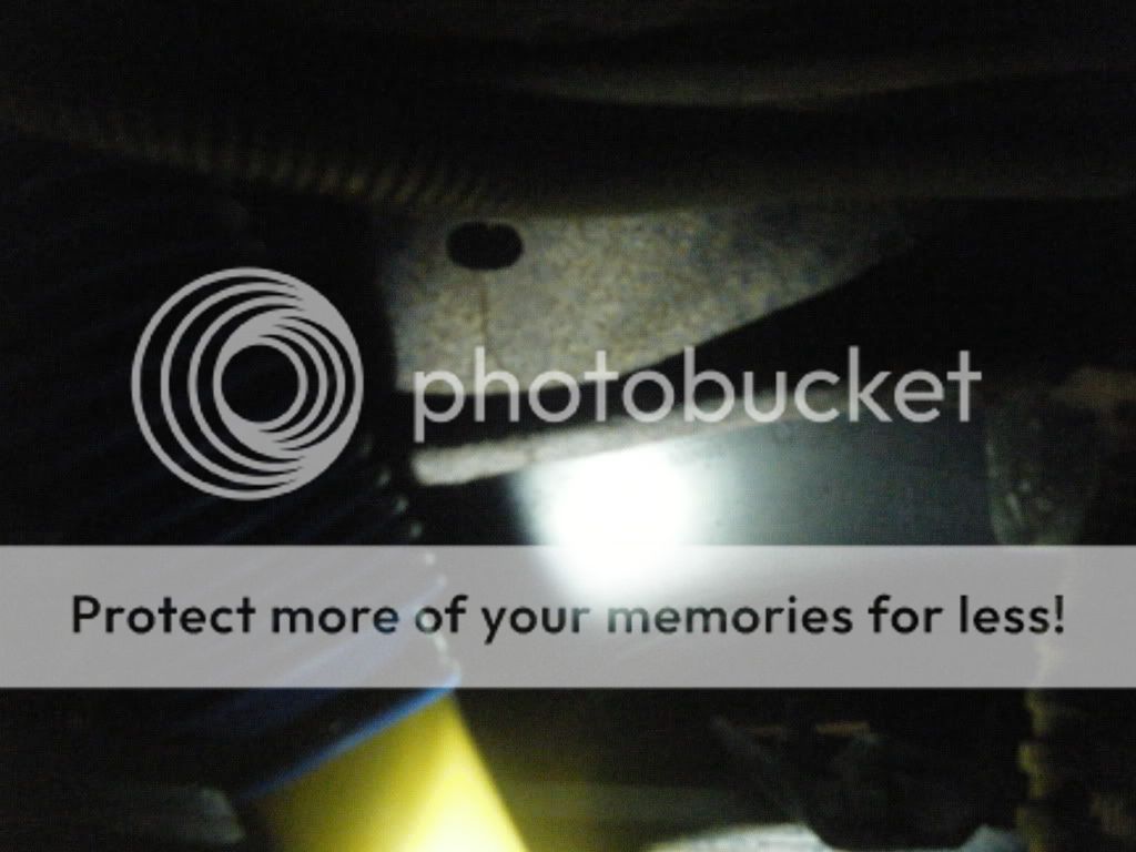

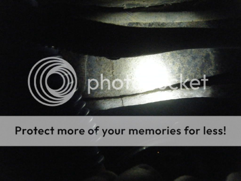

While installing my new Bilsteins I found a hairline crack by the drivers side upper shock mount. It's been about a week and half since i've discovered it and it appears to me that it has gotten worse. Before I throw more money into this thing i'd like some professional opinions as to what I should do. I hate to be out on the road and put others in danger or be on a trail and my frame just snaps in half. It hasn't cracked all the way up the side of the frame but it starts at the bottom and is getting progessively worse going up. How could I repair this, if at all? Here's two pictures. When I get it on a lift I will take some better pictures but that may be awhile. It only goes up the "O" in the frame you can see in the second picture and it's not visible when looking on the other side of the frame. The only thing you can see from the other side is the crack where the frame has actually split at.
The truck is only a 99 but I have replaced a section of the rear frame before and some chunks of the crossmembers have rusted out. The cross member across the gas tank is also rusted through pretty good on the passenger side where it's attached to the frame.
Well, what I would do is drill a 1/8 or 1/16 hole where the crack stops, to further prevent it from cracking. Vee out the crack clean it up good and have it welded, that is unless of course you can weld at the level needed to perform this repair, which respectively, most likely is not the case. Doubt it would ever return. And if it did, well, I would cut pieces of 1/8th and fishplate the frame front and back.

It looks like the crack goes through the flange and is already as far as it can go--it's too late to contain with drill holes. That thing is in big trouble. It will come apart quickly now.
You need to weld in a reinforcement. A piece of 3/16"T angle, as long as can fit in there to reinforce the bottom flange and go maybe 2/3 of the way up the side. I'll see if I can find a picture.
Edit: These are instructions for lengthening a frame. It's the same basic procedure. I would follow this. Just welding it straight up will cause it to fail again. I've had 2 former plow trucks with broken frames ('68 International Harvester and an '87 K30) and both were just welded and then broke again in the same spot and then retired.
