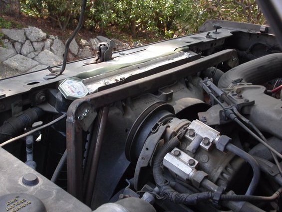

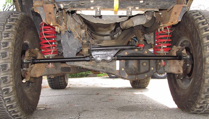

Yep, thats what I did on mine. The cable has just enough slack to let the tires droop together about 3-4" from ride height. This is so the onroad ride isn't affected.
You can see the cable in this pic, I'll try to get more pics of the 1x1 sq. tube I used to run the cable through.

4x4junkie, the underside of your BII is just plain wrong. I was just admiring the neighbor's BII because its only starting to get cancer unlike mine which is end-stage. All I have to look forward to is global warming I guess. And then everyone from Cali will move north because it will be too hot.
Anyway, between JohnnyU's repsonse and that picture, I completely get it. Thats pretty smart. I was climbing the right-of-way on my property and the nose lift was just unbearable. I don't have rear shocks on right now so that doesn't help but I could feel the scissoring effect pretty good.

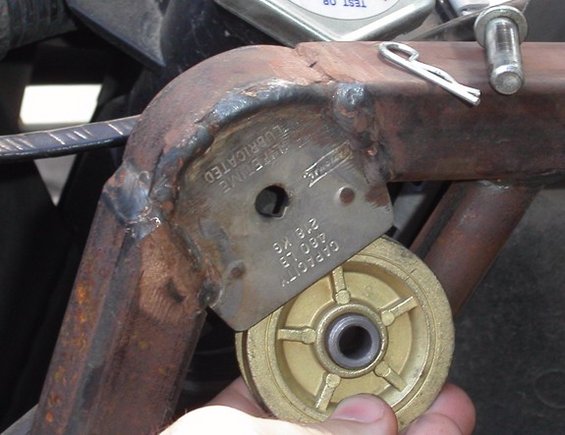

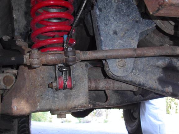

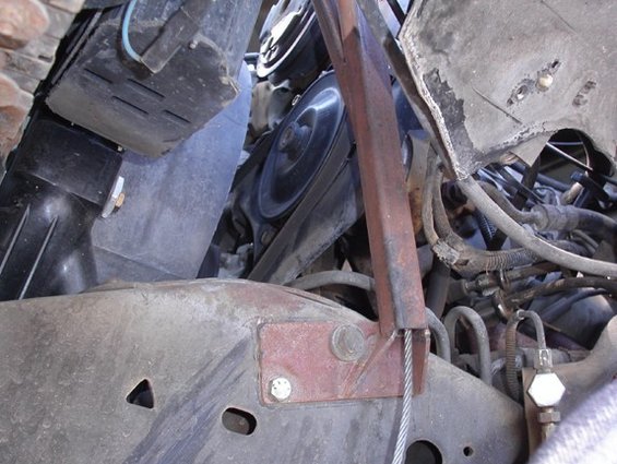

Anyway, here's some more pics:
Pulley
I just welded the 1x1" tube straight to a couple of common 2½" hardware-store pulleys. Just make sure they have metal wheels (not plastic)
(the ones I have say National on them)
The cable is 3/16" stainless I got at the same hardware store (I've seen this at Home Depot as well).
The brace on the side adds lateral stability to the whole thing.

so, are they pullies welded in place and don't move, the cable only slides on them?
it looks like you mounted the cable on the front of the beam where the sway bar would have attached...it that it? got any pics of how you mounted it?
