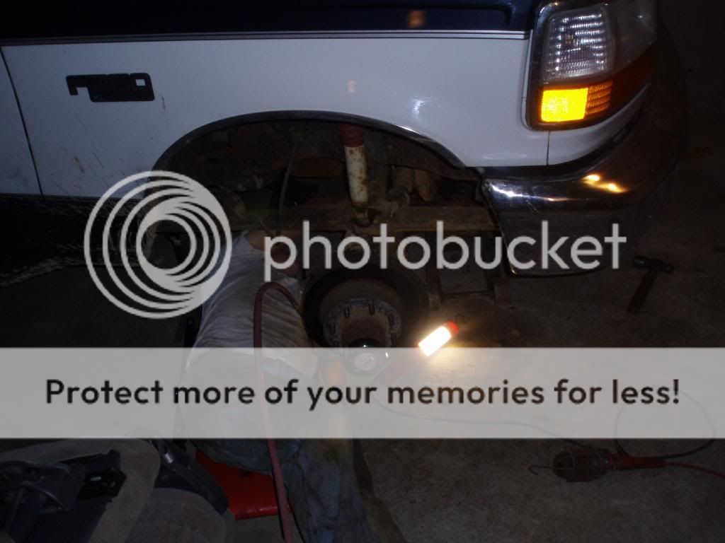

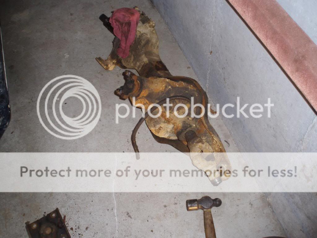

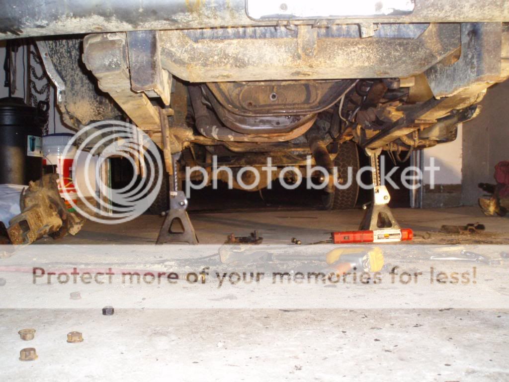

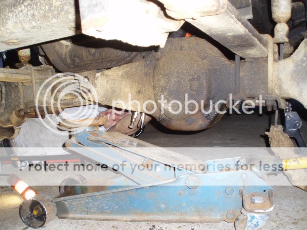

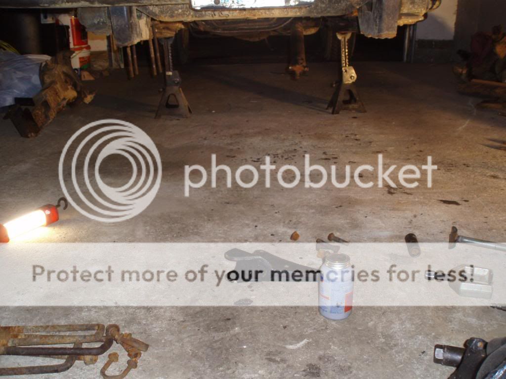

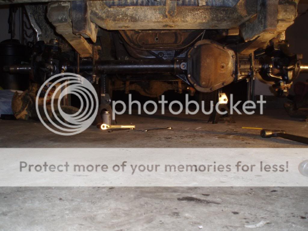

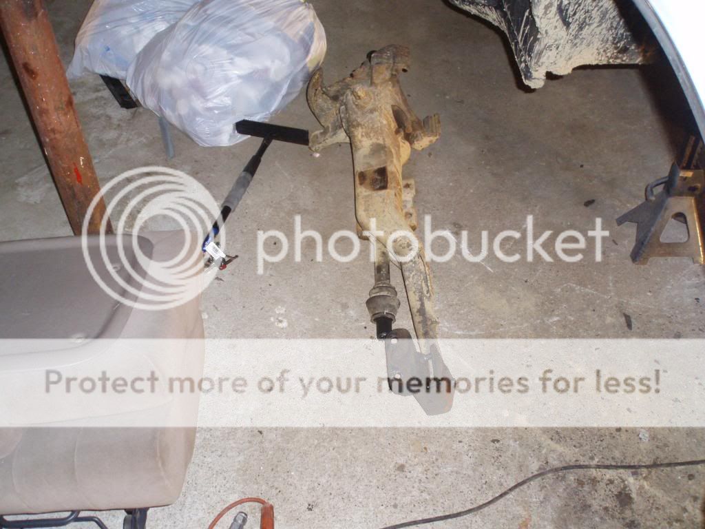

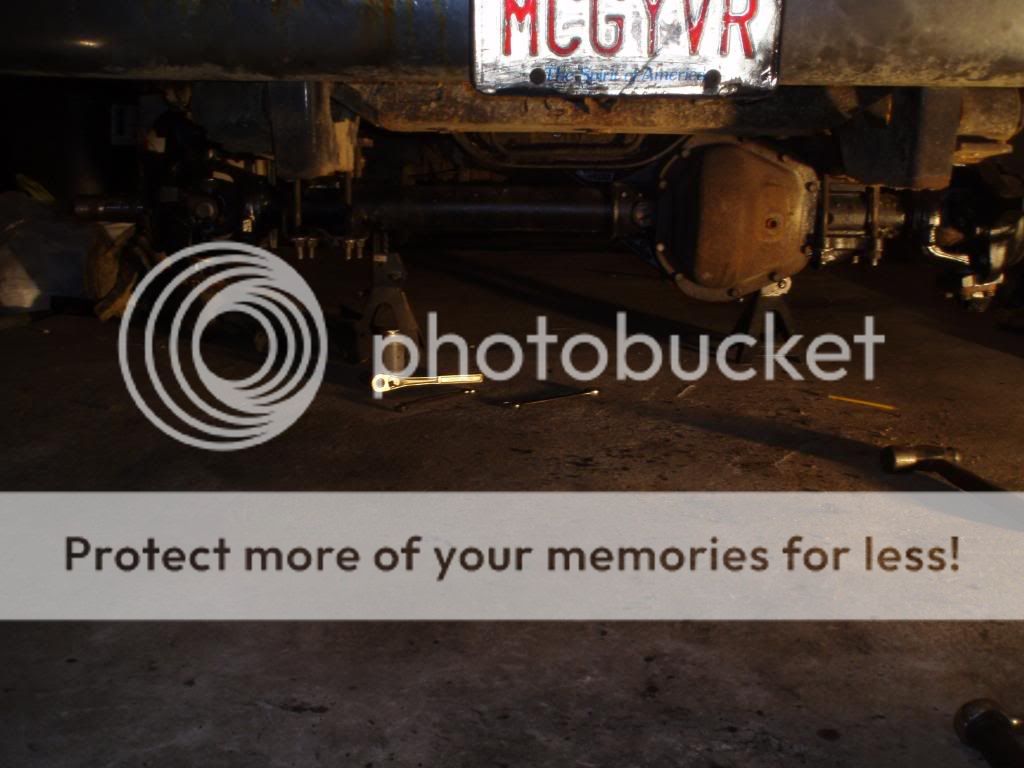

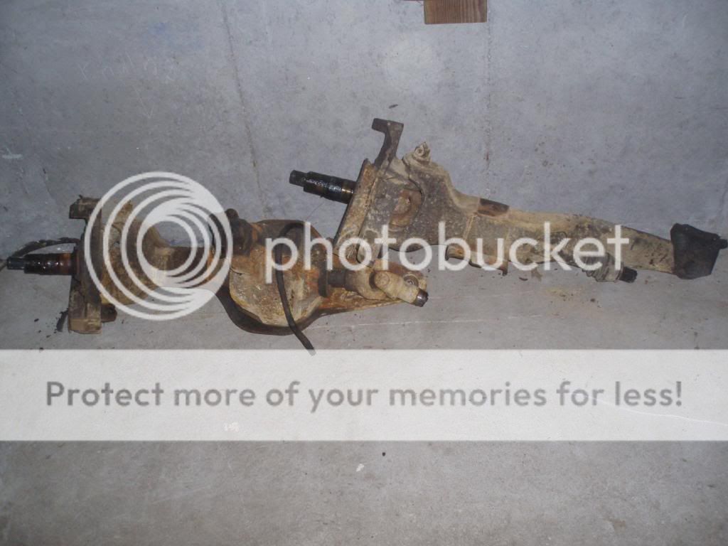

I'd like to find someone whos done a SAS on a Fullsize Ford.
Sas for 1983?-1985 F350s, and 1983-1997 F250s.
Support truck by frame,
remove brake calipers from knuckles and wire to frame out of the way,
Unbolt front drive shaft from axle,
Unbolt drag link from pitman arm.
Unbolt TTb from leaf springs
Unbolt pivot brackets from frame
Dispose of TTB.
Install trac bar bracket on frame, 3 bolts.
Slide axle under truck, bolt up to leaf springs.
Install trac bar.
Attach draglink to pitman arm
Install calipers on D60 knuckles.
Drive your now solid axle truck.
Note.... I also swapped my hubs/rotors from my TTB over to my D60.
