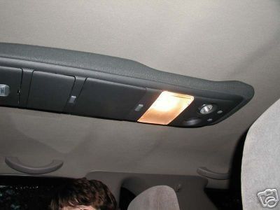

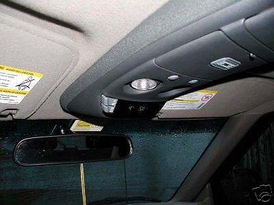

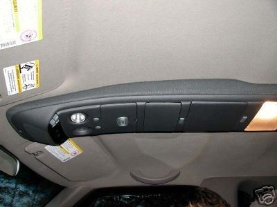

So i went to my local Pull a Part yesterday looking for a explorer overhead console, and couldnt find any as we all know theyre popular as well as the dissapearing sliding back glass for the Ext cab. So as i was walking out, i came across a 1998 Blazer with a full overhead console with 4 map lights, courtesy lighting, Temp, Compass, MPG AVG, Tank Range, avg speed, 3 door garage door buttons built in, CD compartment and Sunglass holder. I always thought it would be nice to have one of these in a ranger, so i grabbed it and got away for less than 5 $. The consol is in perfect condition and i cut off the wires between the Clips and the main wiring harness. I placed it up on my headliner and it looks like it will fit well. Tomarrow I plan to wire it all up and mount it. Im planning on writing up the entire install for the rest of the forum members. Though its a chevy part, it seems to fit well and t wiring is almost the same as the explorer wires and It has wires to go to the Data system in the computer. Im looking into finding a way to get this hooked up so i can get the AVG MPG and such to work. I will keep you all posted and heres some pics of a close match to what i have.
