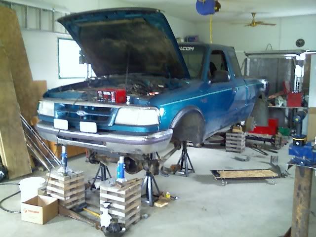

I've got an EBD44, and am still workin on swapping it in. It's gonna have crossover high steer running OTT style arms, with 1.75'' DOM tie rod's and Chevy 1 ton TRE's. Gears are Yukon 4.56's, still waiting for some shafts, and front is open for now, goin with an ox locker when I can afford it.
And the current sad state of affairs....both front and rear axles are now lyin in my DD awaiting rebuild, and the shop's a lil cleaner thanks to my dad...:temper: I'll have to grab some new pics of my 5.5" chevy leafs when I get a chance. :yahoo: Anyone need a detroit locked 28 spline 8.8?

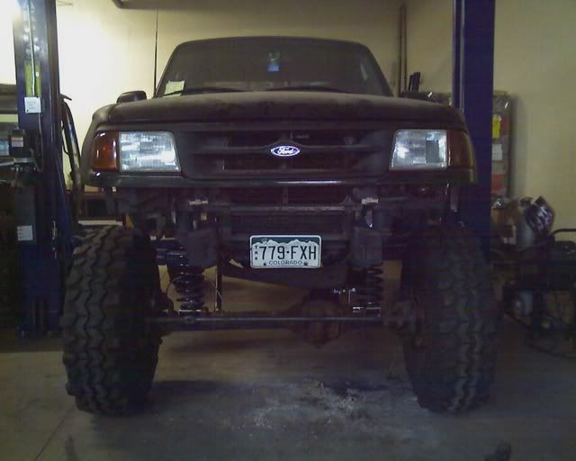

Almost done, late 70's F-250 HP Dana 44, narrowed to waggy width, converted to 6 lug, chevy flat-tops.
