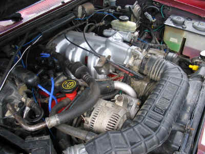

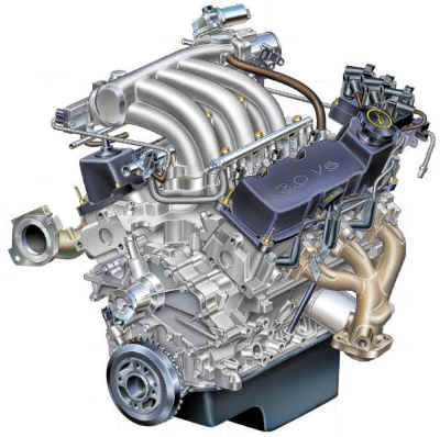

They are fairly distinct engines.
the 2.9 has 2.9 Fuel injection written right on the plenum.
The 3.0 as viewed from the back
The 4.0
I could take a pic of an extremely dirty 3.0 if you want an actual picture of one.

if it is pre 95 the 3.0 will have a distributor instead of a coil pack which is a dead give away.

3Ls have several different intake configurations.
Read the valve covers, or VIN engine code "U".
