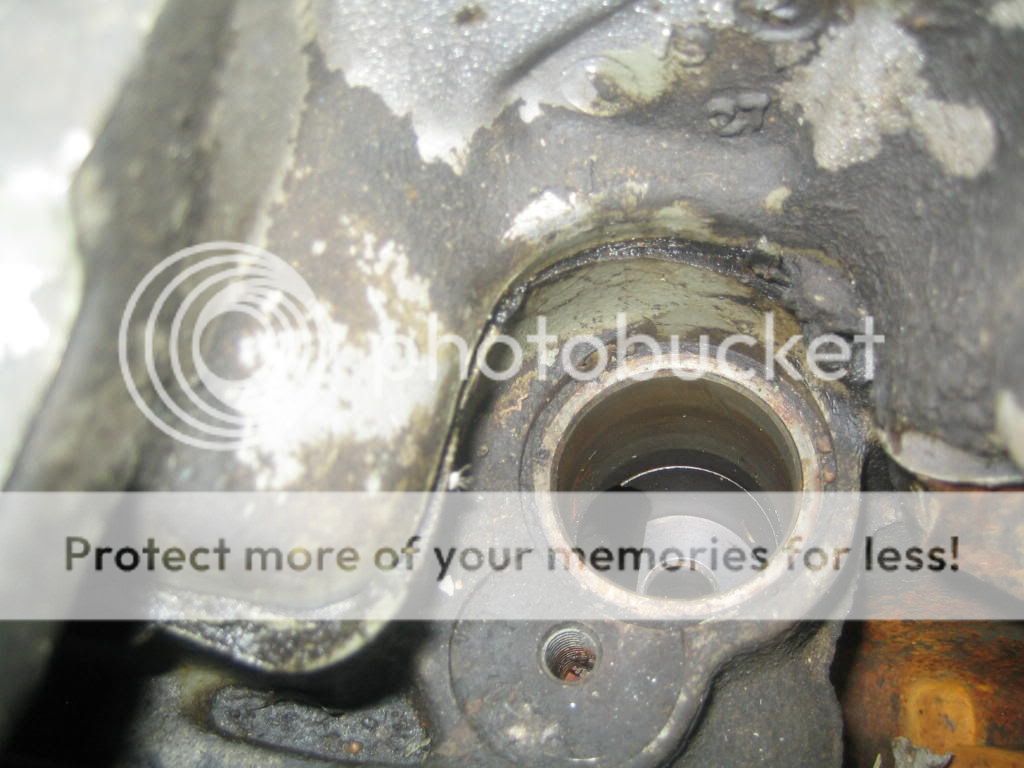

Step 2. If not already un-installed, loosen and remove hold down clamp before removing Old plug or broken/malfunctioning cam-synchro.

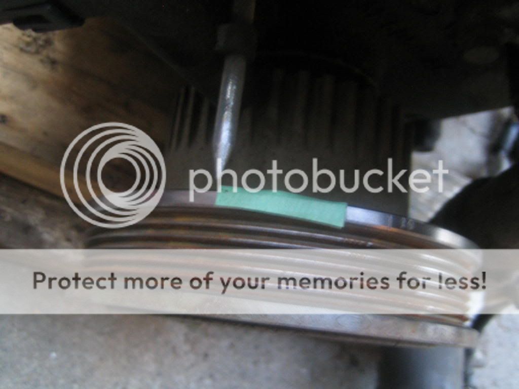

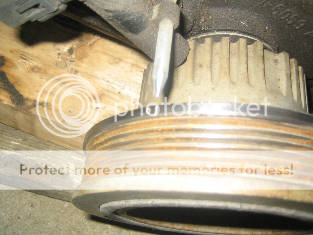

Step 5. Using the ruler, cut a piece of masking tape 34mm long, exactly.
[/IMG]
step 6.
stick tape on the left side of the line on the crankshaft pulley and turn engine clockwise until the timing needle points at the end of the tape:

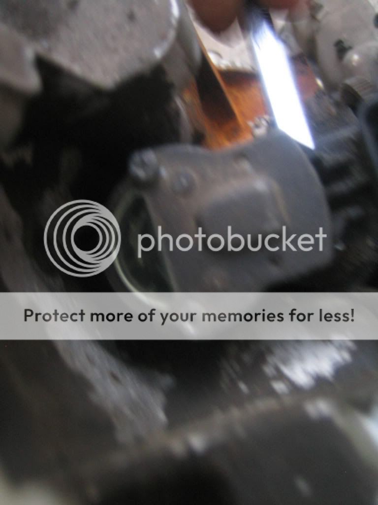

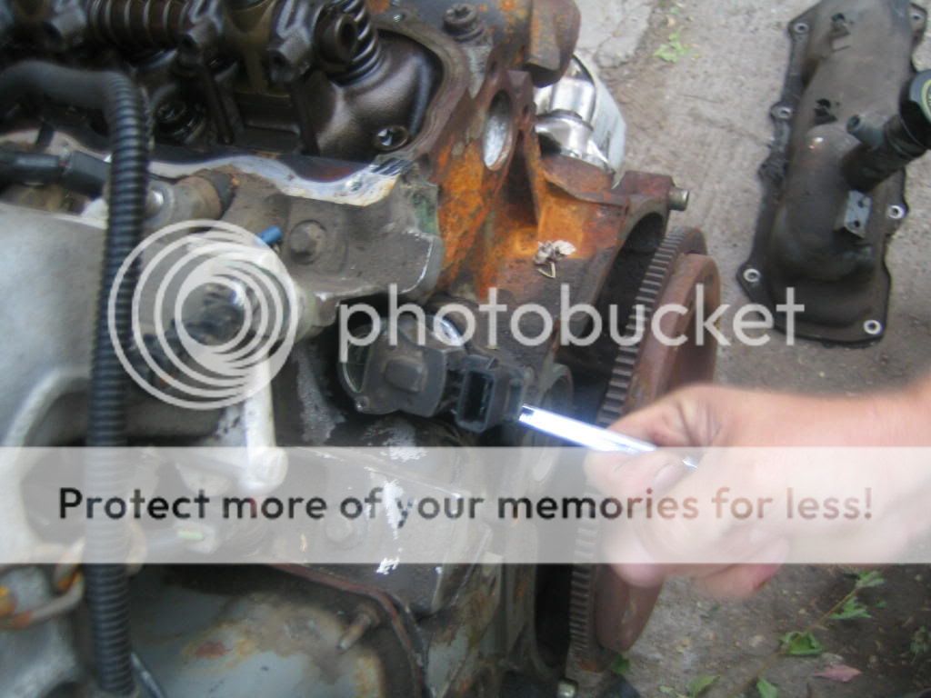

Step 7. Insert cam synchronizer into its socket in the back of the engine, at a 90 degee angle to the back of the blcok, with the c shaped piece pointed open end towards the driver side and on the far left mark.
since the gear is hylical, it will rotate as it goes into the engine and hopfully slips right into the oil pump. drive gear. If it does not, try wiggling it around it should drop in. replace hold down clamp, and make sure c shape lines up with the far right line on the sight glass now, perfectly, then tighten hold down. plug in and your done.
