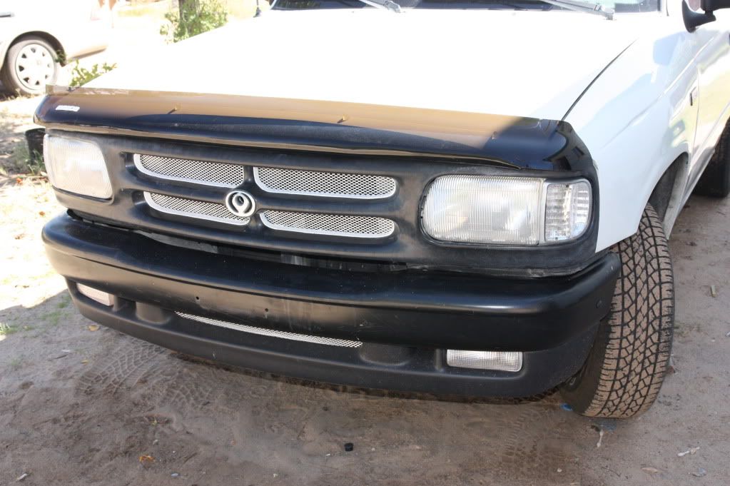

ive always been irked that there were so many ranger grilles, but none really along the btruck styling. so i stumbled upon the wire mesh grille mod and thought i would try it out for my mazda truck, hopefully keeping the only htings that make it a mazda, the headlights grille and taillights. heres what it looked like installed... also i put on clearcorners (from ebay) and the clear lens turning signas... i am trying ot get rid of all chrome and make it black and white. also it has a bug deflector which i glues a painted white emblem on it.
http://i875.photobucket.com/albums/ab320/npentyl/IMG_8611.jpg
http://i875.photobucket.com/albums/ab320/npentyl/IMG_8612.jpg
http://i875.photobucket.com/albums/ab320/npentyl/IMG_8613.jpg
http://i875.photobucket.com/albums/ab320/npentyl/IMG_8614.jpg
http://i875.photobucket.com/albums/ab320/npentyl/IMG_8615.jpg

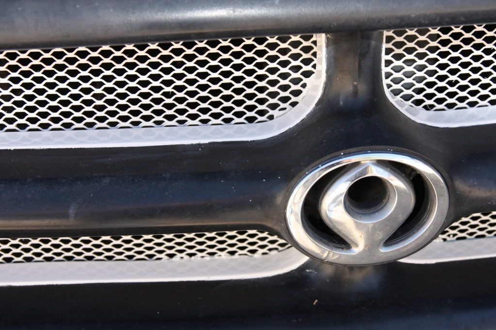

also you may notice that i painted that little ridge on the inside of the grille, it was an interesting effect, and i think it looked cool... so all this was done with some white rustoleum paint on some wire mesh for rain gutters, sold at lowes. it was bent onto the grille form the inside and thenglued on and it holds its shape.

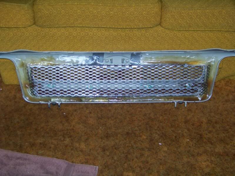

i used fiberglass cloth/resin along with 3 small bolts. here is a link to one of my cardomain pages that shows my grille. its doing fine, i dont recall when i did this mod, but its been done a while now. link-> http://www.cardomain.com/ride/3216869/5

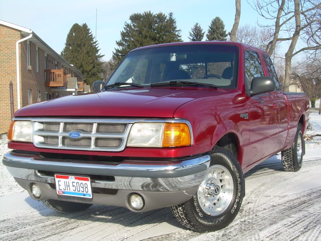

On my Ranger I used hot glue. Kinda funny, but it does the job and no one has to see the back of the grille!

here is a pic of the backside of my grille after i added the mesh, i used fiberglass cloth and resin along with 3 small bolts.
