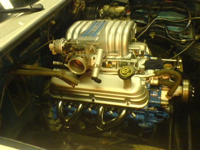

Shelby tri-Y headers for '65-70 Mustang.
They're chrome, and cost $150

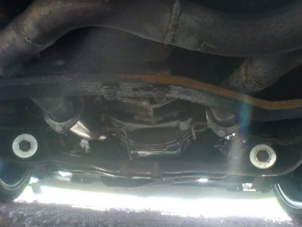

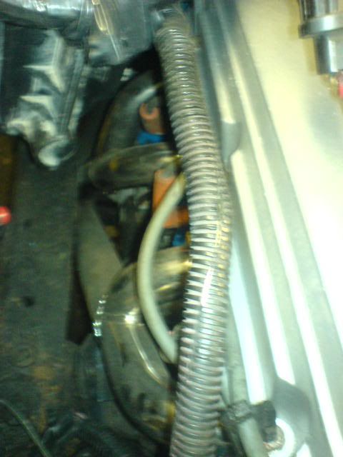

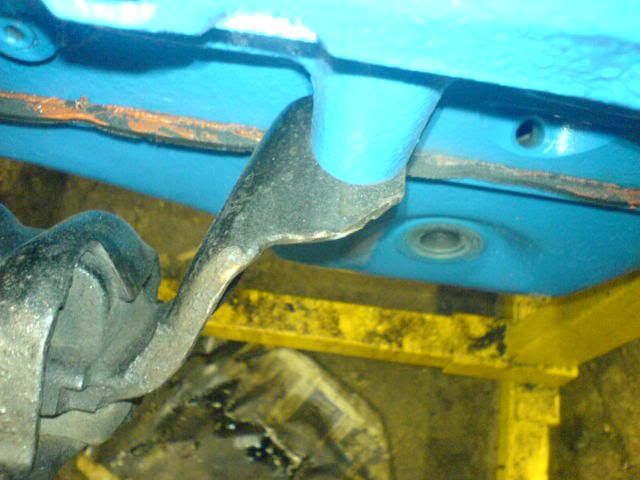

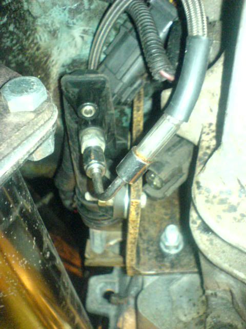

Fit perfect. They clear the frame, starter, belhousing, clutch slave and steering with ease. I trimmed a slight corner of the motor mount plate (while on the stand, stock fox vert/ sn95 5.0 mount), less than 1/4".
Here's the mount I trimmed:
Driver's side:
Passenger side:
Here's an underneath view:
Driver's side/clutch/header:
