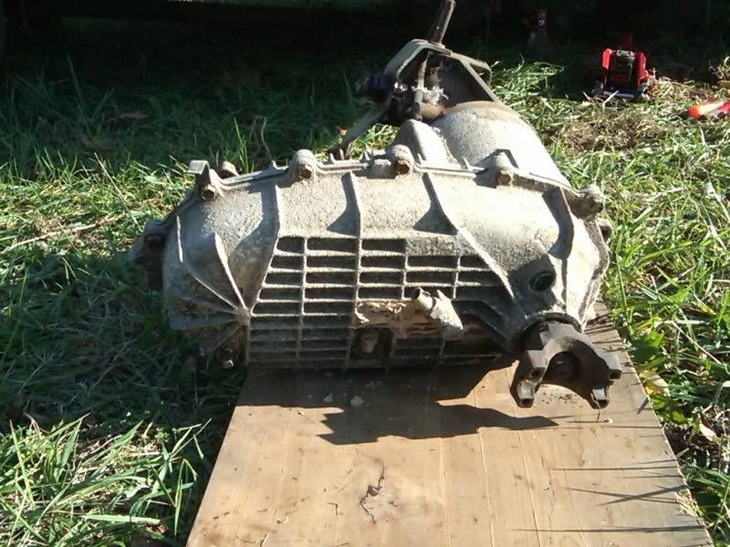

Anyone able to help id this transfercase? borgwarner something i believe? i have the id tag numbers but it really helped none..

Well early this moring i got a little bit of work done. I found the tag on the back of the transfer case in the '86, its a NP208. So from what i remember reading, the BW1356 will be the better more reliable case out of the 2.
So that being said, i got the BW156 t-case cleaned all up and got a few fresh coats of paint laid down, new trans mount bolted up, and a new vent hose in place. Cleaning and painting have by far been the most time consuming steps thus far in the swap. I offically hate baked on mud! Anywho, i did get a pic for the day:
