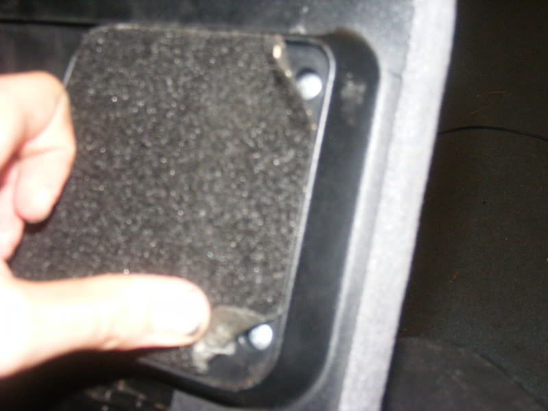

2. Either peel the felt off the top and bottom or just the 4 corners on both felt pads.

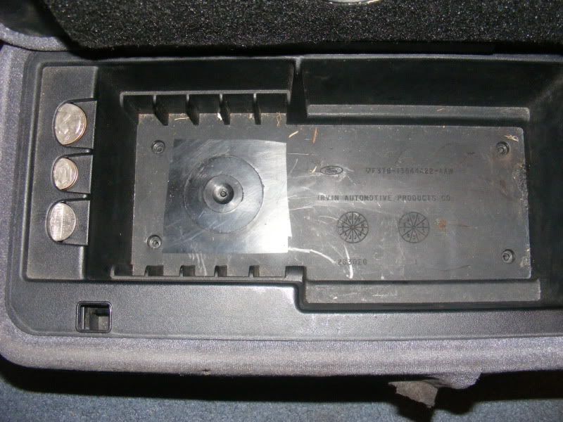

3. Remove all 8 screws(4 on top and 4 on bottom).
4. The top part and bottom piece should now easily come off, remove them

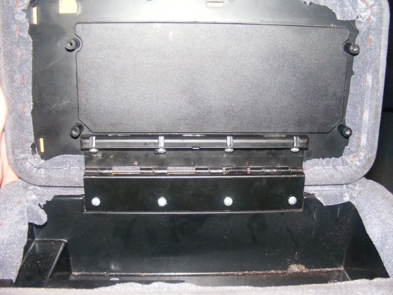

5. Take out the 8 screws holding the hinge in place.

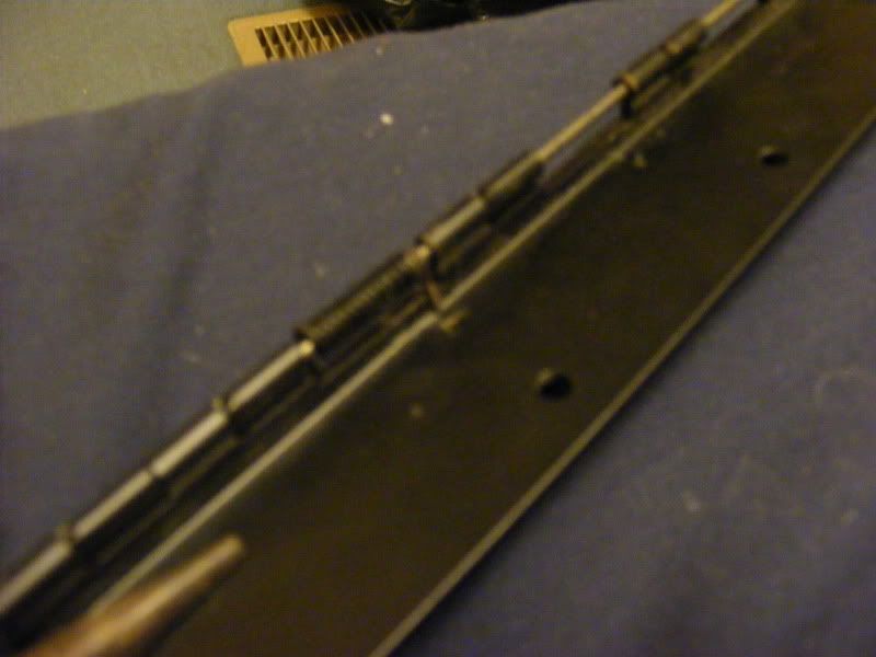

6. Insert a small punch in the end of the hinge and hammer it out a little bit, the use pliers to pull the rod out of the hinge(one side of the rod is painted black and is hammered flat, use the punch in the opposite side)
7. With the springs out, you can put the rod back in by itself and reassemble the whole console and it wont force itself to open or close.
8. If you want the console to have pressure holding it closed, insert the rod till it is halfway poking through the first spring slot.

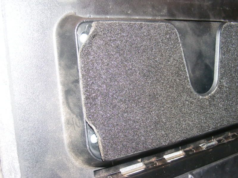

9. With the bracket in the CLOSED position, put the spring back in place with one tab of the spring on the TOP of the bracket twards the side you are inserting the rod.
10. Using needlenose pliers, bend the spring around so will pushing UP on the BOTTOM piece of the hinge.
11. Still holding the spring loaded, have a friend push the rod in with a hammer or pliers so it slides through the spring and into the next part of the hinge.
12. I reccomend only putting one spring in, it has plenty of push to keep the lid down firmly. Push the rod through the hinge the rest of the way, and reassemble the console. C clamps or vice grips will help with reinstalling the hinge onto the cover, put the screws in the top of the console, then the bottom.
13. Press the felt back down or use glue to stop edges from curling.

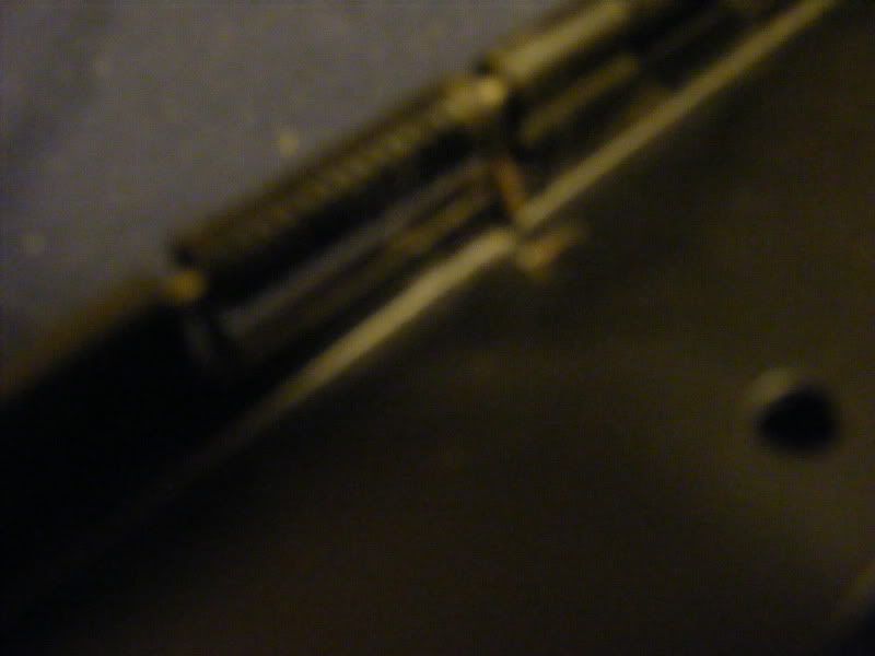

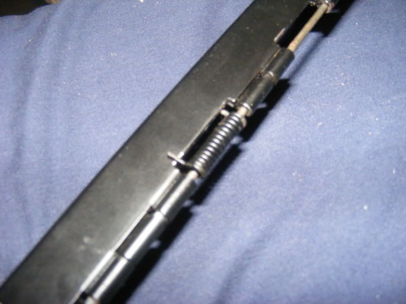

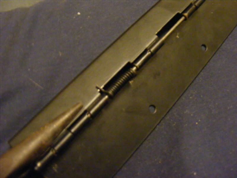

No, i was merely tinkering with my console when i did this, and didnt care if it broke. I can take final pics of where the spring is and whatnot, but it was a pain getting that spring in place. Ill post a few pics in an hour...
DarkMax
U.S. Military - Active
Nov 30, 2009
41
Cocoa, FL
2.3L
Pictures added, however all images are AFTER the one spring is added and reversed. There is normally 3 springs in the hinge before you disassemble it.
