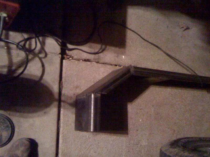

showing the ends

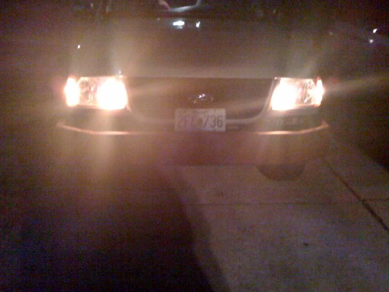

hard to tell here but the middle is cut from the back except where mounting brackets are to be located to reduce weight

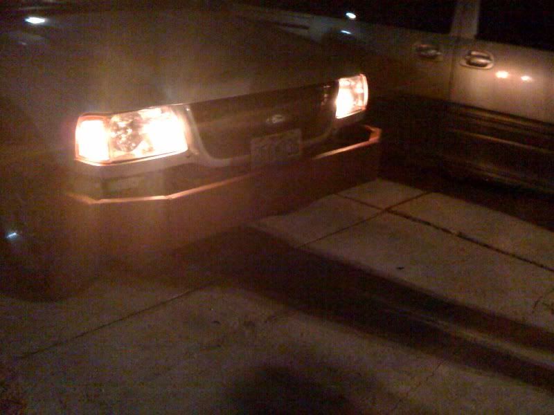

no ididnt paint it rusted red that is rustolium metal primer

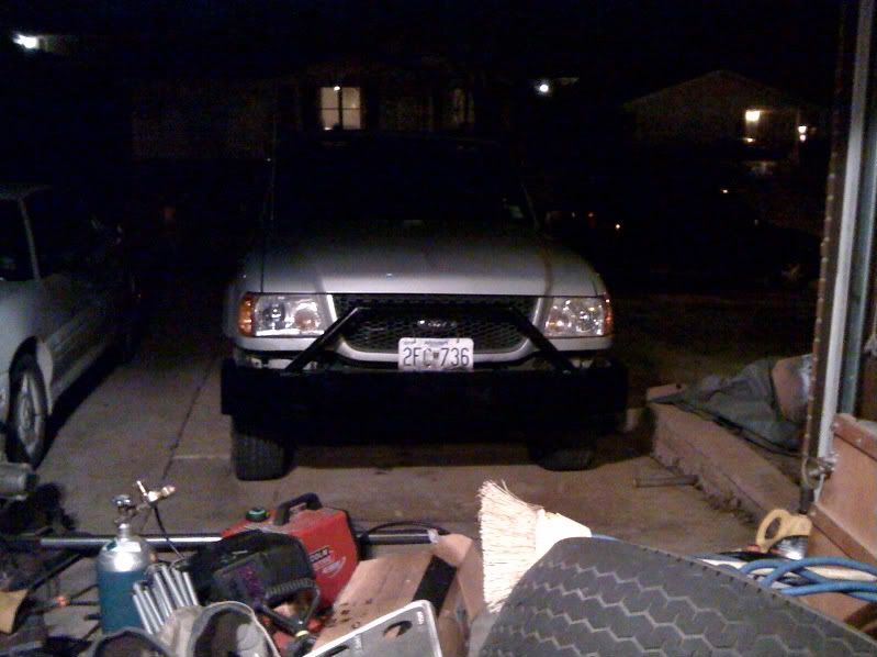

up bar/ grill guard

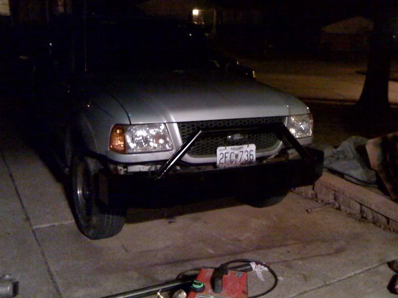

i like it but thats my oppinion. id like some input from others too, but please if you wanna be a dick keep into consideration that two 18 year olds fabricated this after school working 3 hours a day for 3 days.
hey that looks pretty good. im currently working on a model in solidworks for a bumper for my 89 out of 1.5 square tubing. good looking bumper for a couple of damn kids lol jk (Im 19 and a freshmen in college)
the mounting isnt finalized yet, i just gotta wait till i have the $ to buy enuff diamond plate to enclose the top. and the final mounting brakets will suck it back closer and higher
I agree looks good the gap needs attention and pull it in and are going to mount winch on if not then find some kind of rubber to put on it so if you need to you can push with it
Good work, looks solid.
Does look good and solid, but I think it'd look better on an earlier year. Something with a boxier front.
Hey its a first gen bumber give him a break he will look at it and say hmmmmm why dont I cut it here and shape here It will come to him I like it for the first bumber hes made keep up the good work and keep trying diffrent things the only person you have to make happy is you
