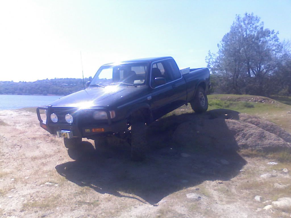

Purchased in late 2006 with 165,xxx miles. Its a 1996..well who cares look at my sig. Goals are for it to be really capable offroad, but still be extremely drivable because I commute 50mi per day to school and work. So for now the mods include things that wont kill my mileage too much. However I'm not opposed to skid plates and sliders etc. Eventually maybe it will get a cummins 4bt turbodiesel & solid axle after the current motor dies and I get another commuter. I will add pictures slowly tho I have them all. Feel free to ask questions. Currently it has 246,xxx miles.

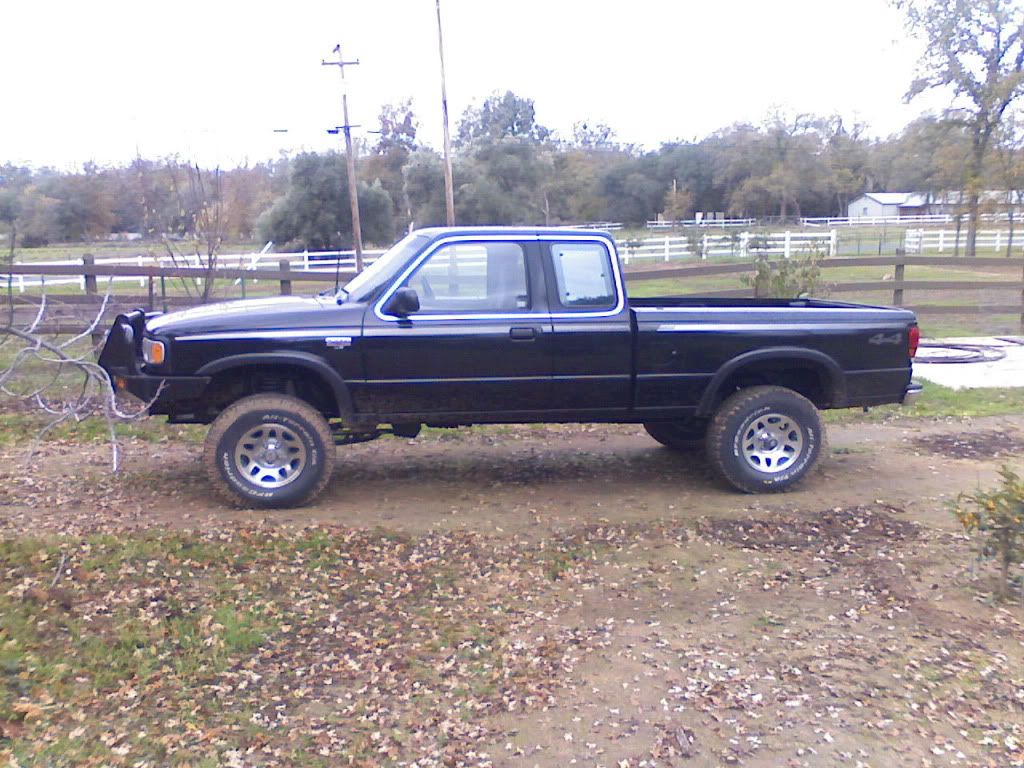

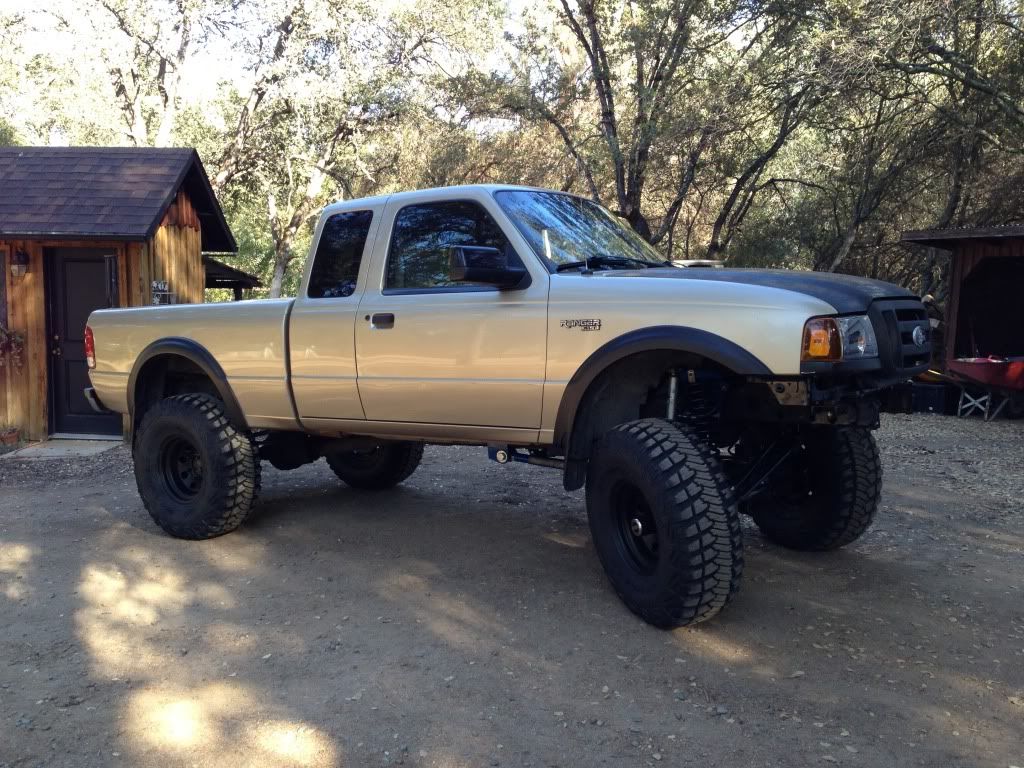

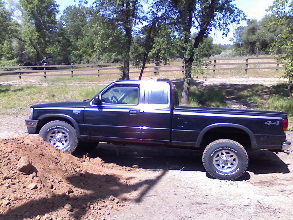

Had a minor roll over so now it has a 2000 Ranger cab and bed on it as of 4/1.

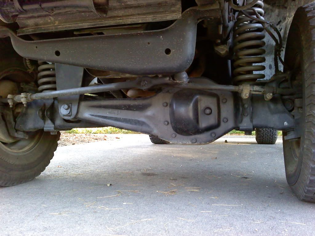

Swapped in my HP44 I've been building the last 18 months:

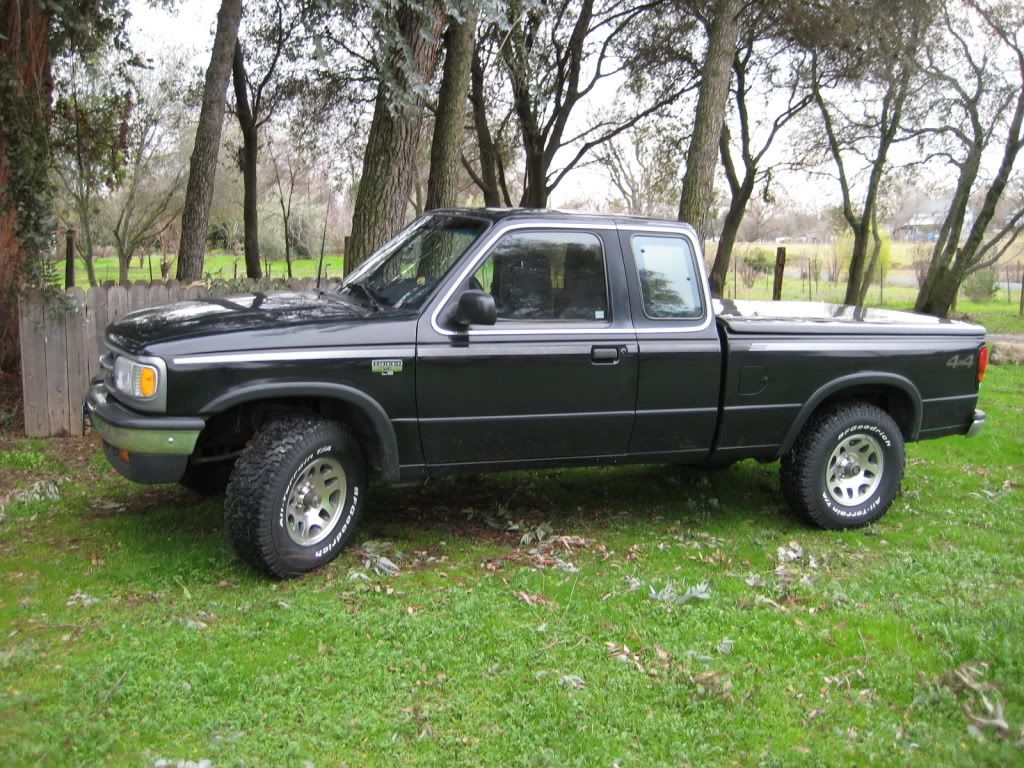

Current picture:
Project 4x4 Commuter Mazda

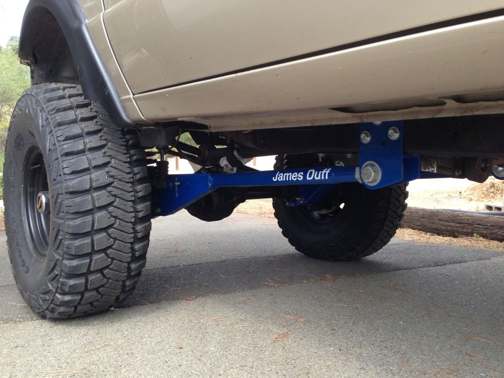

James Duff TTB/EB Coil Buckets

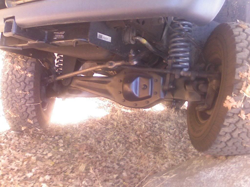

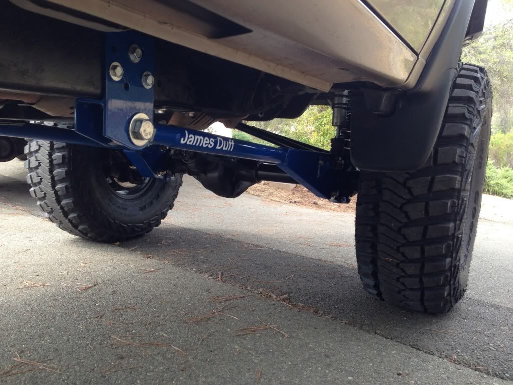

James duff radius arms,
HP narrowed '78 Dana 44 w/4.88's and Aussie locker

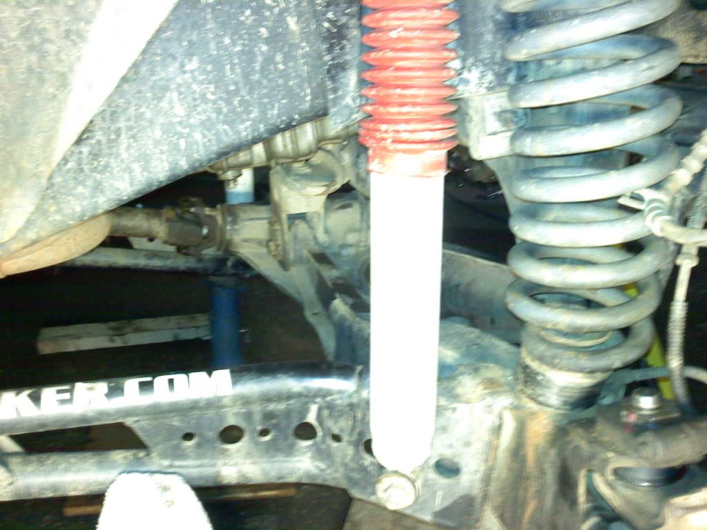

Bilstein 5125, 170/60 valved 11" travel Shocks w/Daystar shock bumpstops
BC broncos 5.5 early bronco linear coils

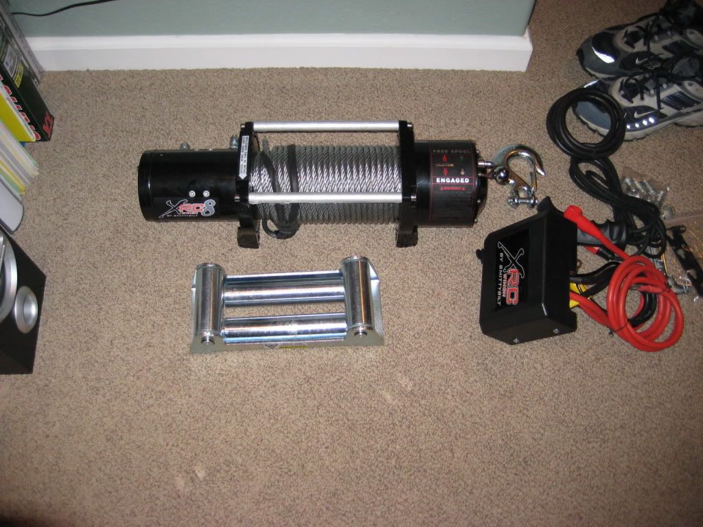

Smittybilt 8k winch, underhood solenoids, in-cab plug in
80' of Amsteel Blue 5/16" synthetic winch line, rock guard, heat guard, black safety thimble, thimble isolator, Spydertrax offset hawse

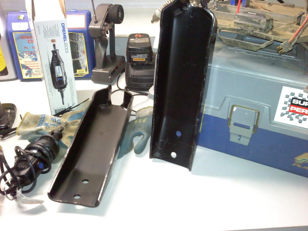

Clearanced middle crossmember for 1pc drive line (see pics)

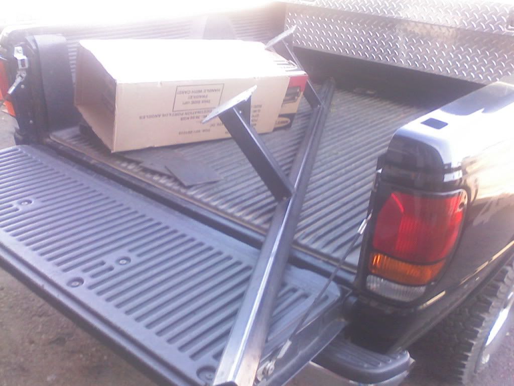

Custom rear bumper (high departure angle, and swing out tire carrier)?

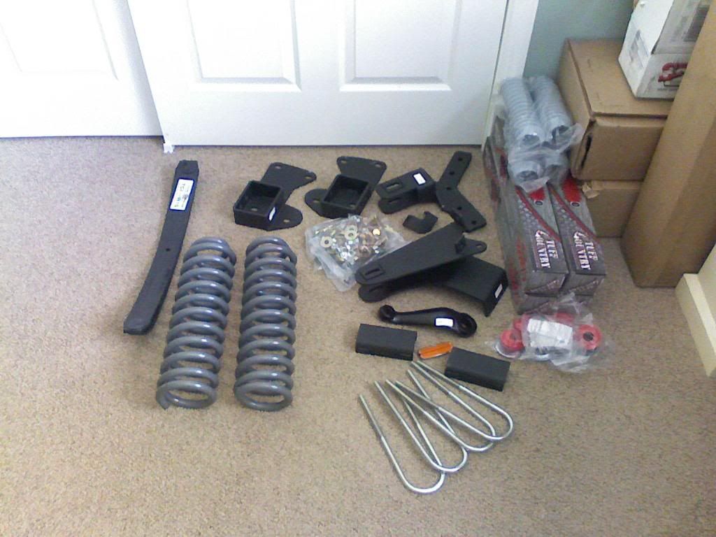

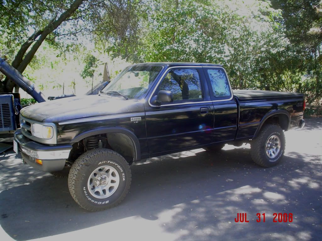

Tuff country 4" kit purchased summer of 2008. Front is lifted with drop brackets and taller coils, rear is lifted with an add-a-leaf. After lift install the front was taller than the rear so I purchased some beltech 6400's and then it sat PERFECTLY level. Included shocks were on the short side and rode like crap (nitro gas charged eww).

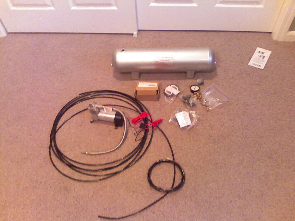

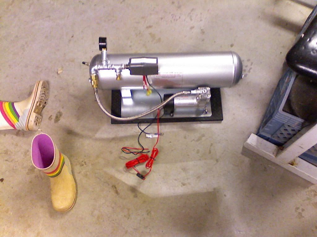

Air setup for on board air. This all would go in my tool box later down the road.

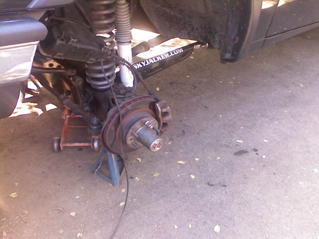

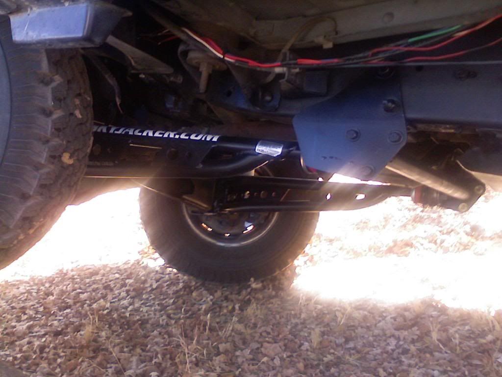

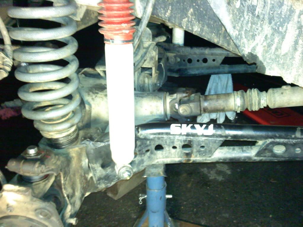

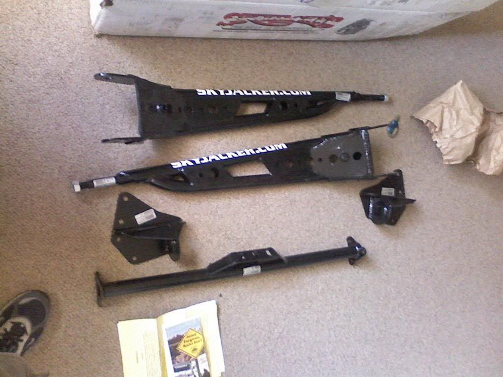

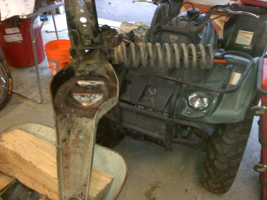

I soon realized i "needed" extended radius arms, plus they look so cool on jeeps i told myself they would be worth the steep price tag. Guess what, they were definitely worth the price for the additional flex.

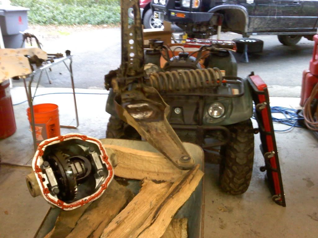

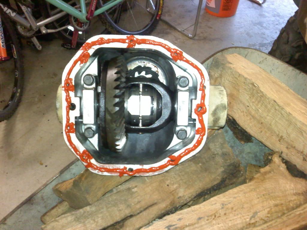

Added a "RuffStuff Specialties" Diff cover (has held up awesome, I go out of my way to try and trash it):

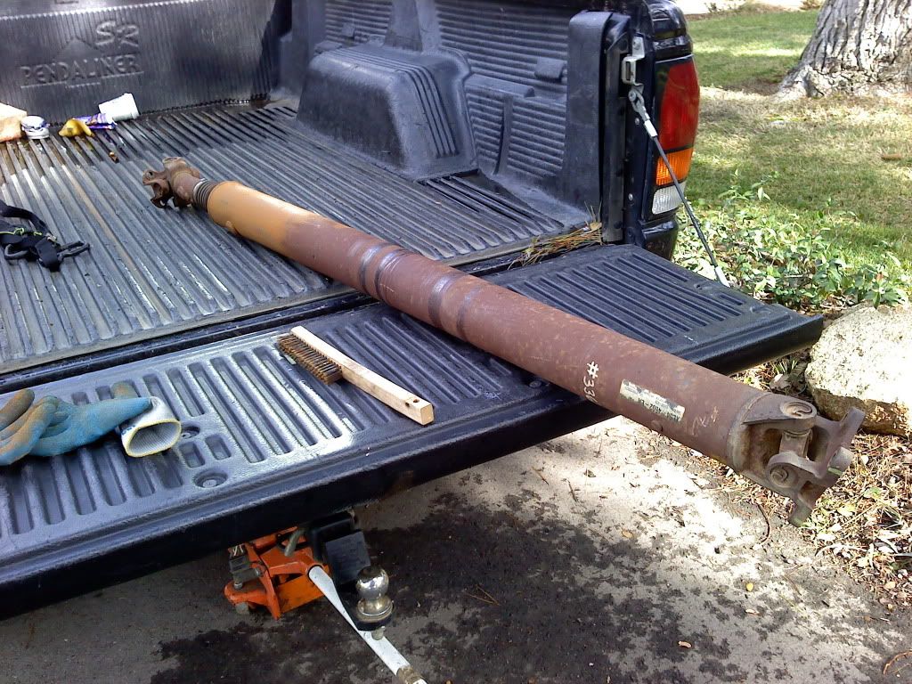

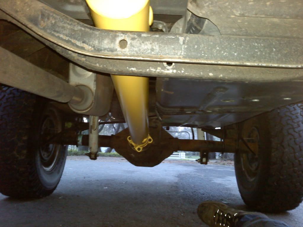

Rid my self of the two pc:

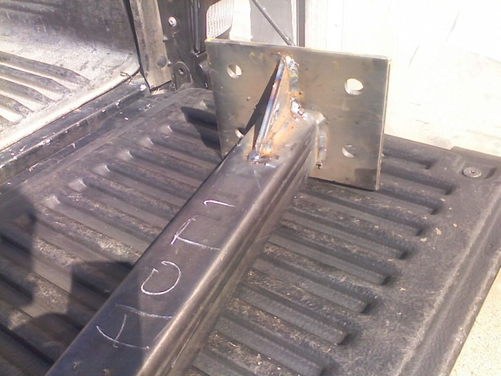

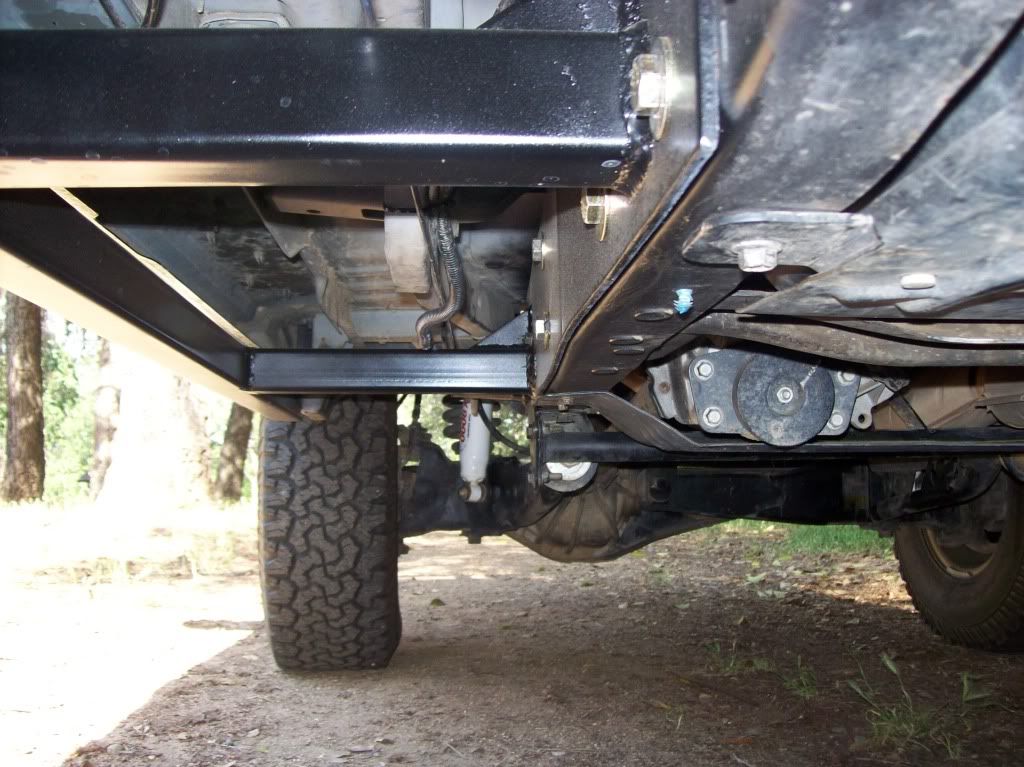

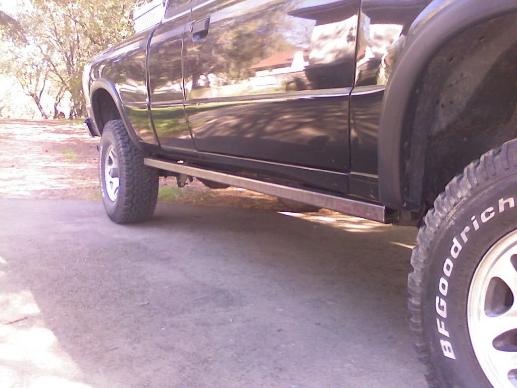

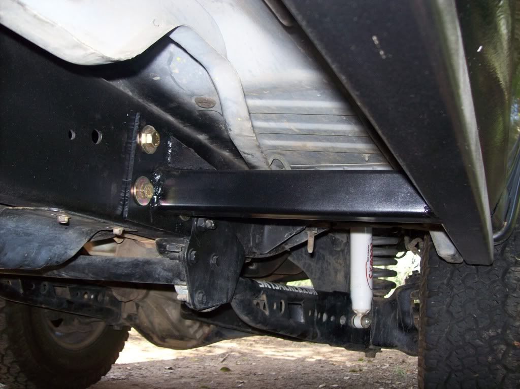

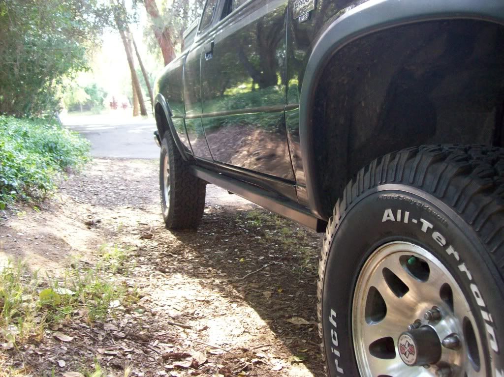

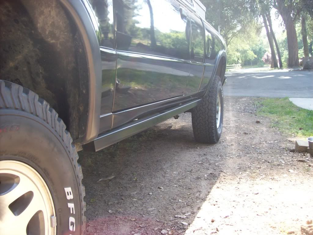

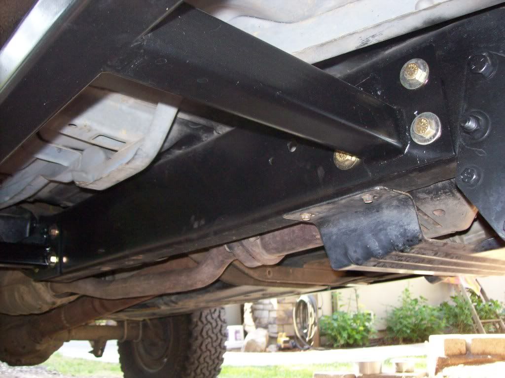

Started fabbing sliders. Later down the road I will plate the bottoms with 1/8" to ward off rocks, and add support gussets to the sides. But for now they serve me well and arent too heavy (about 120lbs for both sides).
At some point I ditched the bed cover. Finished sliders:

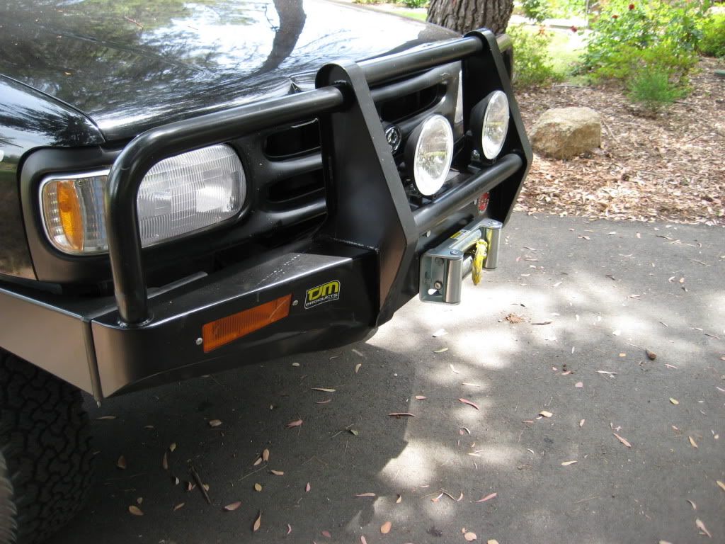

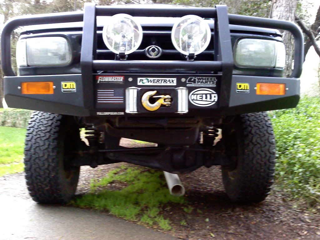

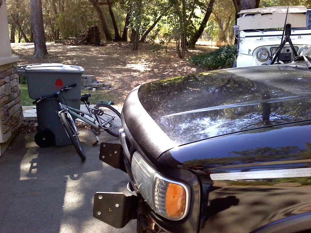

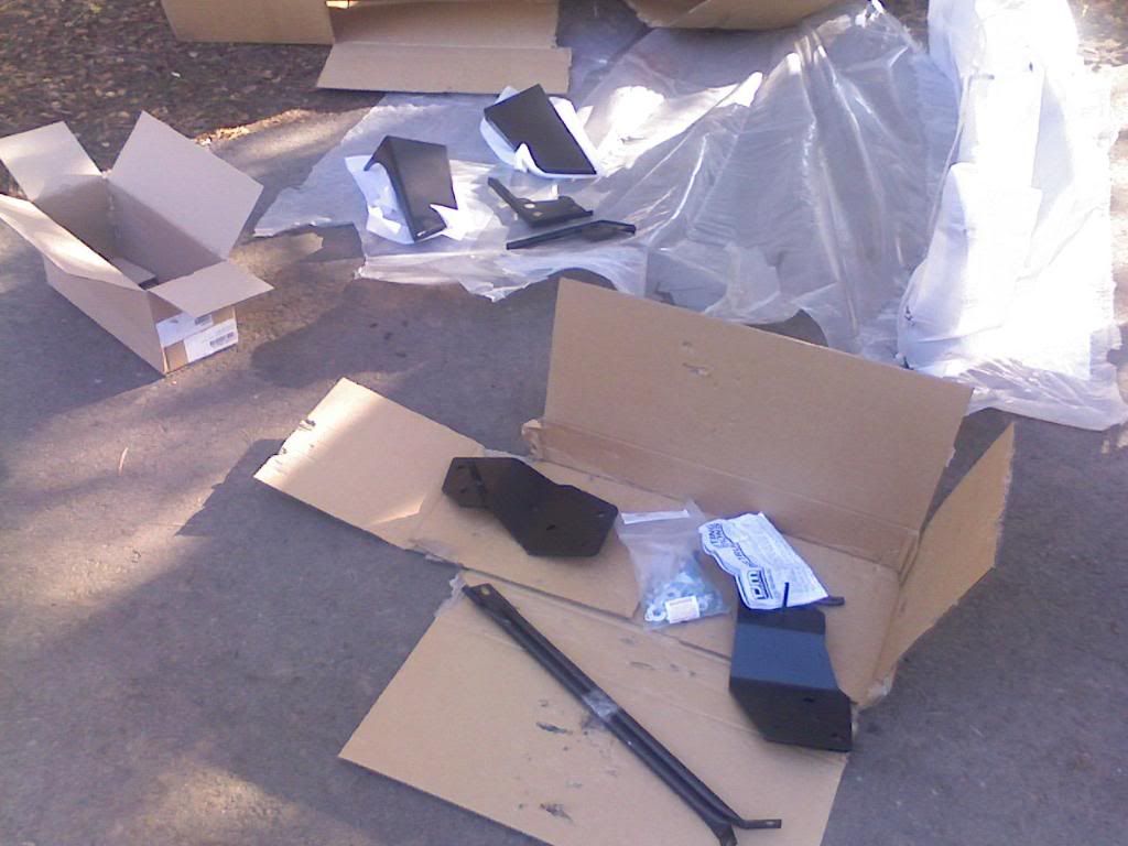

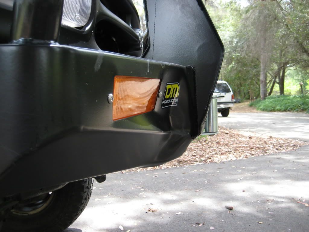

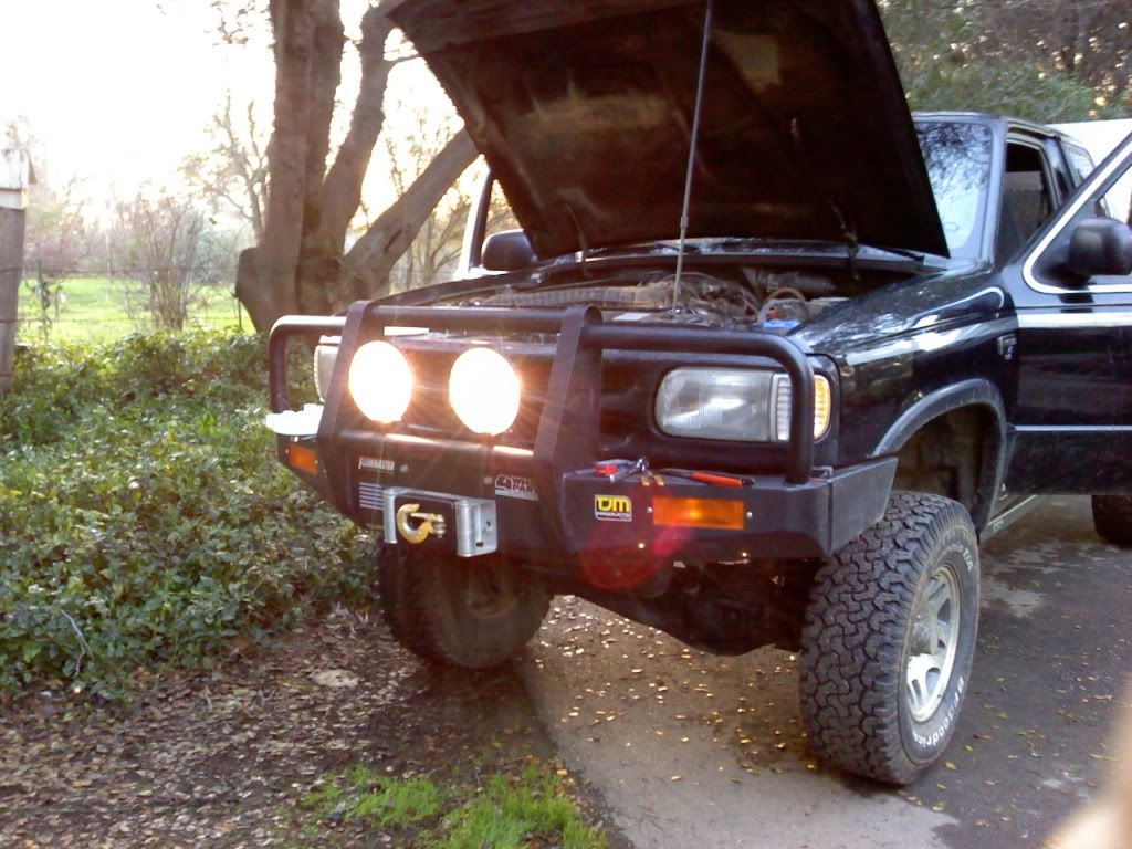

Bought a TJM bumper:

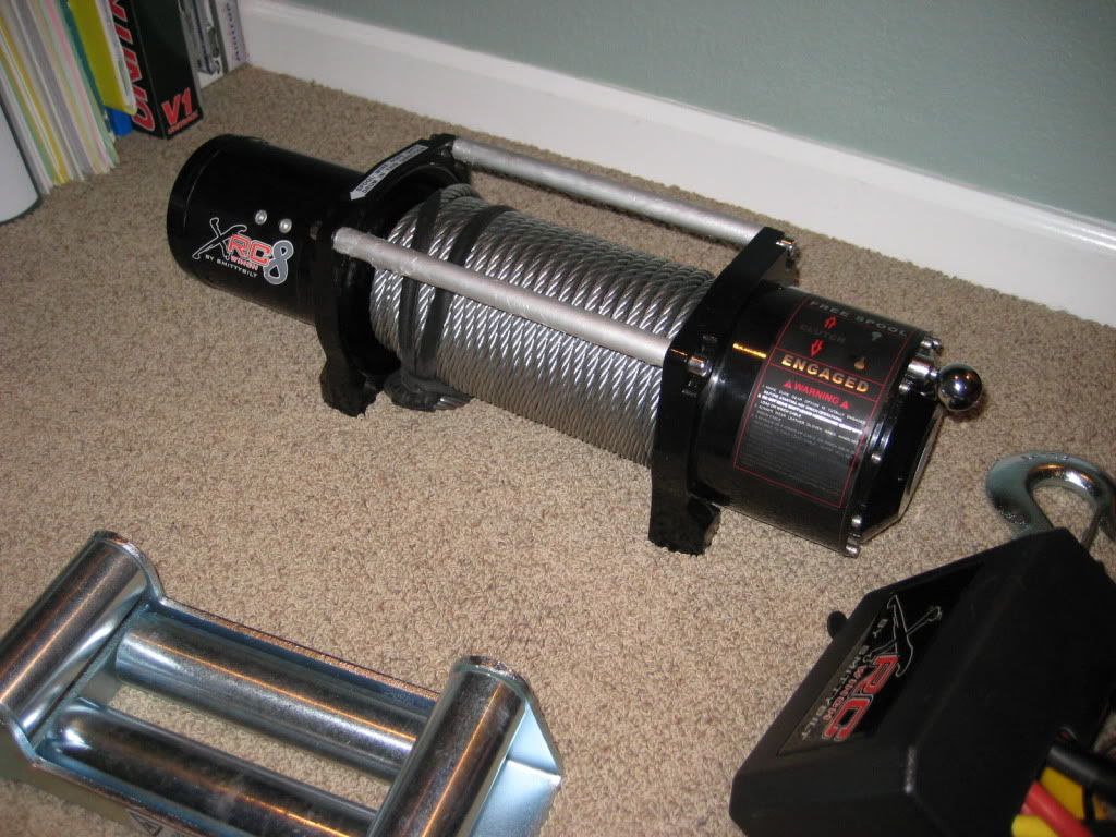

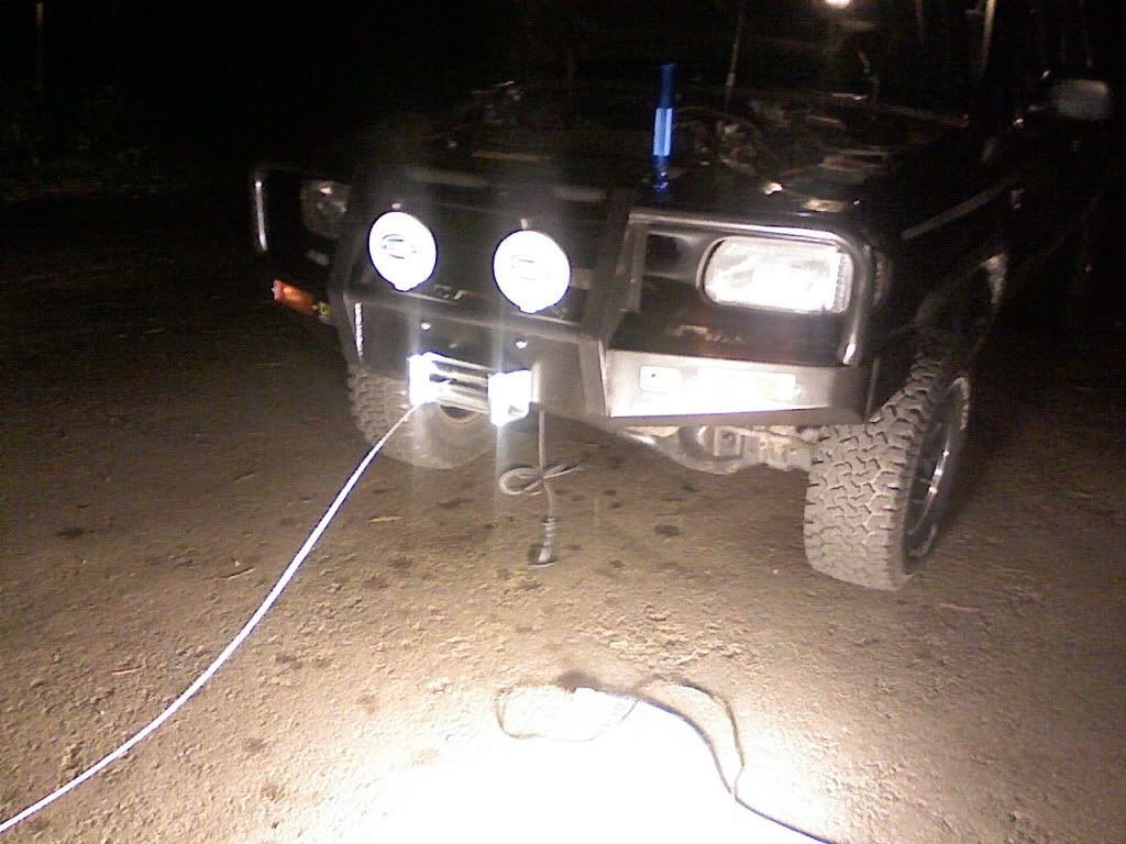

And soon after a smittybilt 8k winch (and ran the plug in into the cab; bought a optima blue top and ran 1ga wire with the solenoids under the hood):

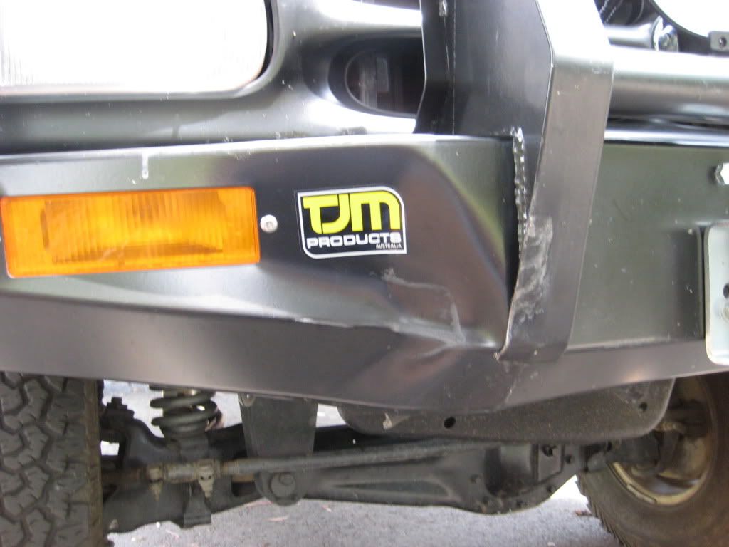

Got in a fender bender, bumper saved my radiator, fan etc im sure, both of us walked away fine:
Had it fixed and painted for $300, not bad actually:

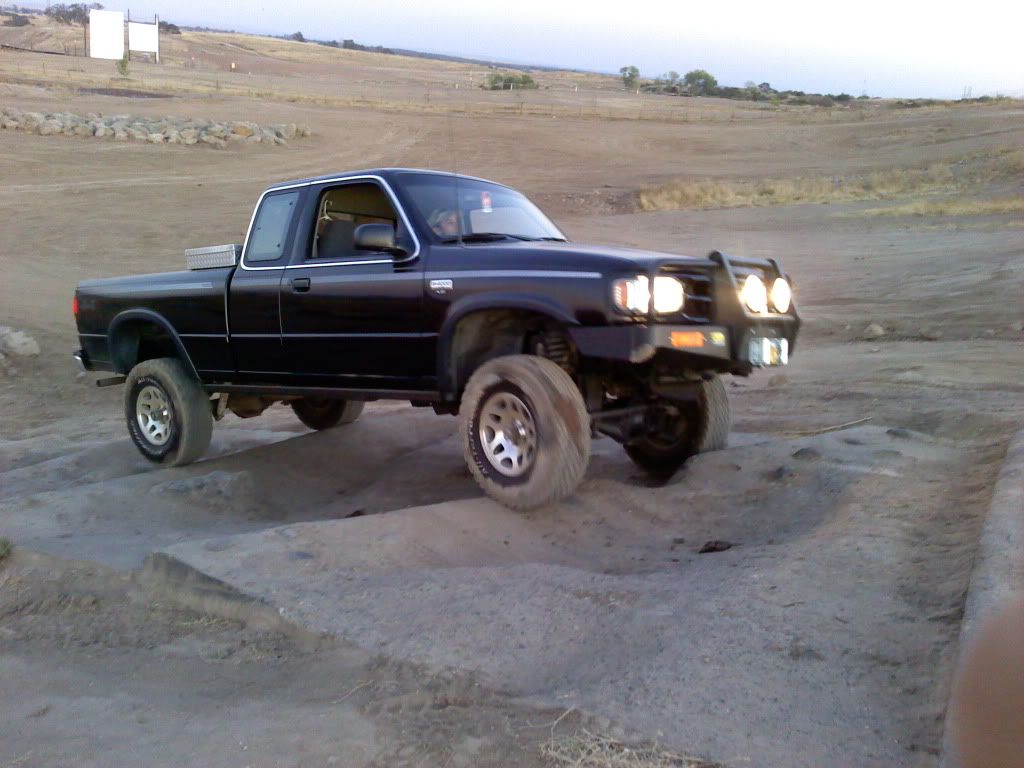

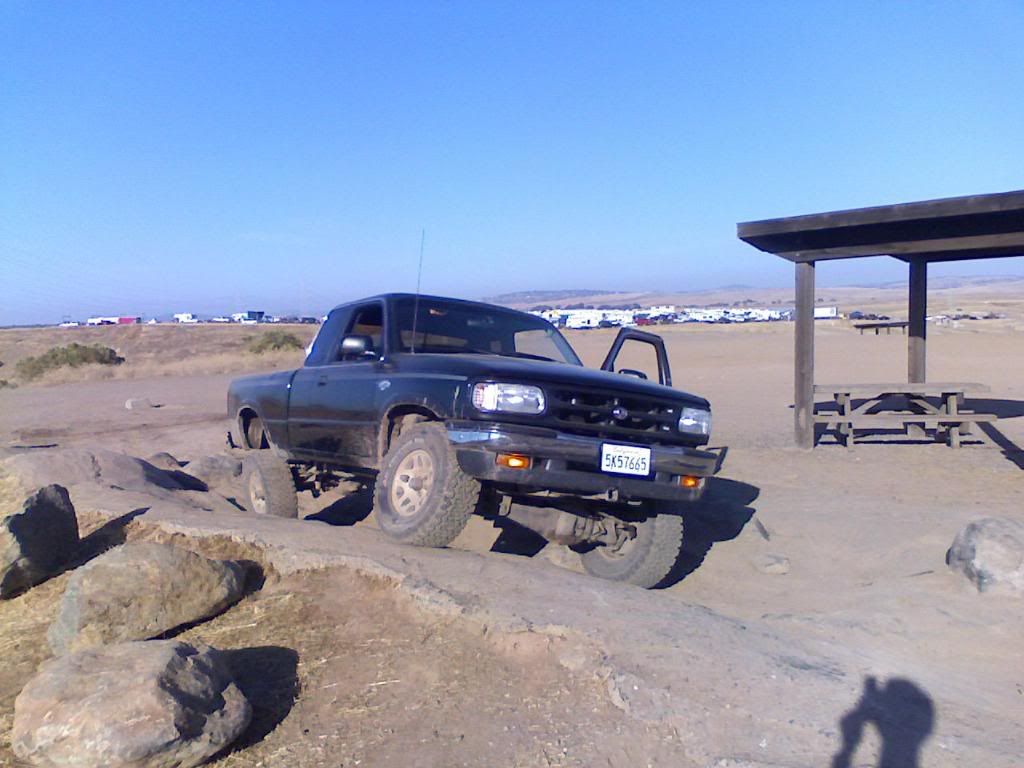

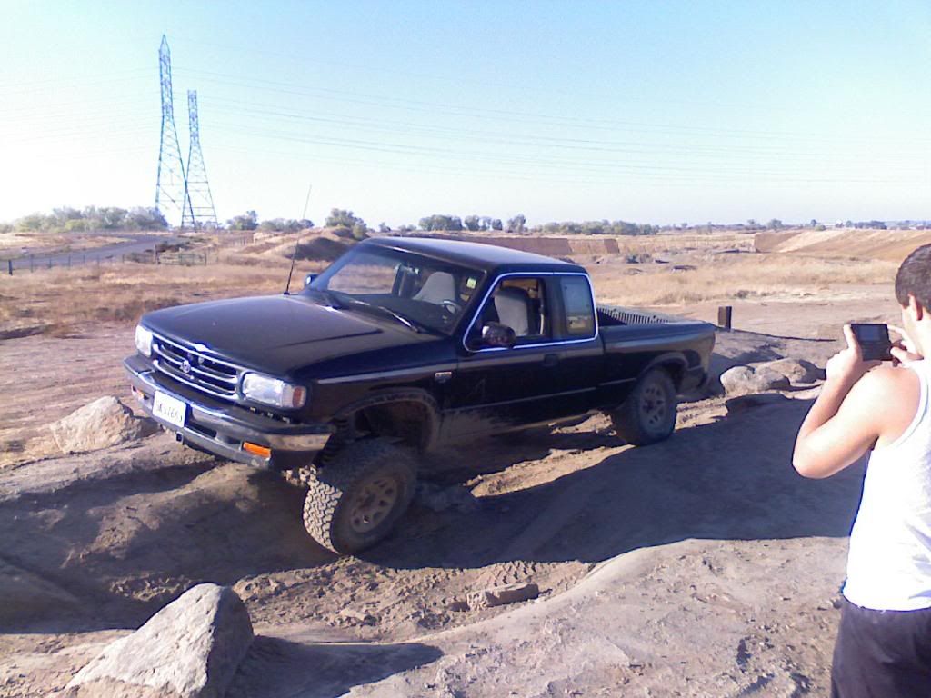

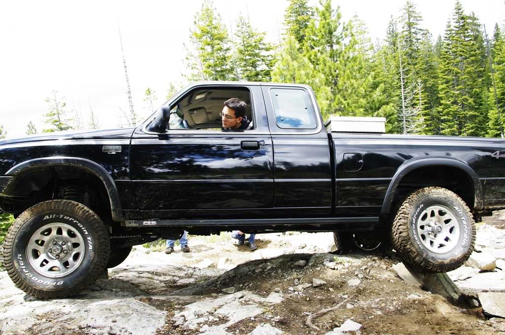

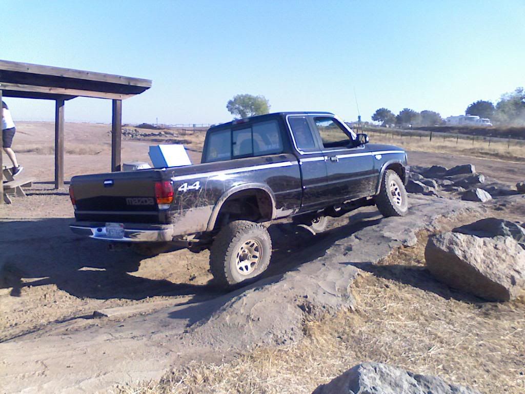

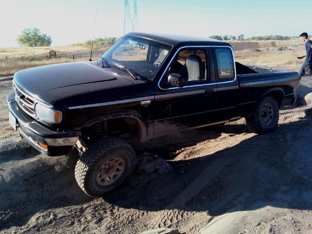

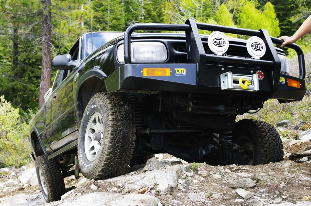

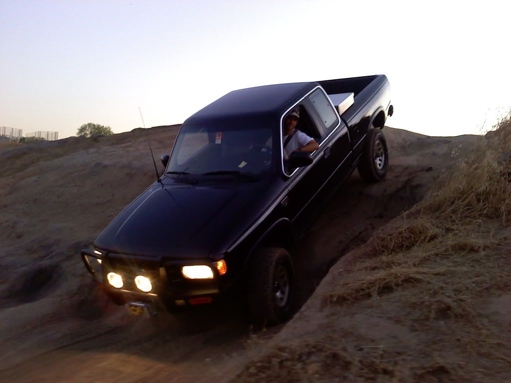

Went wheelin':

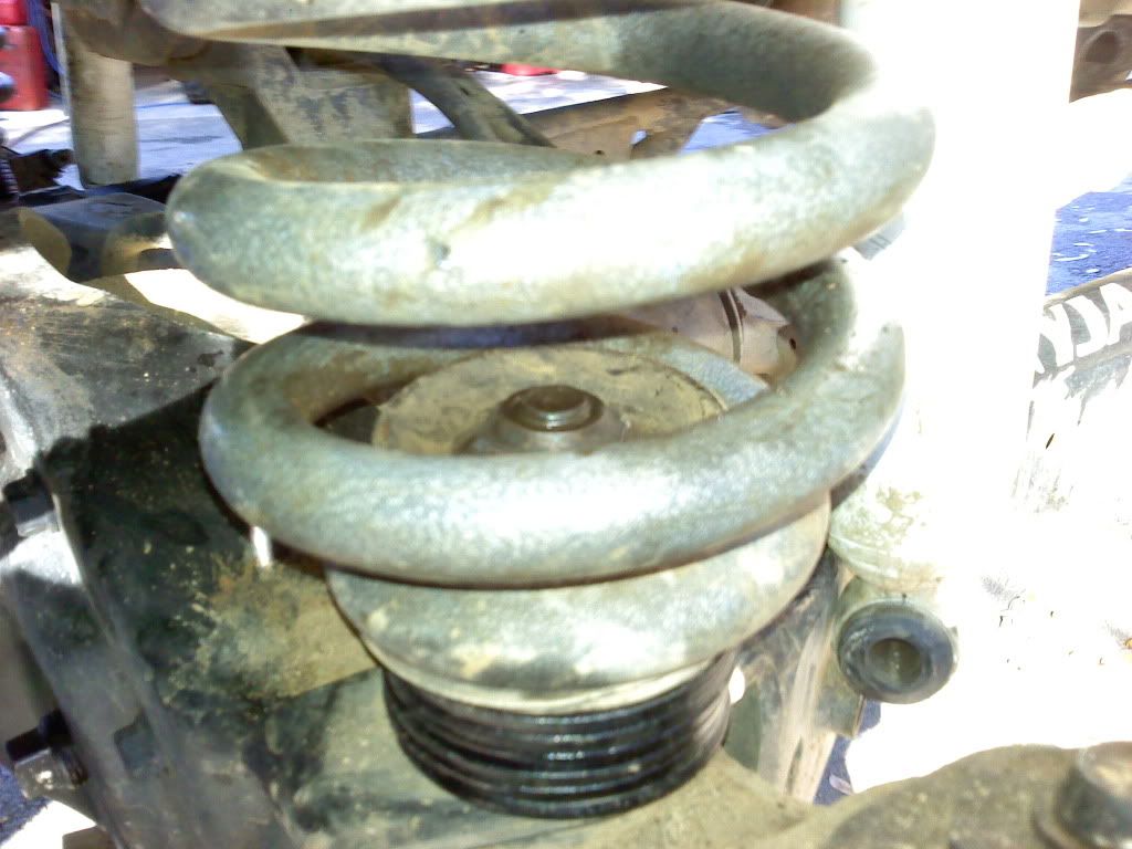

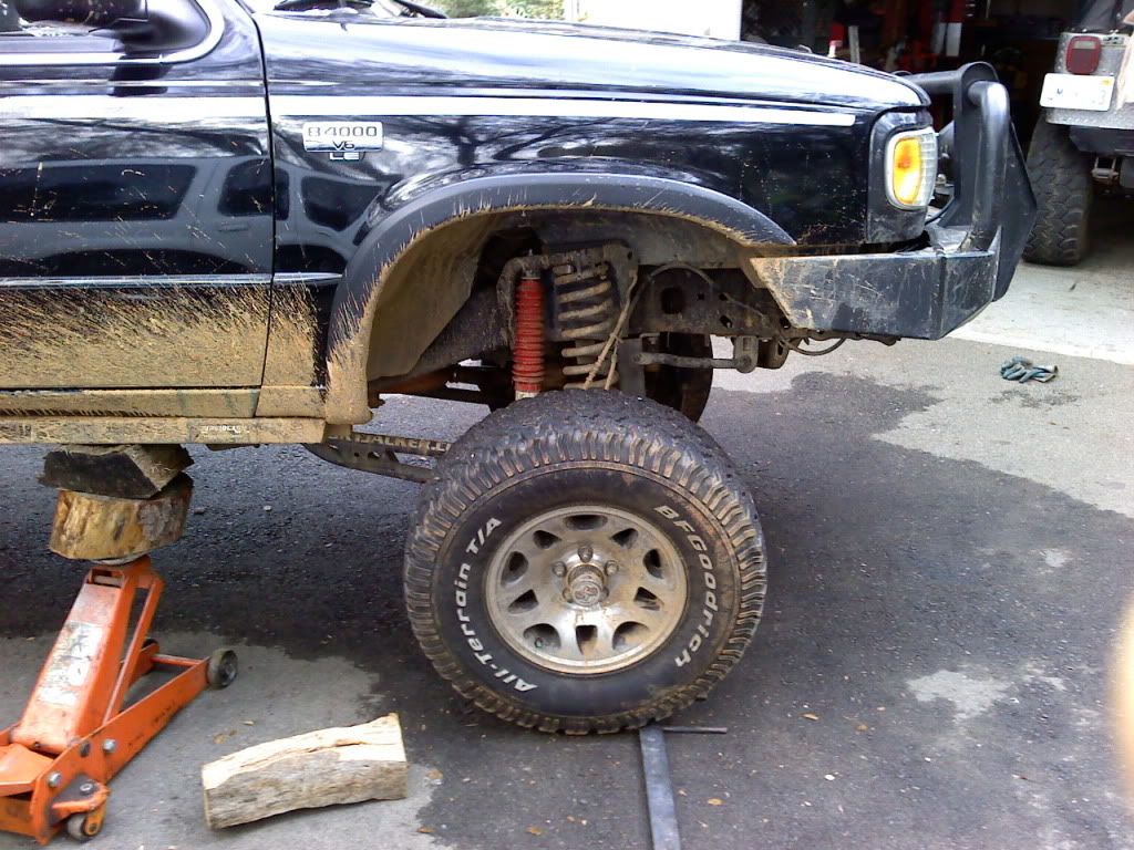

For awhile I didnt do anything, but the next phase includes 6" lift shocks, steel washers, another 2" block, 8.8 No-slip and tool box (all last summer).
Got get a little mud on the tires:

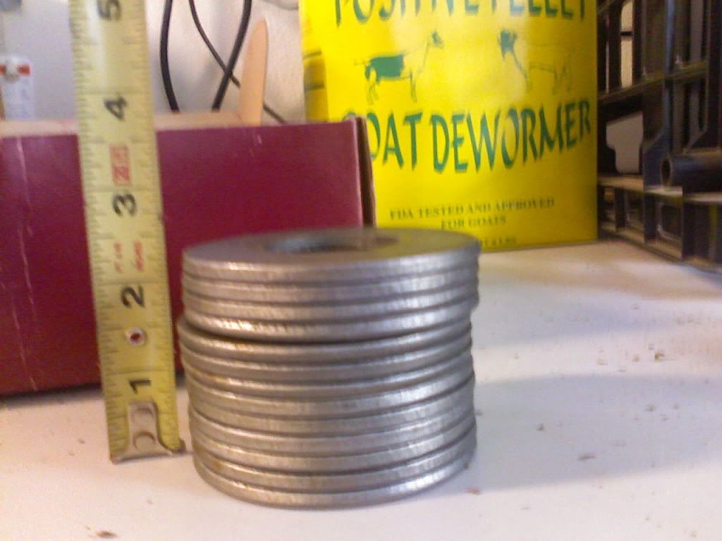

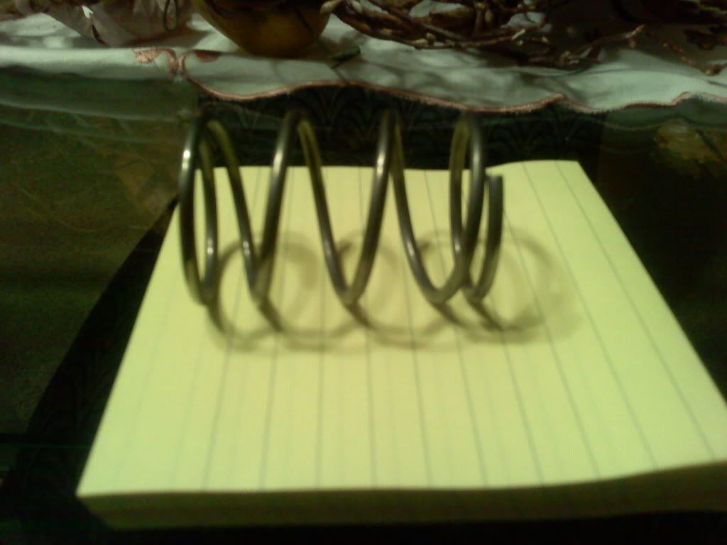

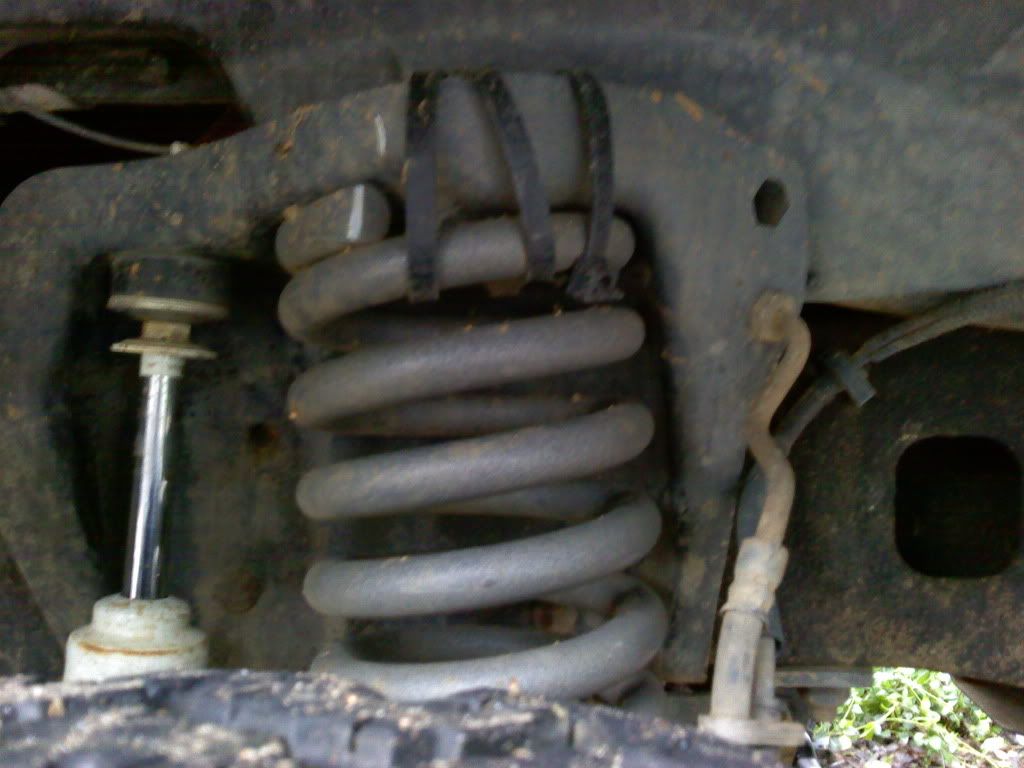

Coils spacers (washers):
Gave me another 1.75":

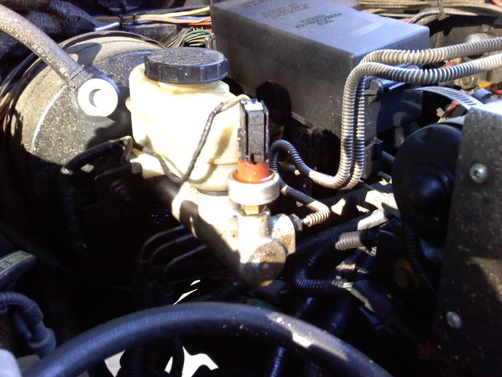

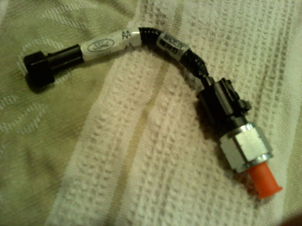

Cruise control brake module went out:

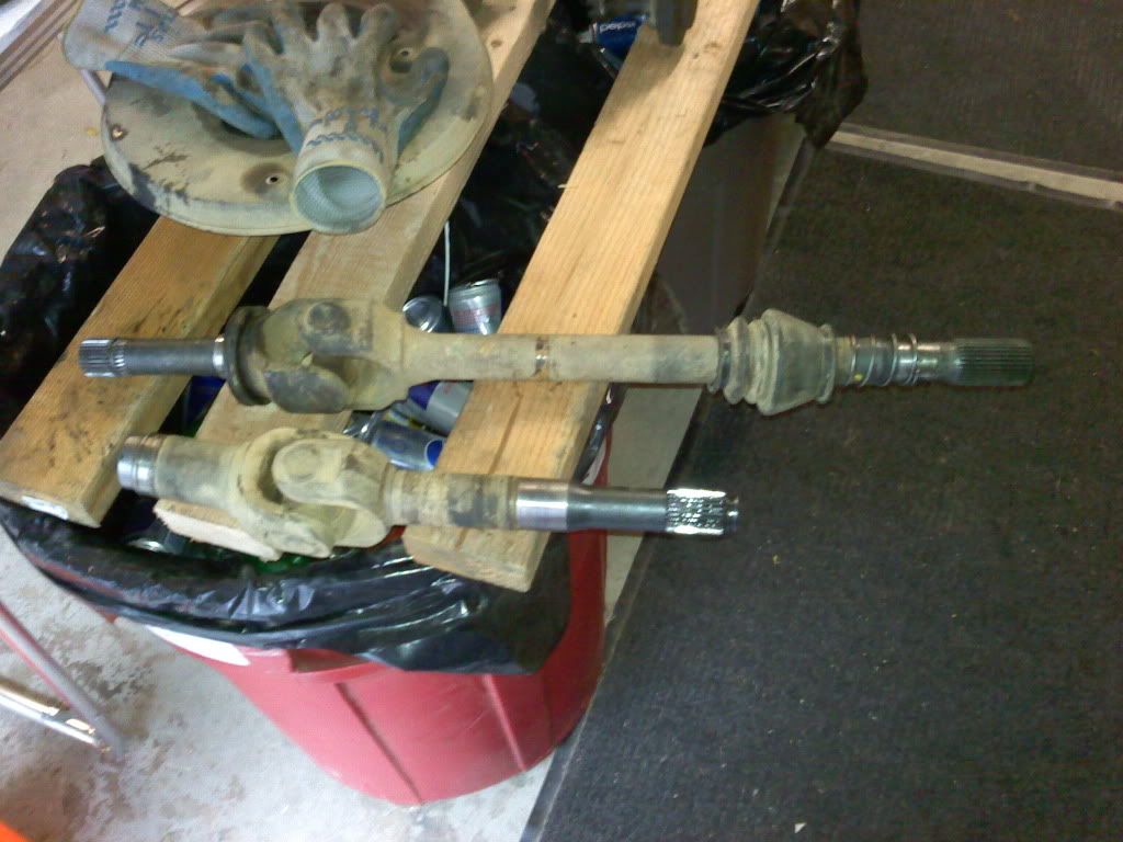

C-clip eliminator spring:

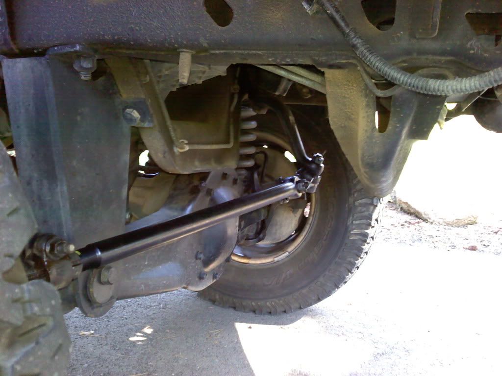

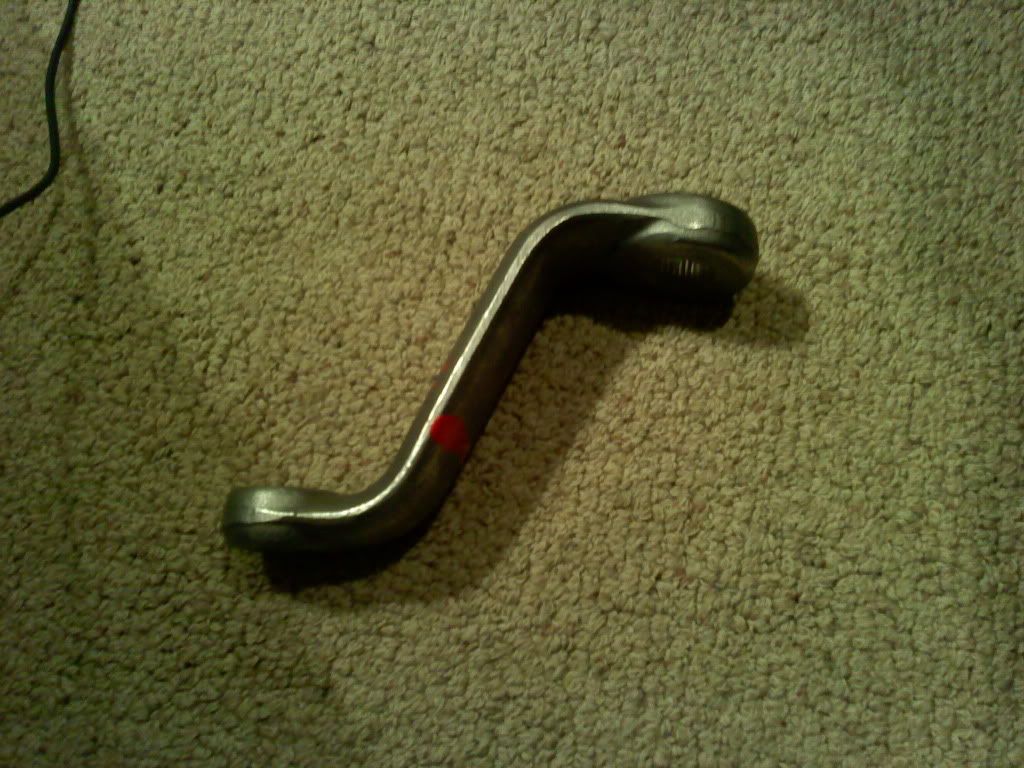

Extreme drop pitman arm (SJ fa600):

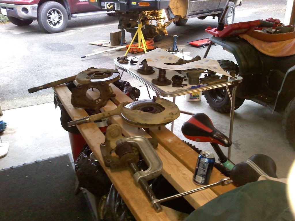

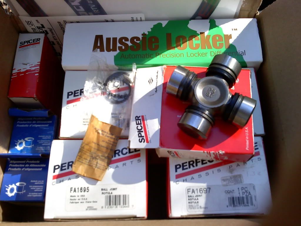

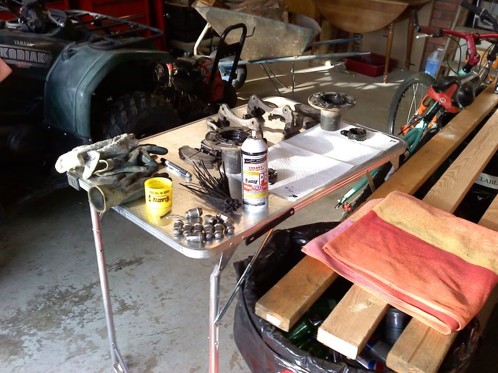

Box o goodies, front locker, spicers 5-760x's, new balljoints and eccentric alignment bushings:
New draglink (old one was shot):
Tie rod angles before FA600 pitman arm:

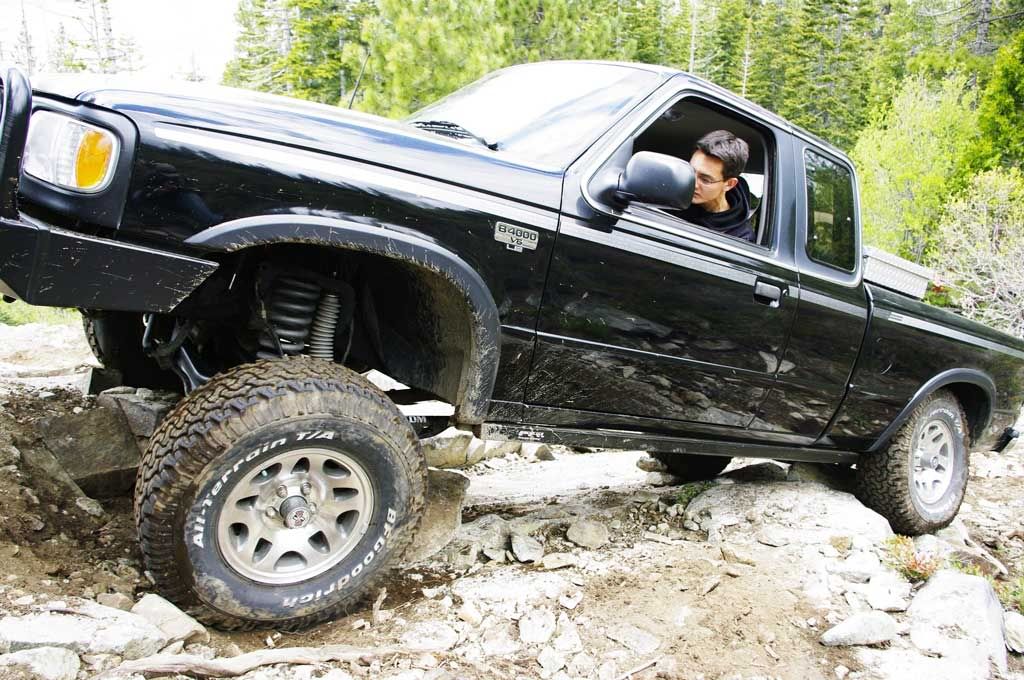

More wheeling:

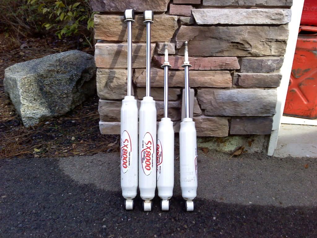

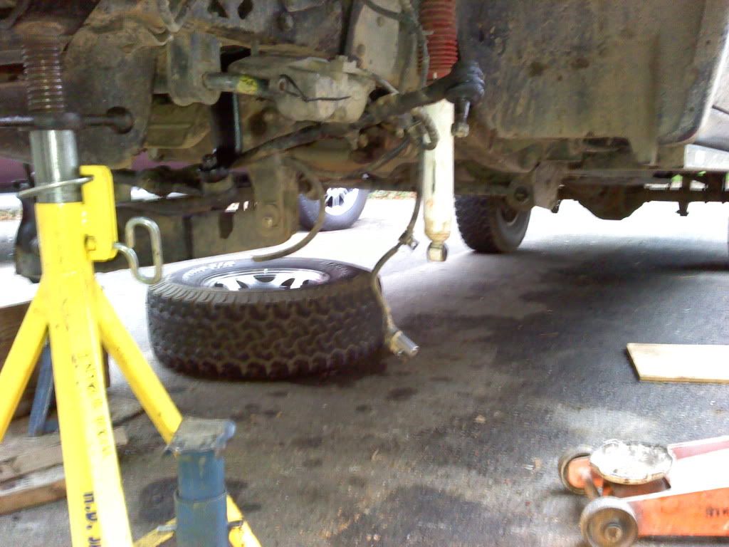

Got rid of these (went with 6" lift shocks from a rancho kit from the local you pull it for 50 bones:

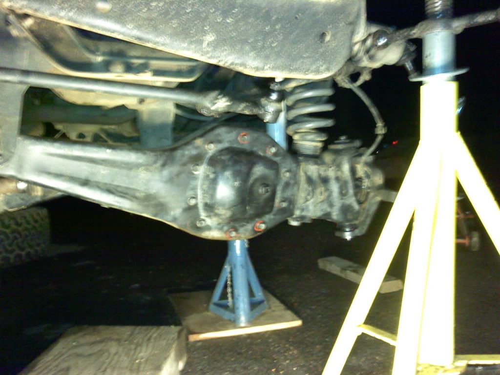

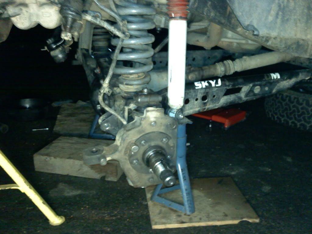

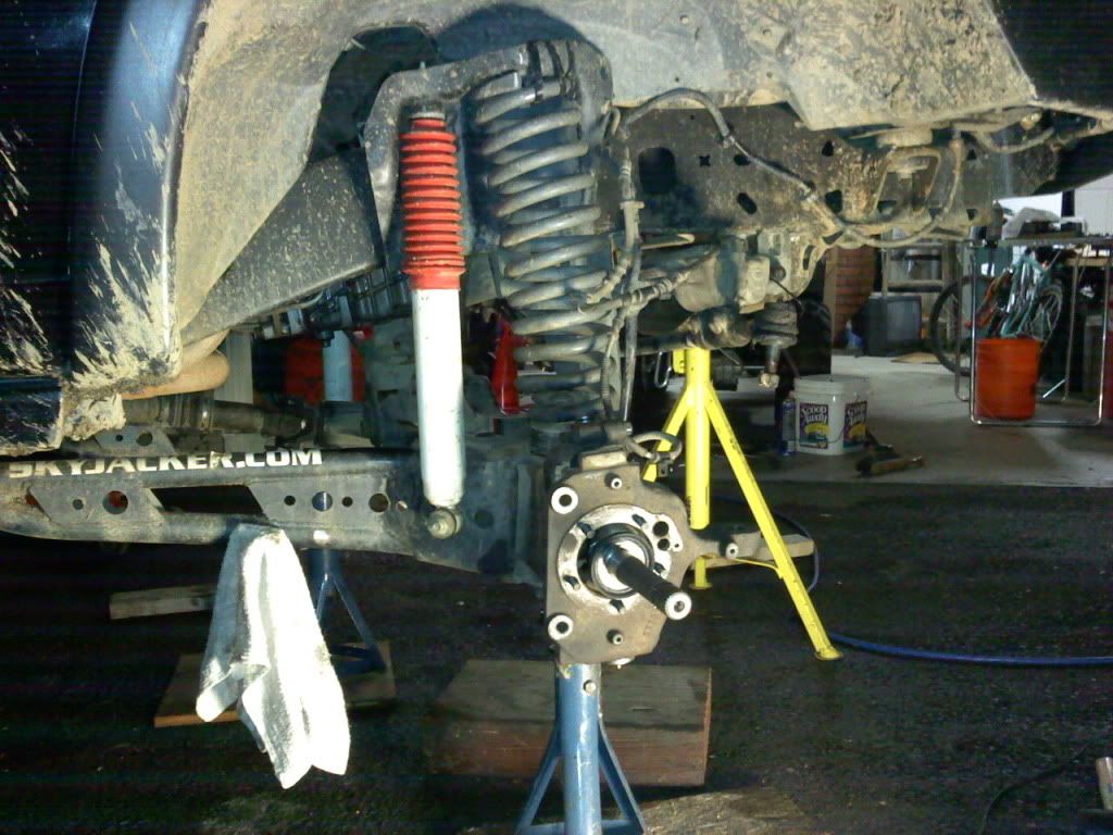

Then added the front locker, c-clip eliminator, spicer 5-760x ujoints, and 4x new balljoints as wells as the SJ FA600 (long weekend):

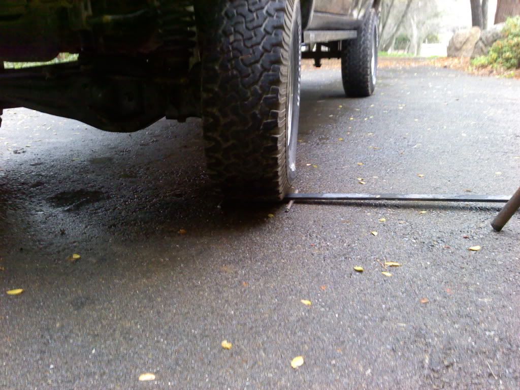

This is how I set the toe after all of the above so i could drive it to be aligned:

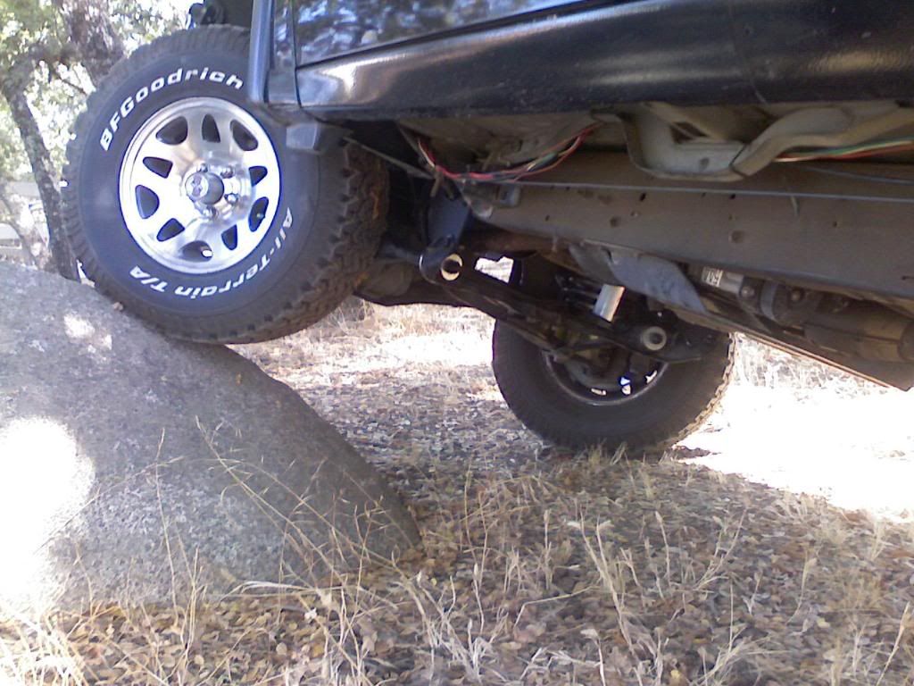

Flex! Sort of, I wish for more!

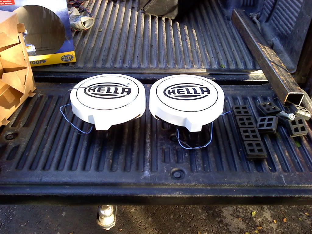

Added a pair of hella 700ffs with silverstar h3's:

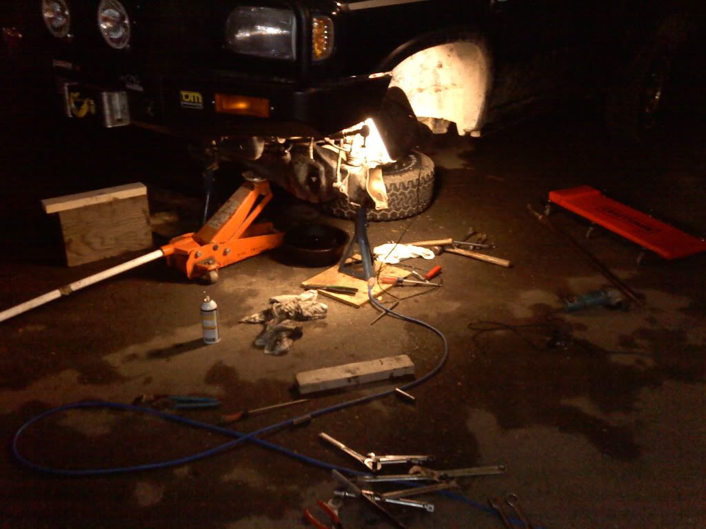

Just inspecting etc:

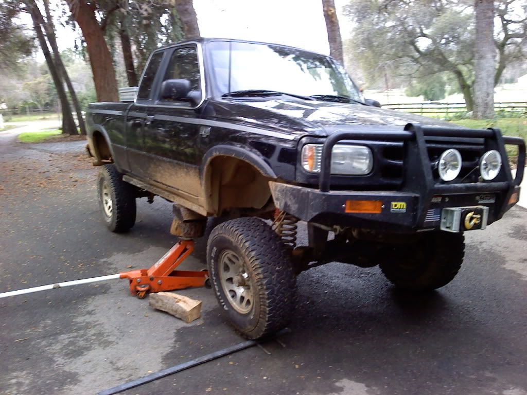

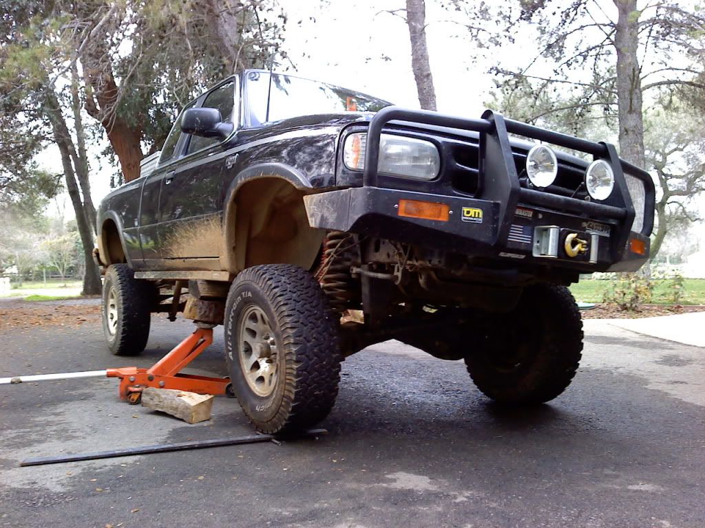

Fun with a jack:

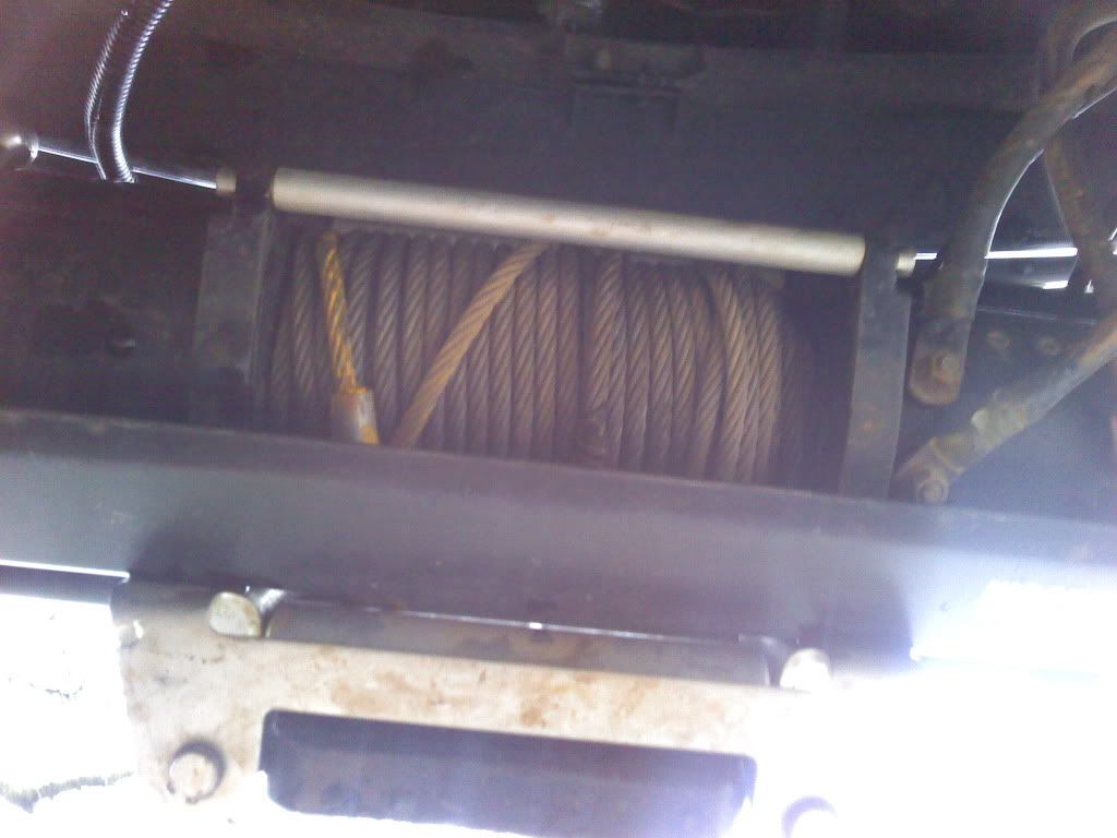

Winch behind bumper:

Redneck coil retainer:

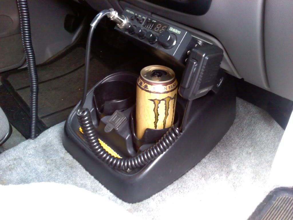

Winch plug-in, CB radio:

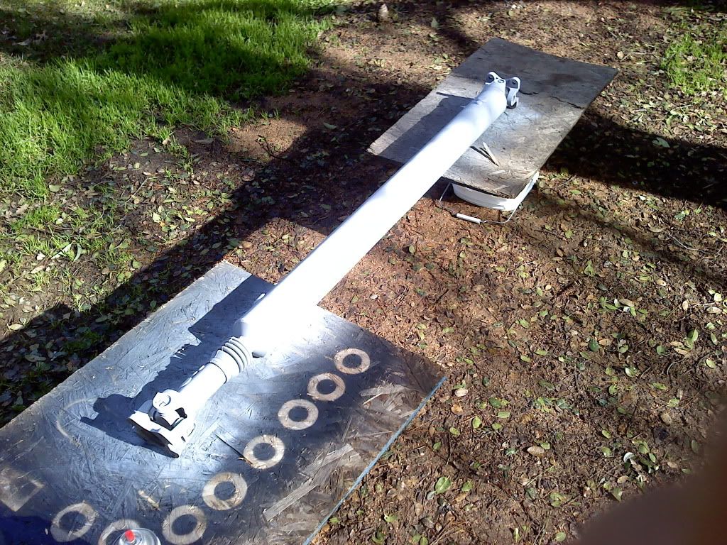

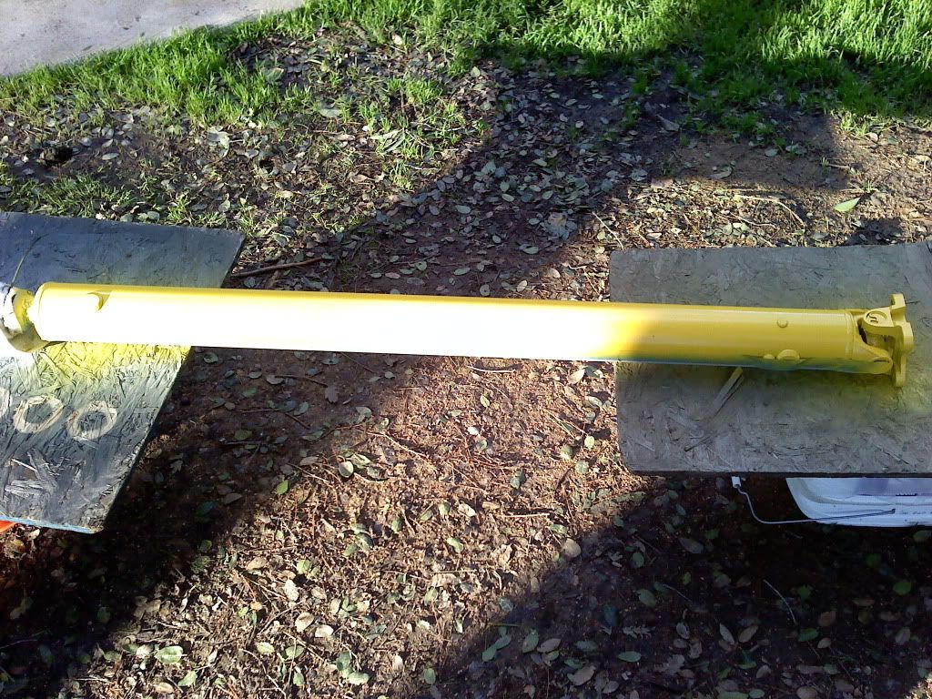

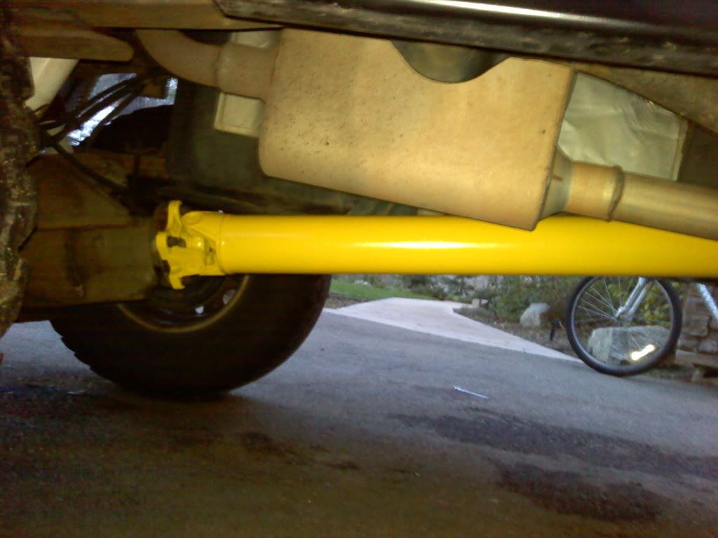

Painted driveline:

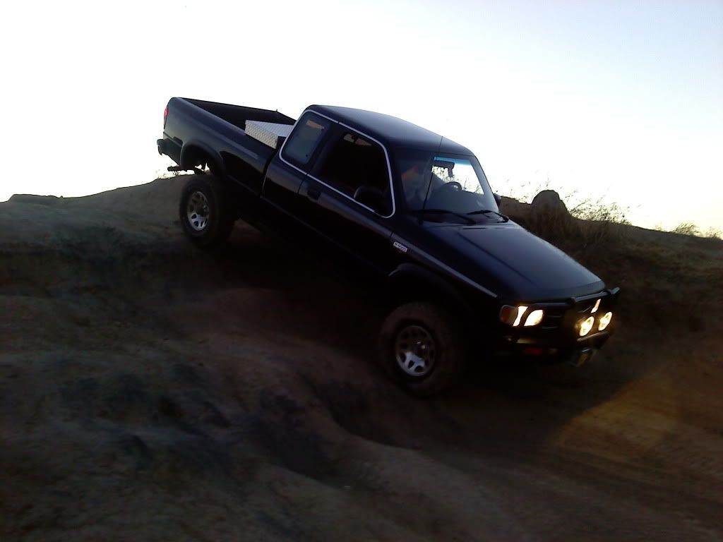

Lockers get you stuck. BFG AT's don't get you unstuck, Jeep V8's do:
SolidWorks 2009. Its a great program.
ummmm...that wasn't lockers that got ya stuck...that was a poor decision you made to try to go through a ditch that deep....
l8r, John
Well I had friends with me just for that reason, I could try things that weren't exactly the greatest decisions...
A *poor* decision like this was ok in my case, i had friends that tagged along....allowing me to try something a little out of my league. You kno, have some fun? Play a little?
