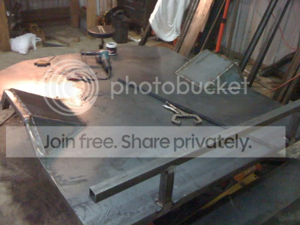

So since the bed I started with on my ranger was too nice ive decided to build a new one worthy of beating on trails, that also will be more use full then the one from ford.
some pics of the progress

Using 1.75 square 12 gauge wall

Let there be tin! 12 gauge otta be plenty strong

some sides
Jolly Greens Flatbed
yes i welded the whole seem

Still much finishing to do, rear bumper, finish lights and inside wire covers, last coat of paint then future add ons like a gull wing flat top and a canopy
