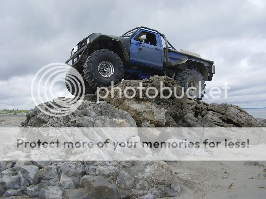

this one's been here before.

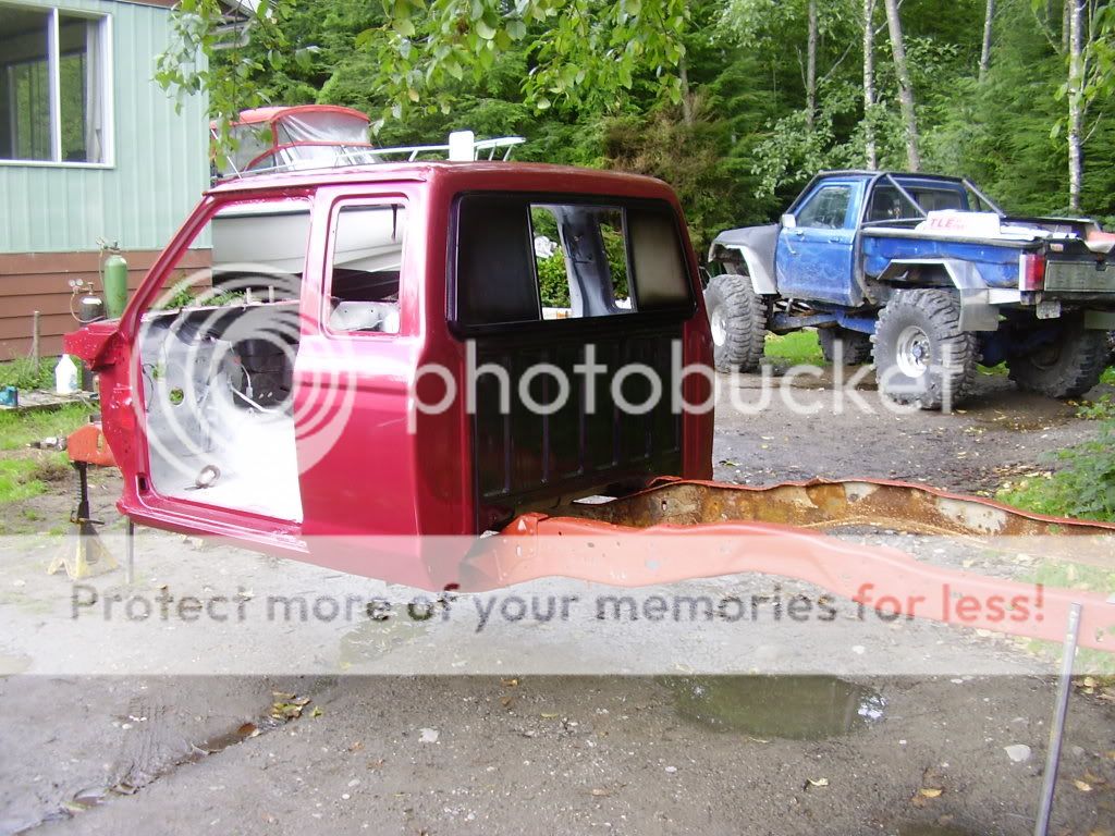

thks....it's actually about to go through a refit.10 years of abuse have taken a toll on the frame an
d cab

WOW, that truck is sexy, specs?? more pics?

specs,huh.engine is a 460,150 nitrous shot backed up by a c6-205 feeding into a pair of np435 4 speedsand a second 205.10.25 rear,d50 frontboth spooled.for the refit the c6 is being replaced with a zf 5 speed and the front will finally get it's d60.

Omg thats awesome !!!

thats insane!!! holy shit man. where are you from? that is deffinetly the best looking ranger i ever seen before
camodown
403
damn that first pic I had to take a second look at and make sure it was a real truck and not a close up of a RC crawler haha
that thing is a beast

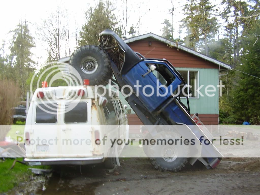

That's not a shadow is it?

stepside he means

oh!:icon_twisted:no,no.......just a regular box with the outer panels hacked off and alum fenders fabbed up to keep the cops happy.:icon_thumby:
