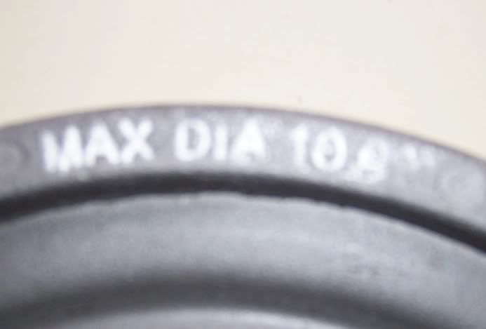

Ok, so I already know that I need new brake shoes in the back of my truck. What I don't know is, what size I have, be it 9" or 10". I know I could just pull the wheel off and look, but I figured my boys here on TRS could help me out. :headbang:
Well even going by the info under your aviator, could be either. Brake size on the later trucks was based on gross weight, not motor and such. Best just jack it up, pull a wheel unless you want to risk two trips to the store.
The size is cast into the rim.

yep, its the 10". i'm assuming because it's the supercab. I'm gonna pick em up today and hopefully have them on soon :icon_thumby:
