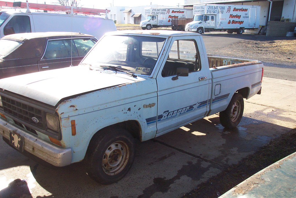

This is the starting point....
Picked up this for the running gear, needs an engine but it's got a 3.73 posi and is 99% rust free....

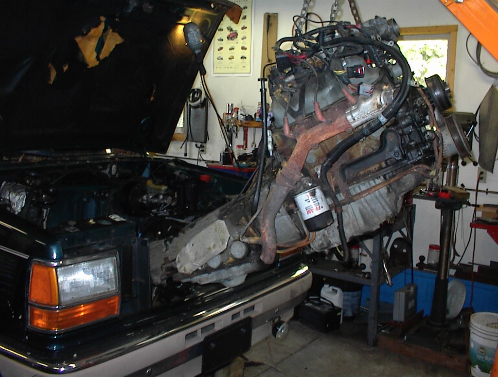

Final pic for now, a '94 Ex giving it's engine and trans for the project, far cheaper than fixing the engine from the '91....

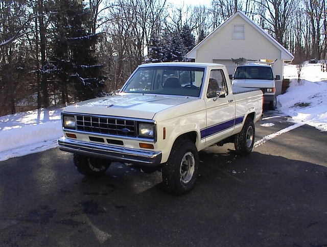

Been a while but this it pretty much what it looks like today...
