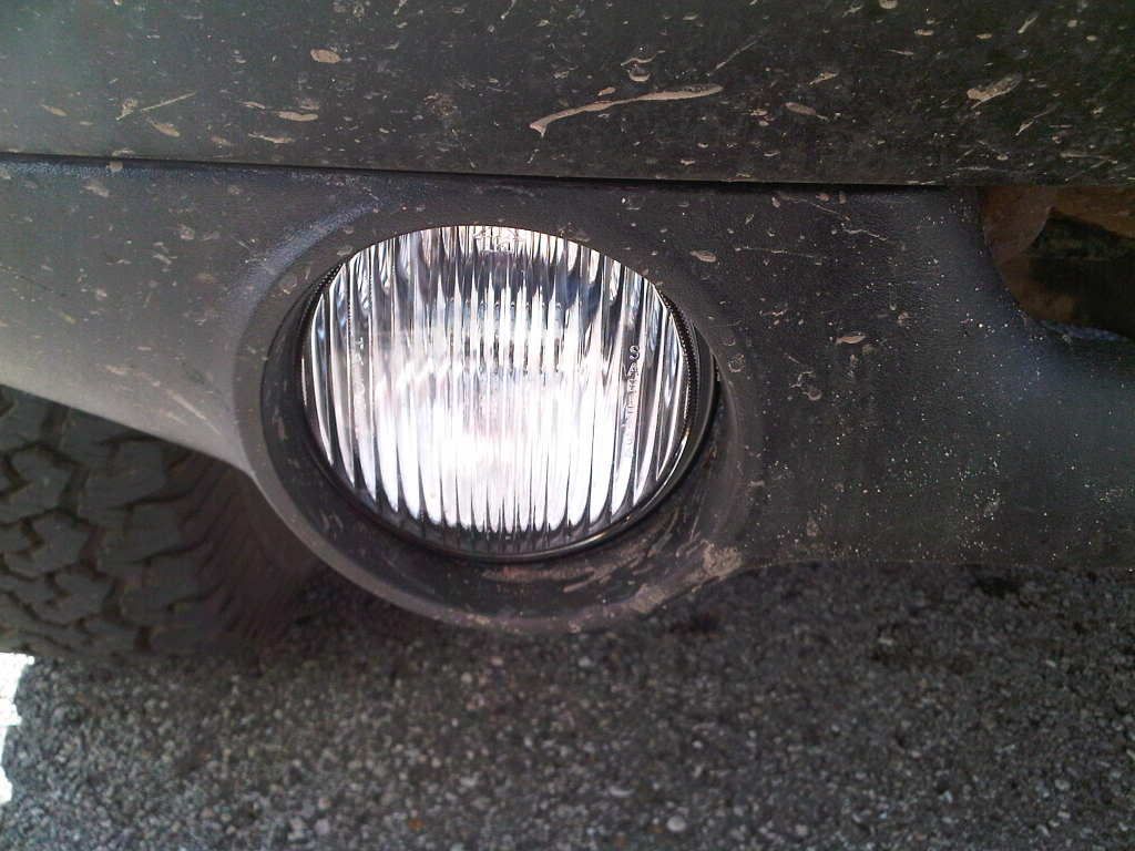

Just got done adjusting the passenger side light and they are both aimed properly now. Here are a few daytime pics:
As for filling the holes in the valence, the size is perfect, you just can't get any better than that.

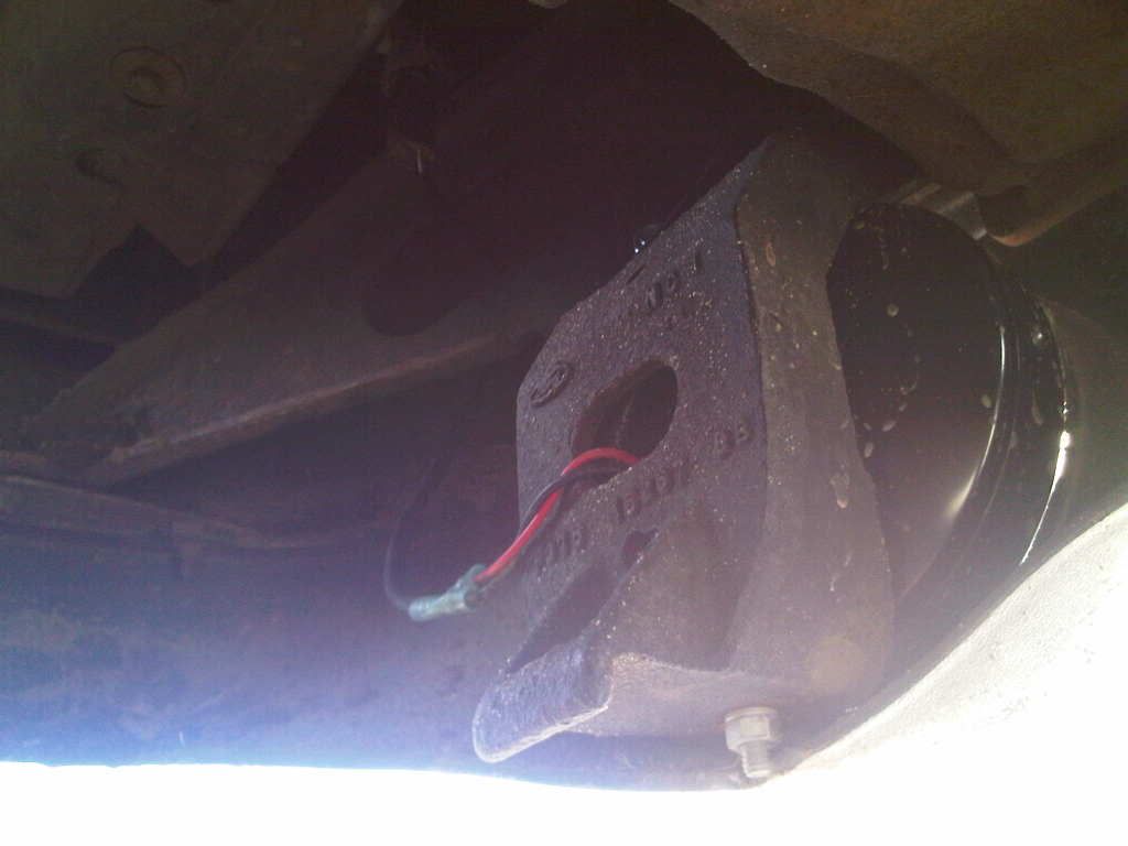

I really only had to drill a hole in the bottom of these factory brackets, the rest of the modifications I had to make were to the bracket on the fog lights themselves. I had to re-drill the mounting holes about 1/2" higher up. Unfortunately no pics of that, I didnt think to do a how-to. Wired them using stock pigtails to the factory wiring. I couldn't be happier! :headbang:

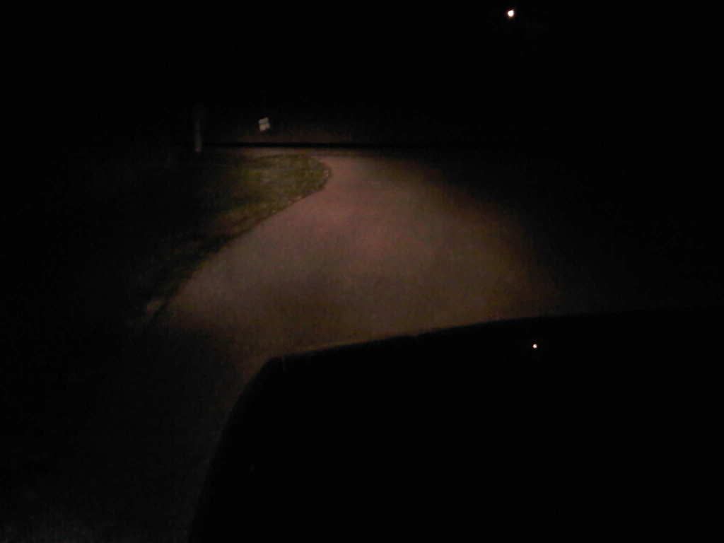

Night time pics.
Headlights only:
Headlights plus Pro Comp 55w fogs:
I still need to make a bit of an adjustment to the passenger side, it still looks a little off.
