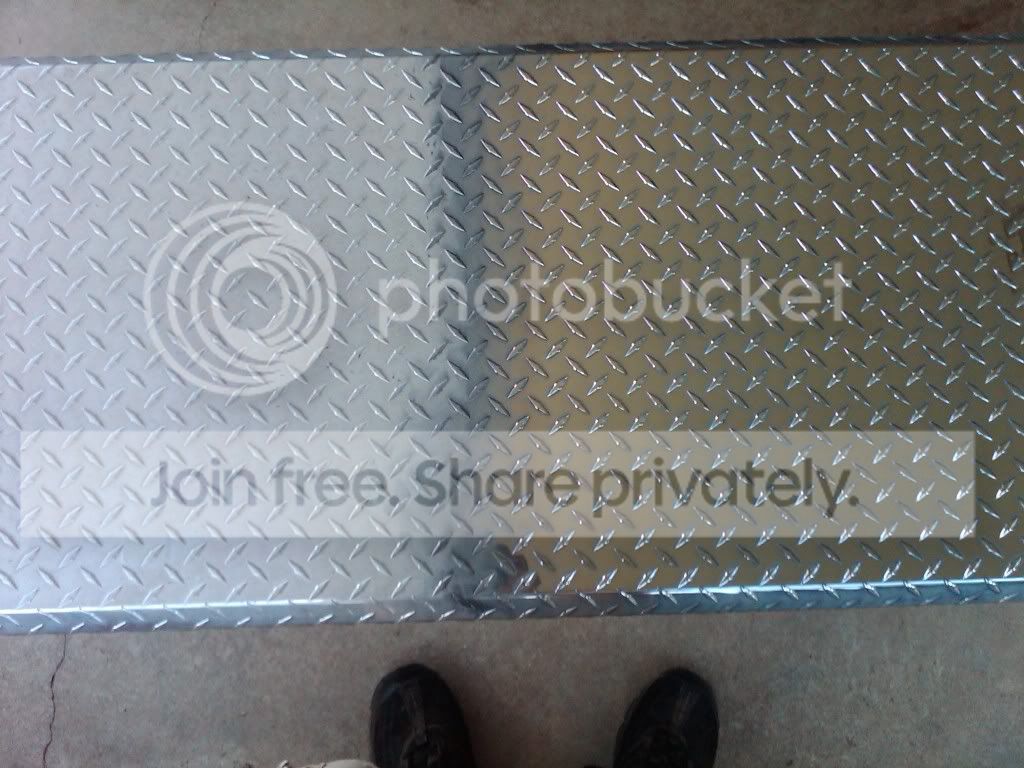

This is after a one pass over the surface and then wiping it down. You will want to polish until there is black residue all over the surface. Then wipe clean with microfiber towel to check for misses spots.
Here is after 3 passes and wipe downs. The more you polish, the shinier it gets
Ok, here I was about halfway done with the toolbox, its like a night and day difference:

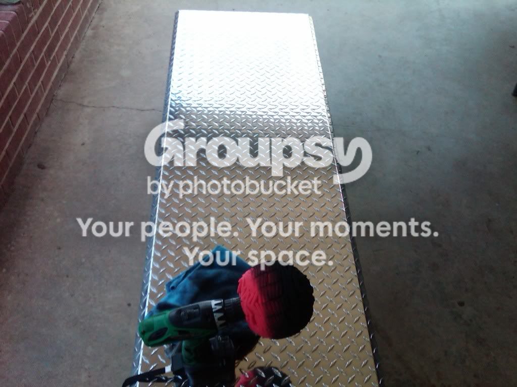

Here the top is done:
Just do the above procedures (Polish, wipe, polish wipe) to the whole toolbox until you are done. Once done, give the toolbox a good bath to get any missed residue off. Then mount on the truck again!
