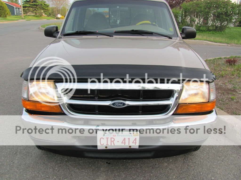

Alright, I think it's time so I'm launching a build thread. I wanted to call it Project Yard Ape... 'till I found out it was a racial slur...(thanks urban dictionary :icon_thumby:) So I'm settling. Anyways, this is what I purchased in February '10.

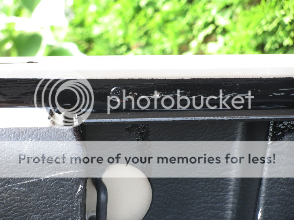

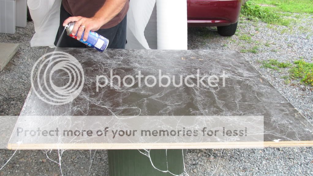

Then we took on a bigger project and decided to build our own hard tonneau cover. After doing an adequate amount of measuring and cutting, I attached the angle iron to the inside of the bed and painted it black.
Project Hooligan

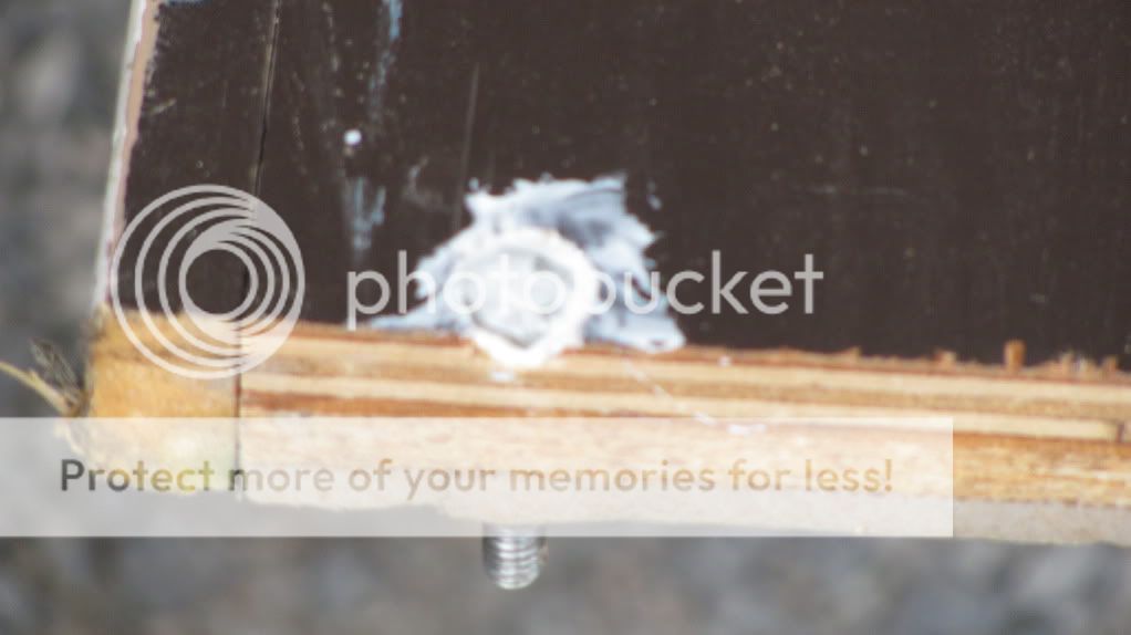

Then countersunk the bolt heads into the plywood and fastened them with epoxy.
Project Hooligan

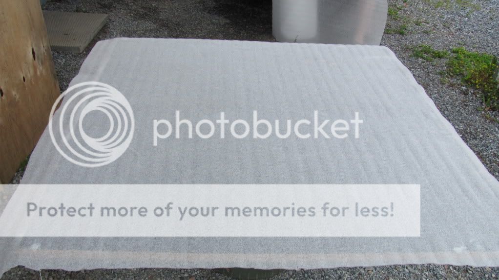

Then stuck flooring foam to it (note the Spidey action)
Project Hooligan
Project Hooligan

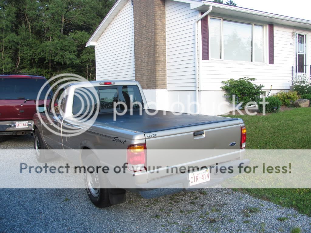

And wrapped the wood in vinyl, and bolted it to the angle iron.
Final Result...
Project Hooligan

on a serious note, i like the things uve done to that truck man, nice work. the bed cover is just awesome. :icon_thumby:
i really like that the bed cover is flush with the bed sides, makes it look so much cleaner than other covers.
