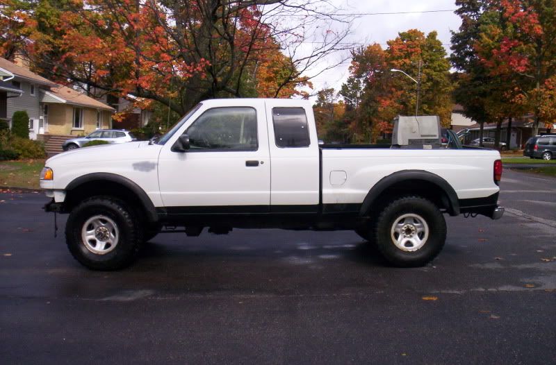

1998 Mazda B4000 4x4 paid 5440$ for it. since then i certified it, painted it, lifted it and got some tires for the time being! the truck had 163 000km and 4x4 was not in working order. Plans for this truck is to be a more reliable Daily Driver, Off road & tow rig. current upgrades are 3Link Panhard dana60 Front on FoA Coil Overs, 4Link Triangulated Sterling 10.25 on coils, 38.5"Tractor Tires . Future Upgrades are BW1350-54 Doubler, Winchs, random stuff.
Work Being done by www.nickel4x4.com Located in Capreol Ontario, Canada
